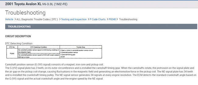

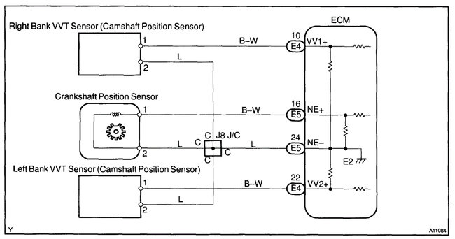

Camshaft position sensor circuit low bank 1 circuit 2? Changed the sensor and still getting the code. Can you help me? It keeps coming back every time I clear it out.
Mar 27, 2022 at 6:03 AM

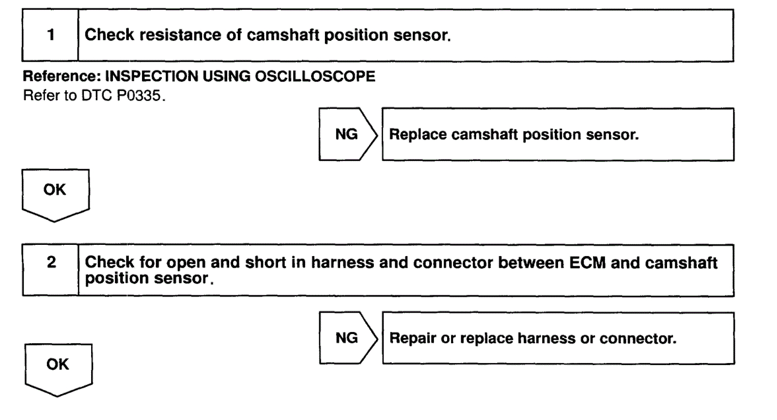

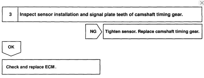

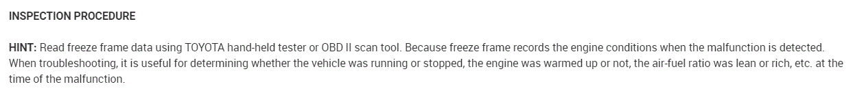

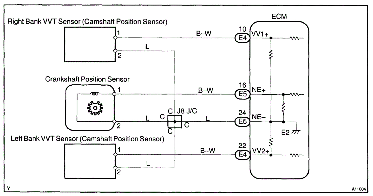

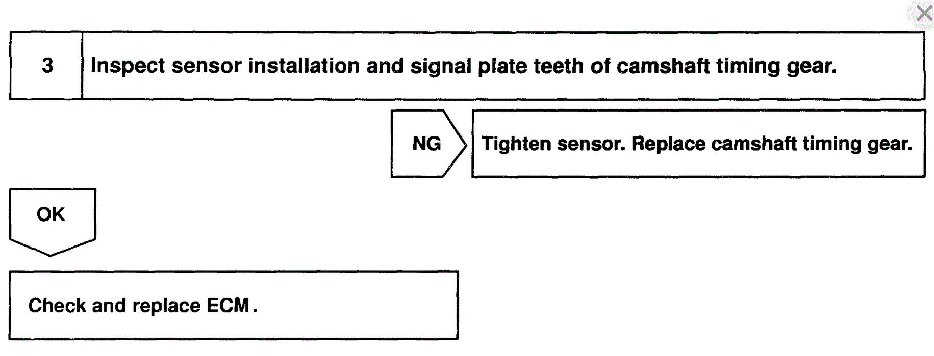

If the sensor is new, chances are we simply have a connection issue. First, check to make sure the connector is not corroded or damaged in any way. Also, check to make sure the connector pins are in good condition and not pushed in and the connector isn't slightly melted and allowing for a connection issue. If that checks good, we need to jump a little deeper into the diagnostics.
If you look below, I provided the diagnostics for the code. Take a look through them and let me know if you are comfortable performing them. Here is a link you may find helpful when testing and checking the wiring:
Let me know what you find or if there is anything I can do to help.
See pics below.
