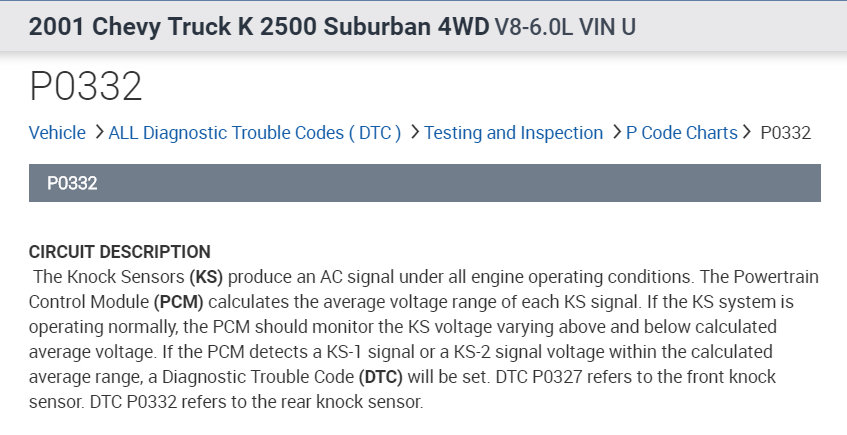

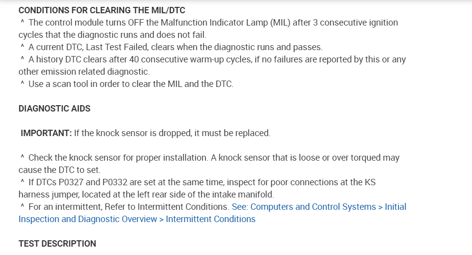

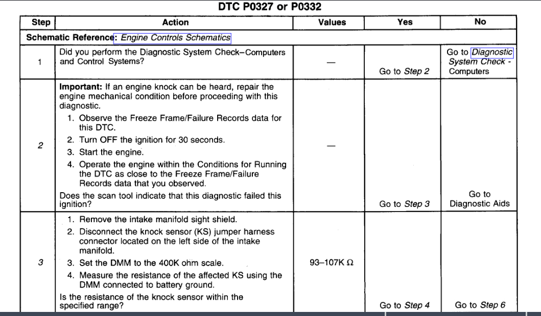

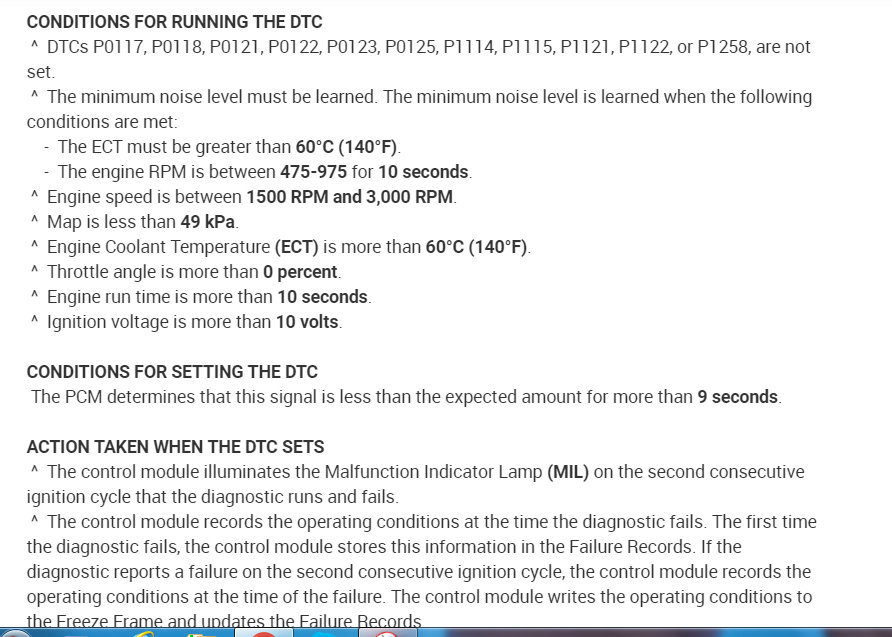

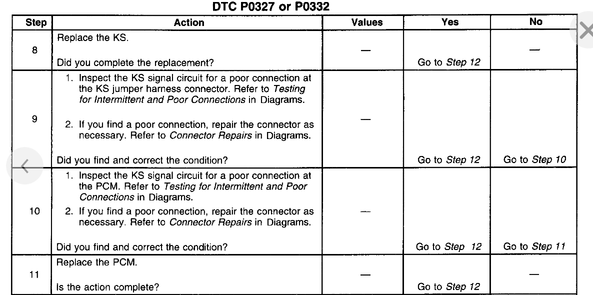

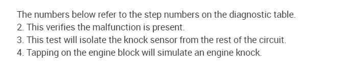

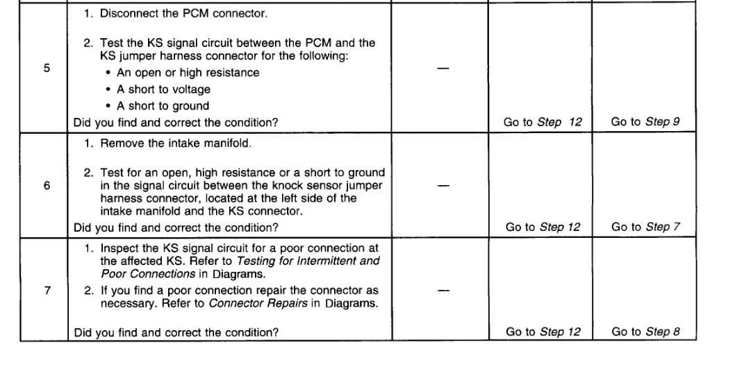

Yes, you are correct that this Direct Trouble Codes (DTC)(s) are for the front and rear Knock Sensors (KS)(s). In the diagrams down below I have included the Diagnostic Troubleshooting Flowcharts from Chevrolet on these DTC's. Please go through these flowcharts and you will definitively have the cause of your vehicle's problem. Please get back to us with what you are able to find out.

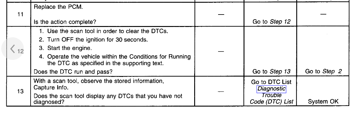

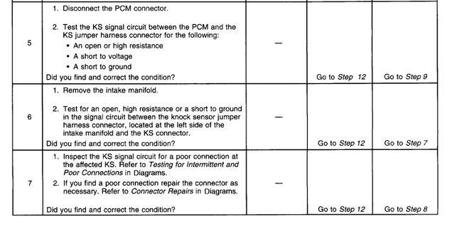

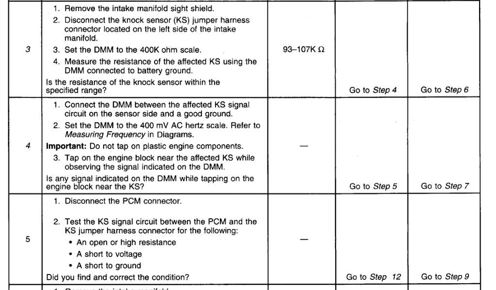

I followed the steps and got to #13 which says replace PCM. On step #4 I got over 20mV AC when tapping on the engine block for both sensors. Step #5 had little to no resistance (as well as no short to ground nor to voltage) between the harness connector for the knock sensors and the PCM plug (Blue #11 & #51) where they connect. I guess I'll get a replacement PCM.
