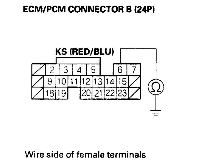

10. Check for continuity between ECM/PCM connector terminal B6 and body ground.
Is there continuity?
YES - Repair short in the wire between the ECM/PCM (B6) and the knock sensor, then go to step 17.
NO - Go to step 11.

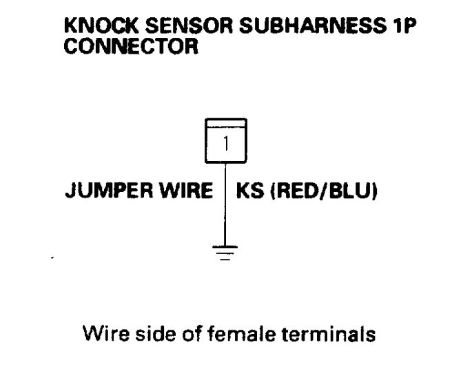

11. Connect the knock sensor knock sensor subharness 1P connector terminal to body ground with a jumper wire.

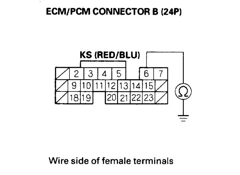

12. Check for continuity between ECM/PCM connector terminal B6 and body ground.
YES - Go to step 13.
NO - Repair open in the wire between the ECM/PCM (B6) and the knock sensor, then go to step 17.
