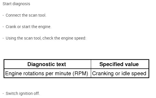

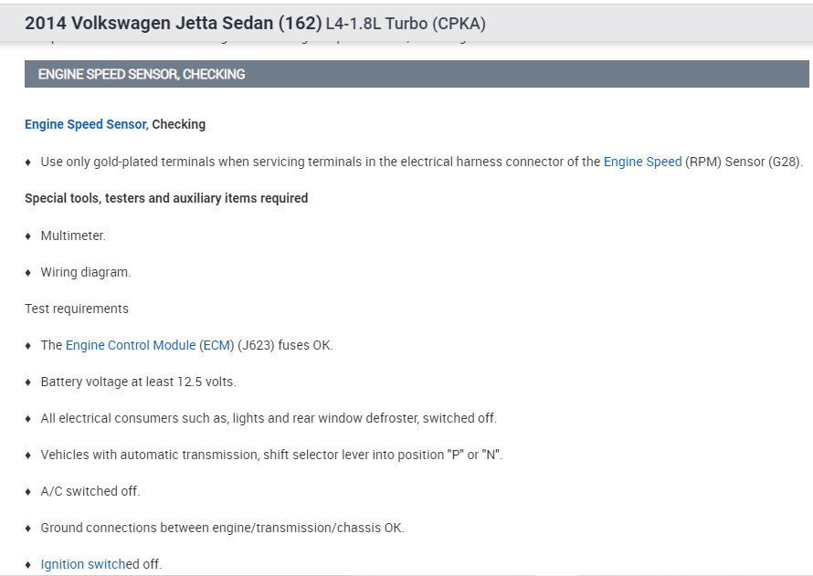

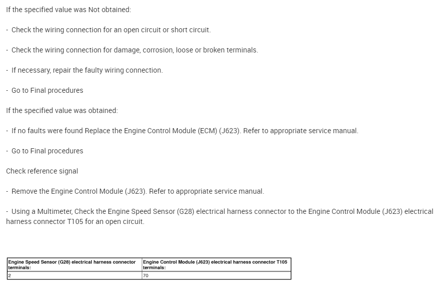

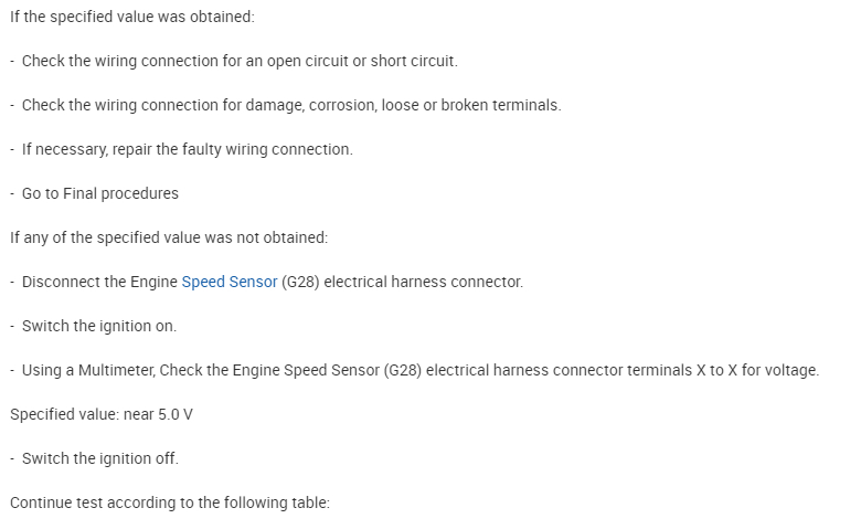

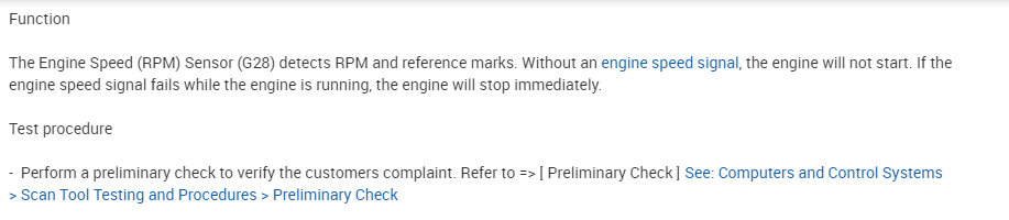

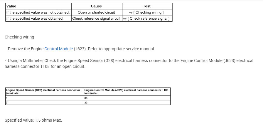

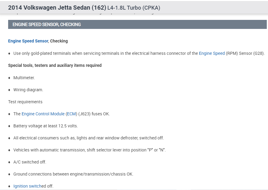

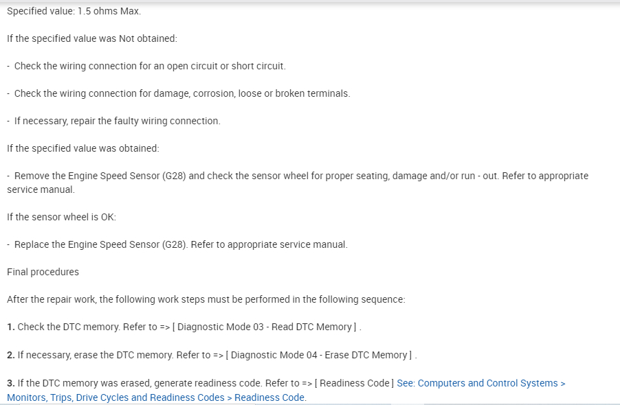

The code indicates there is no RPM signal from the engine speed sensor. Is the vehicle running? If so, what symptoms are you experiencing?
Since the code is specific, I attached diagnostics below for you. Take a look through them and let me know if you are comfortable performing them
See pics below.

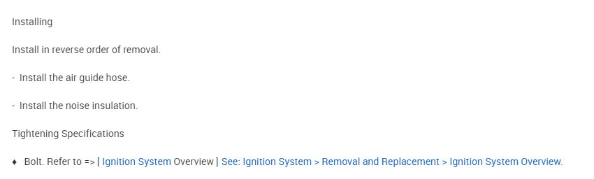

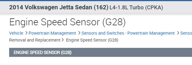

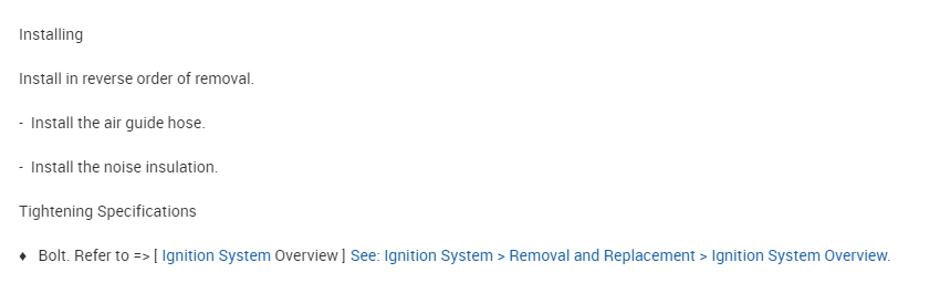

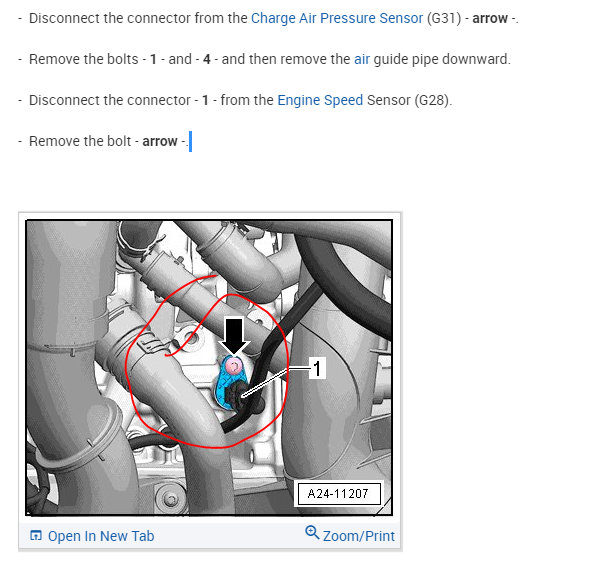

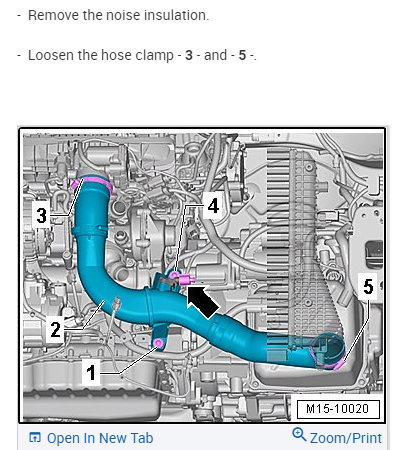

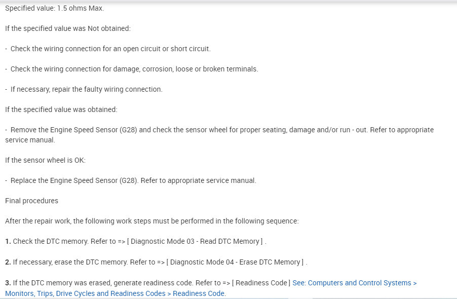

The sensor is located behind the charge air tube. You need to remove it to gain access.
If you look below, I attached the directions for replacing it. I'm not suggesting it needs to be replaced, but the directions to access it are included.
Let me know how things turn out for you.
See pics below.
