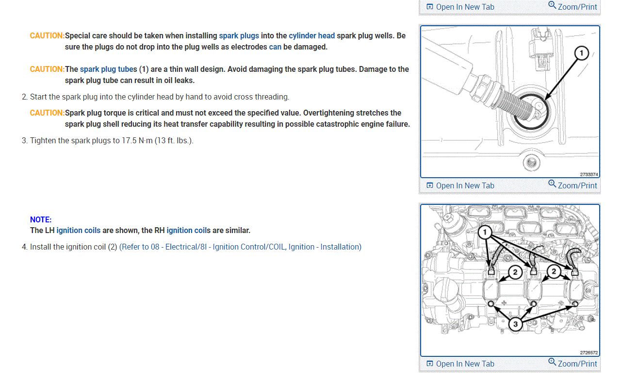

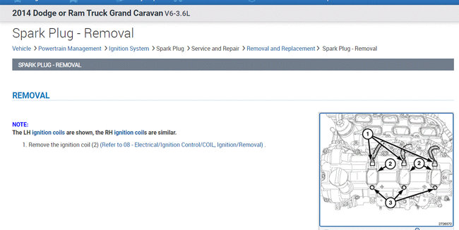

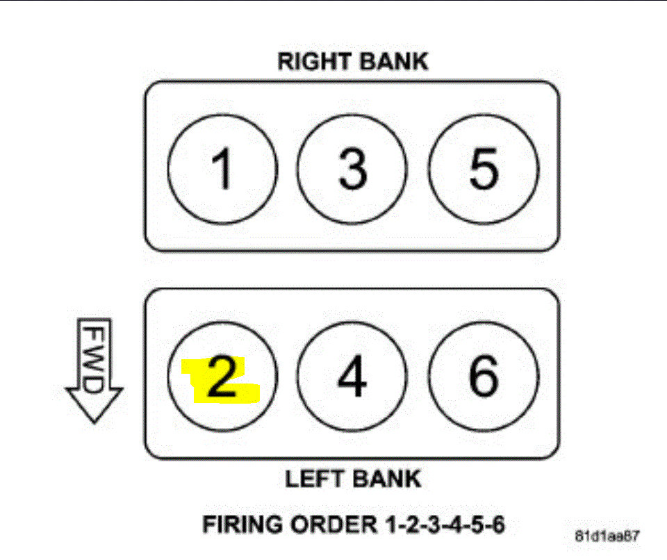

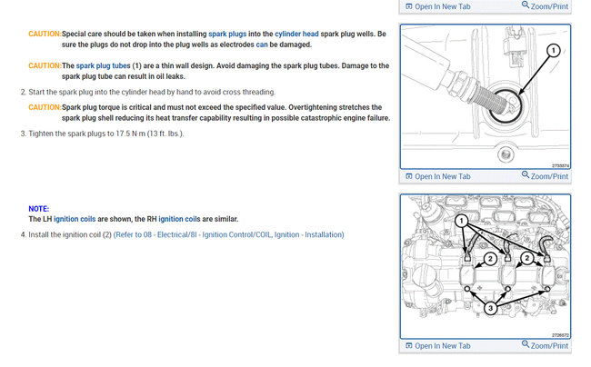

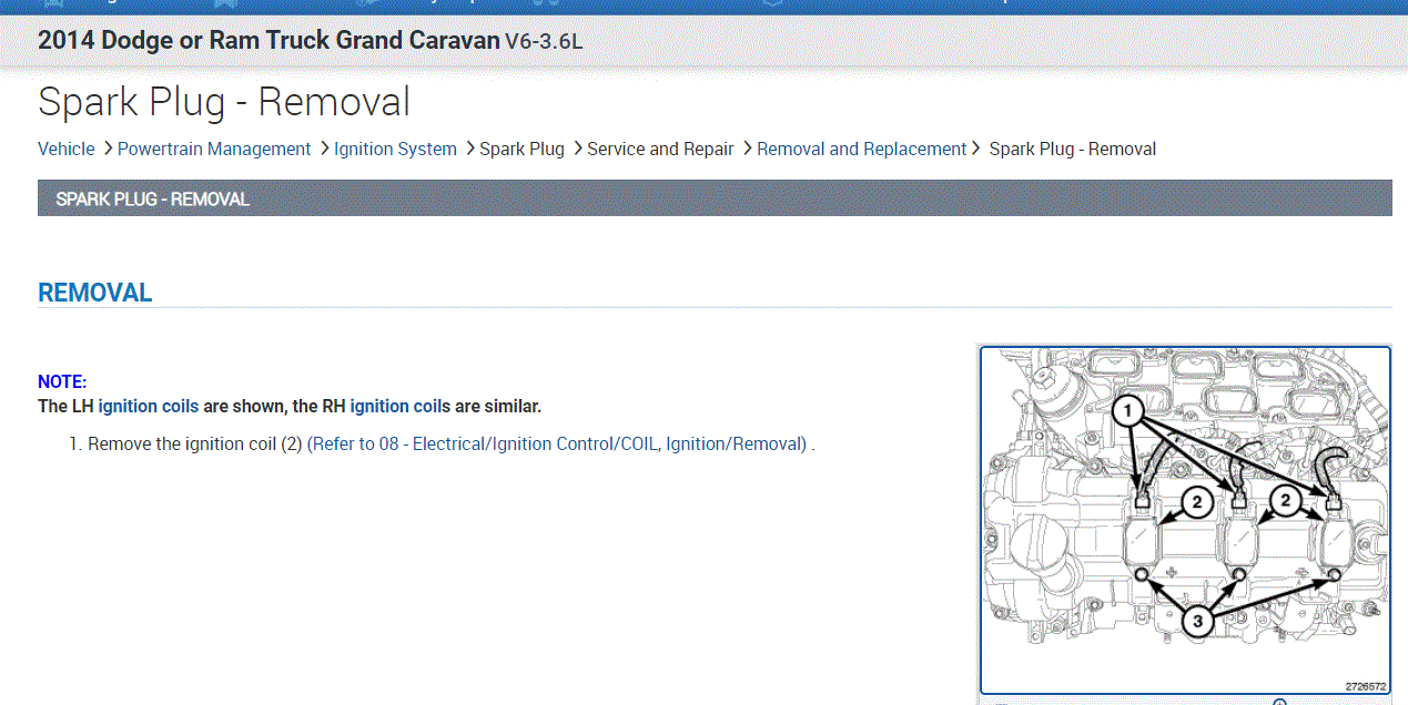

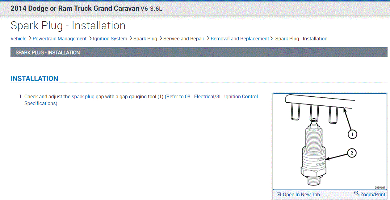

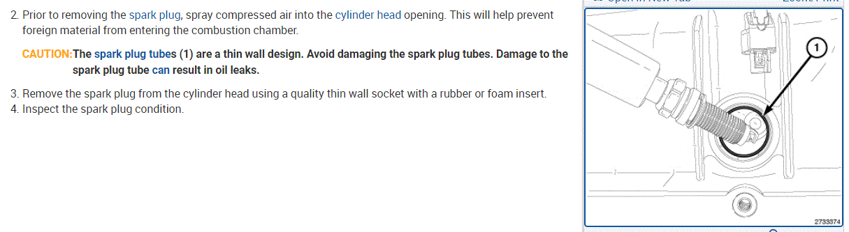

If you look at the pics below, they are specific to removal and replacement of the spark plugs for your vehicle. The last picture shows cylinder locations. I highlighted cylinder 2. It is one of the easiest to get to. Remove the spark plug and replace it with a new one. If the coil was bad, the plug may be bad.
The original equipment spark plug is a champion part number RER8ZWYCB4. It is an iridium spark plug so expect to pay between 8 and 10 dollars for one.
I hope this helps. Let me know if you have other questions.
See pics below.
