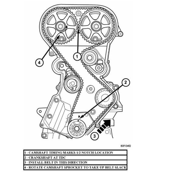

If the timing is the case could I have damaged the rebuilt head that I had installed. Can I get clearer pictures of the timing marks and the correct position especially that pensioner with the pin looking thing.
Jul 25, 2018 at 10:00 AM
Diagram attached.
No. I doubt it since it runs.
