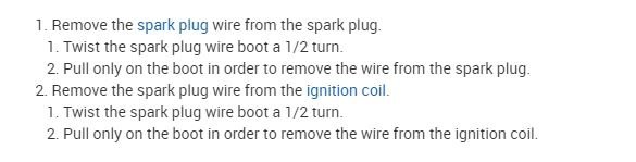

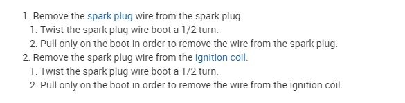

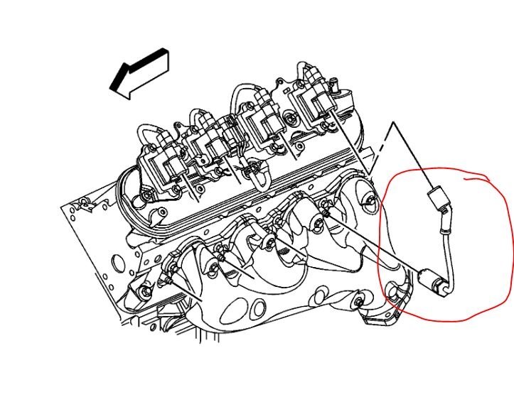

Good morning,
Good chance the wires are getting wet and they are leaking out electricity. They arc and the plugs do not get the full amount of voltage to the plugs.
