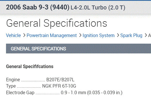

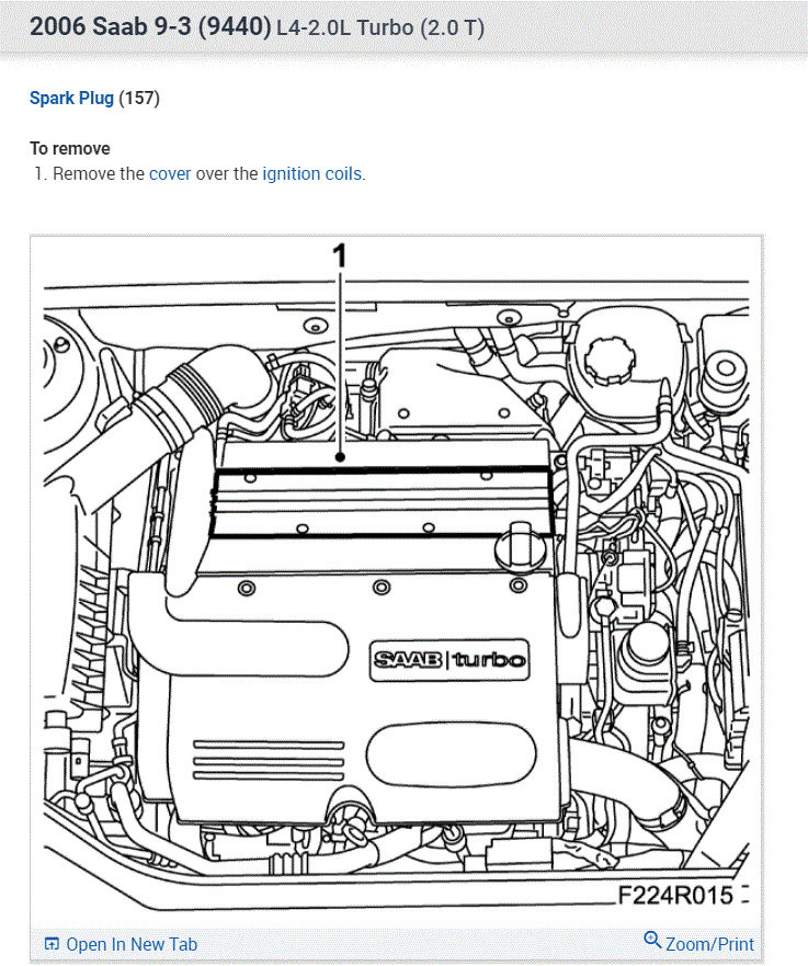

A P0300 indicates a random misfire, which could be due to spark plugs. However, there are other things that can cause this.
As far as the iridium spark plugs, yes they are excellent and long-lasting, but expensive. If that is the choice you go with, make sure you get the proper ones as far as heat range is concerned. The parts store should be able to cross-reference them from the original spark plug number.
Also, I just responded to your other post related to the fuel pressure regulator. Now I understand where you are going with this. Are there any other codes stored? If so, let me know what they are so I can better direct you.

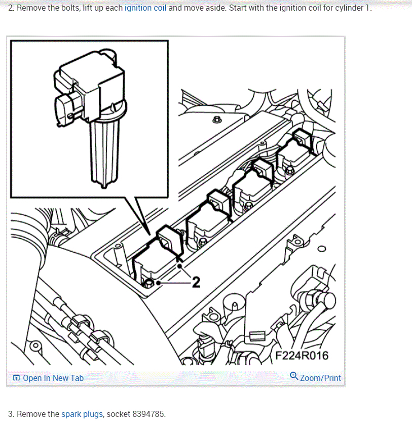

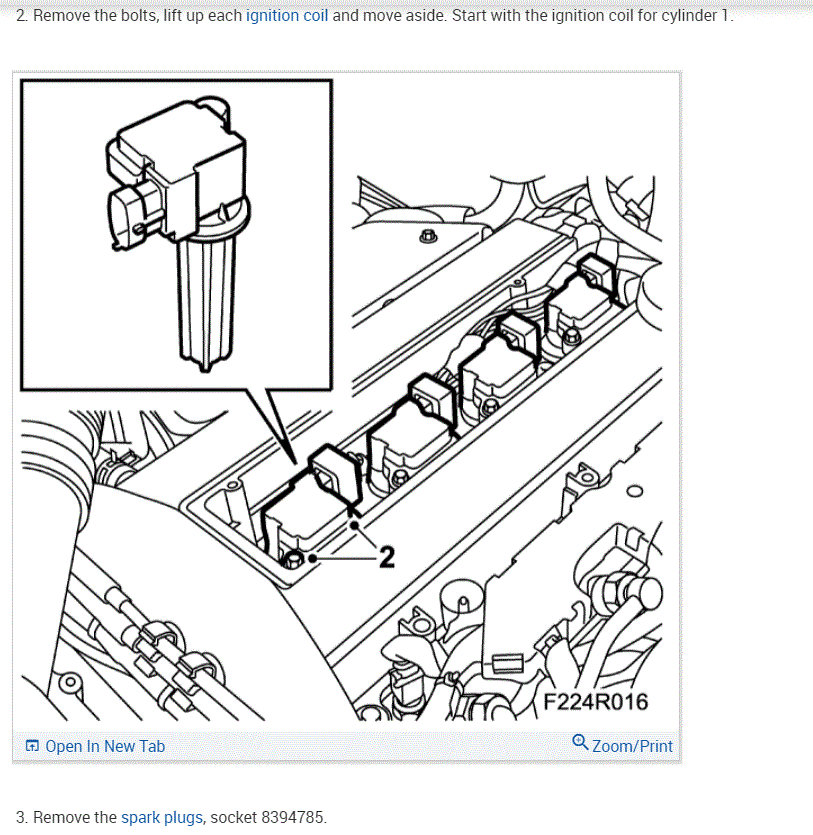

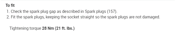

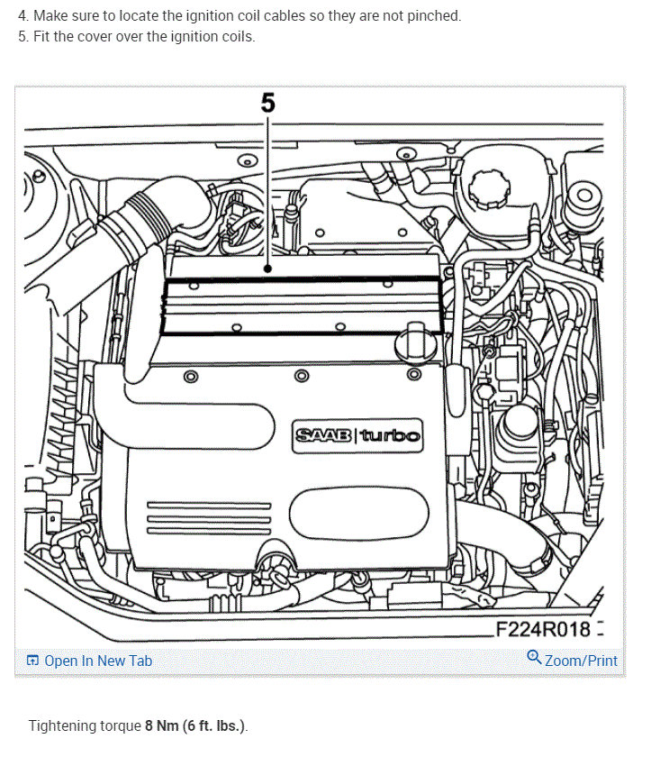

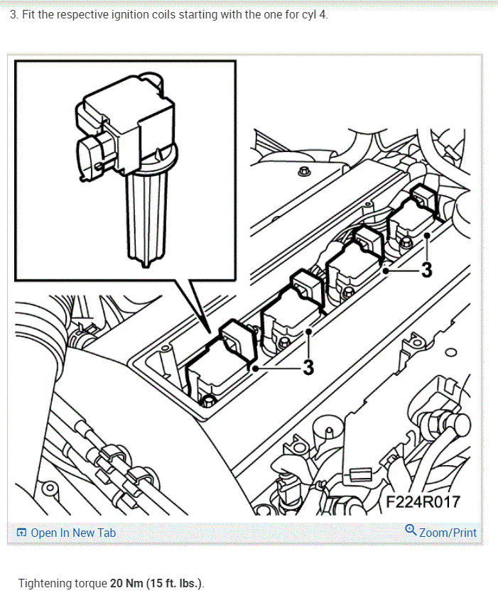

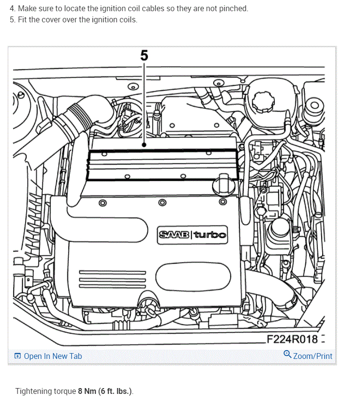

Also, pic 1 below shows the original type spark plug and part number that was used on this vehicle new. The remaining pics are for the removal and replacement of the plugs.
I hope this helps. Let me know if there are other codes and how things turn out for you.
See pics below.

what size mm socket do I need for the engine cover and the spark plugs? And, do I need to torque the spark plugs?
Nov 30, 2021 at 12:08 PM
The code is related to the plugs. However, that doesn't mean it isn't being caused by something different.
As far as sizes, I believe the spark plugs will either require an 18mm or 3/8" socket. As far as the cover bolts, I expect either 8mm or 10mm.
