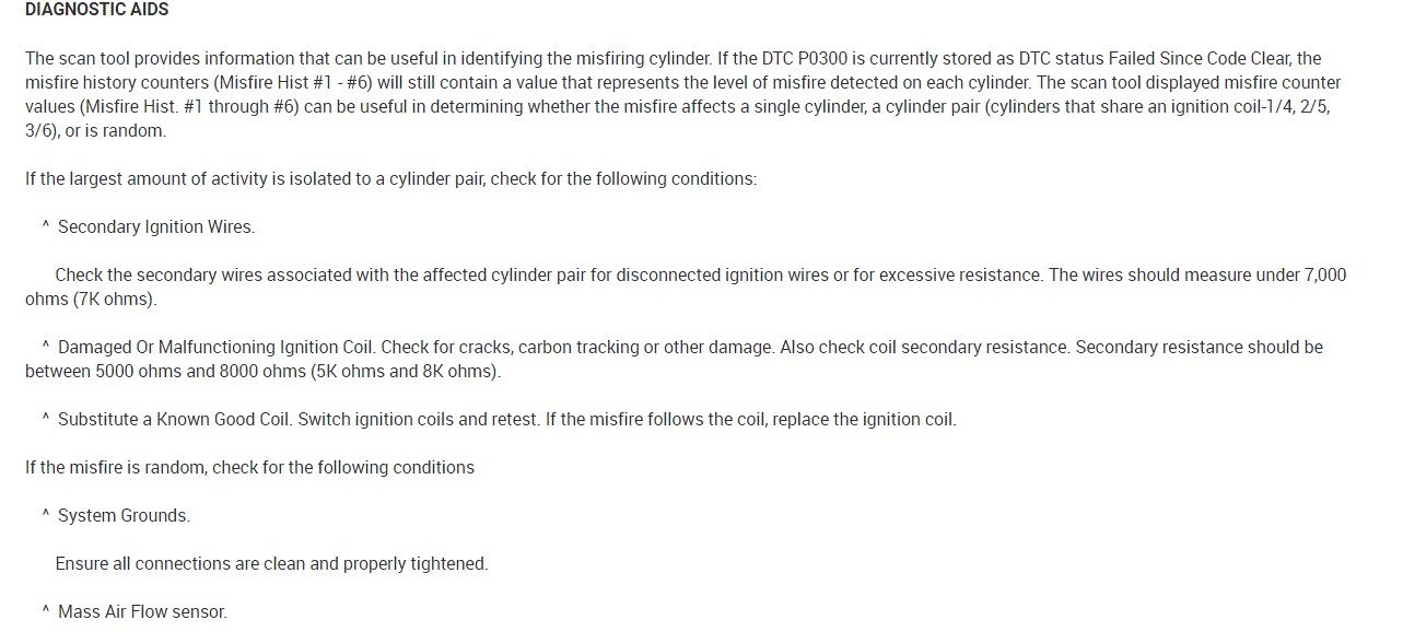

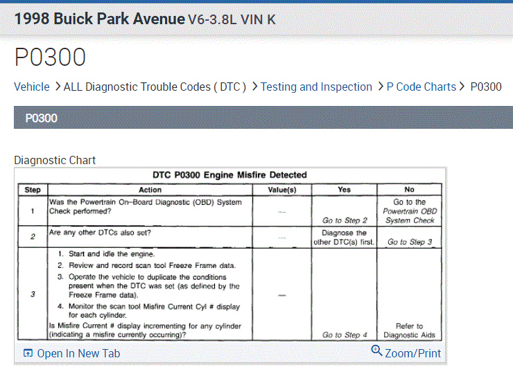

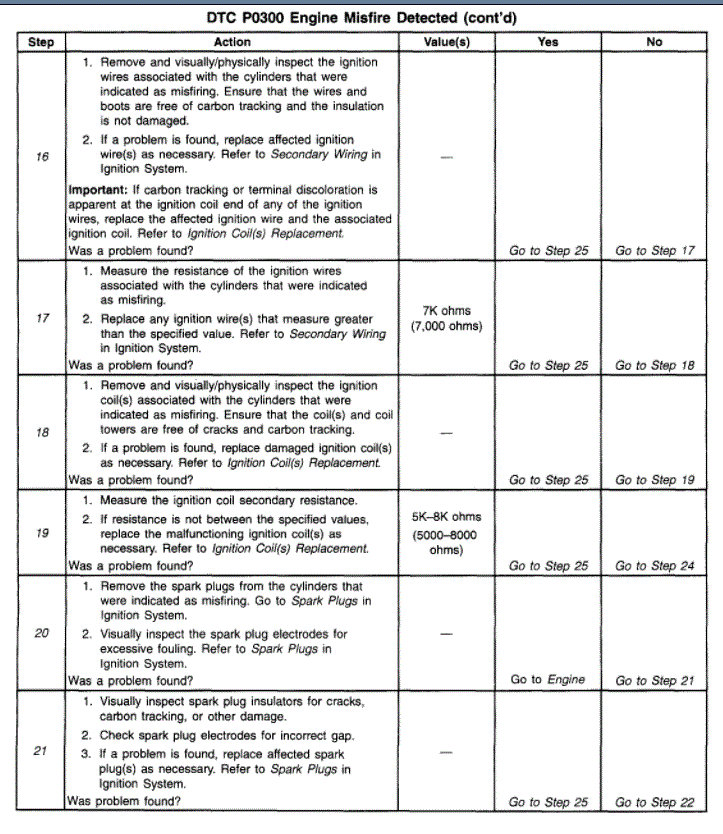

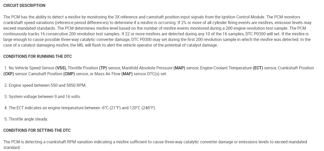

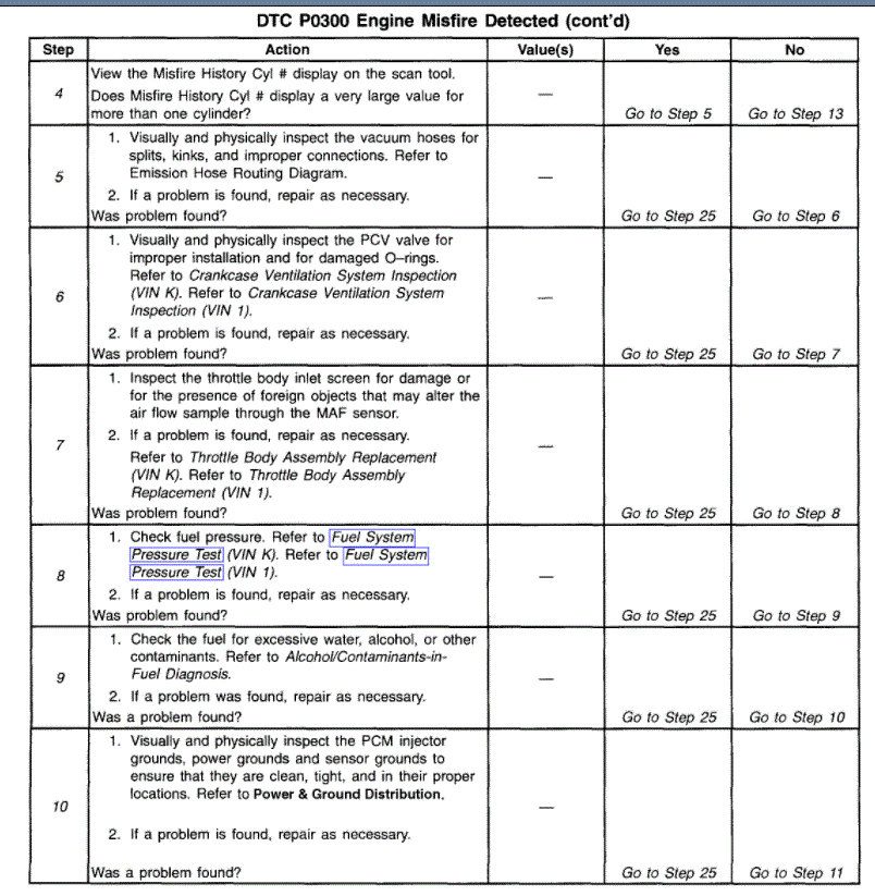

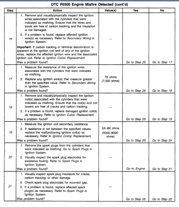

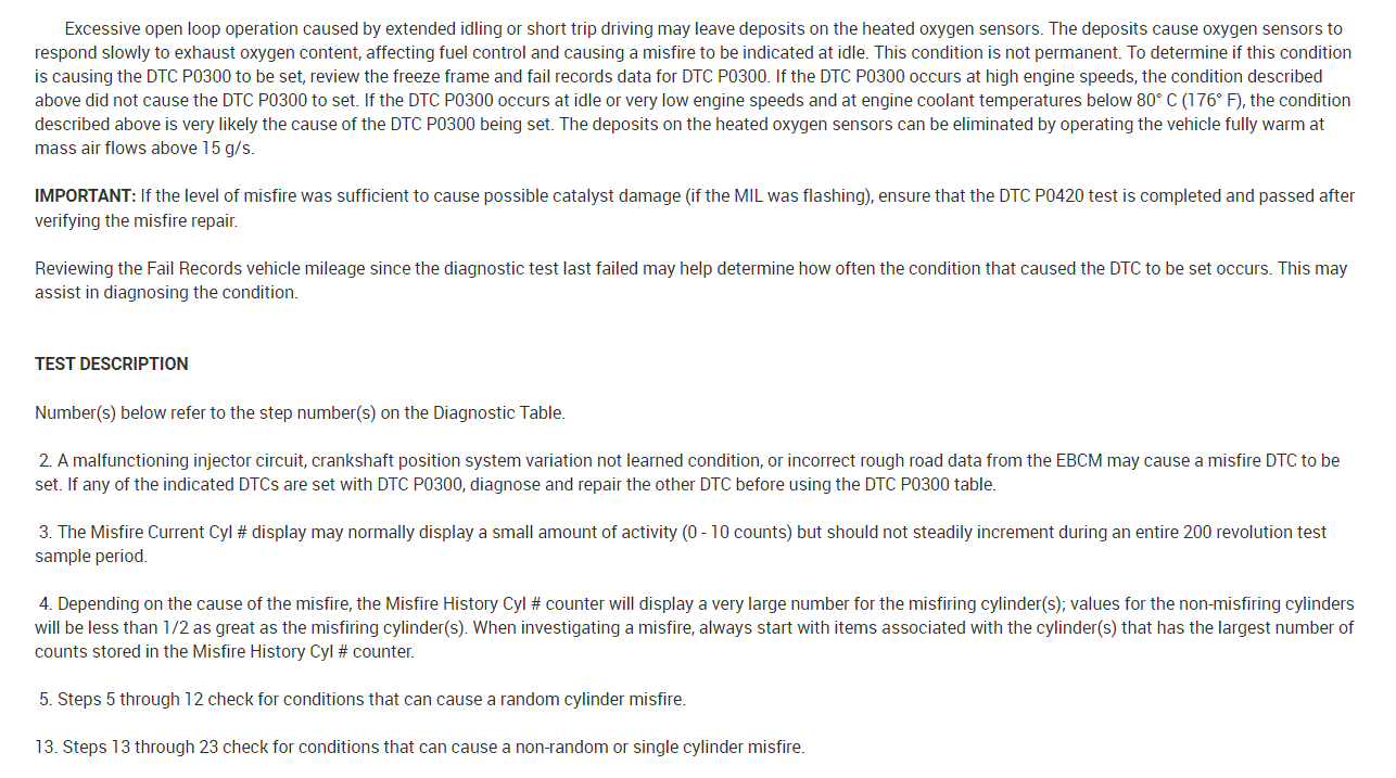

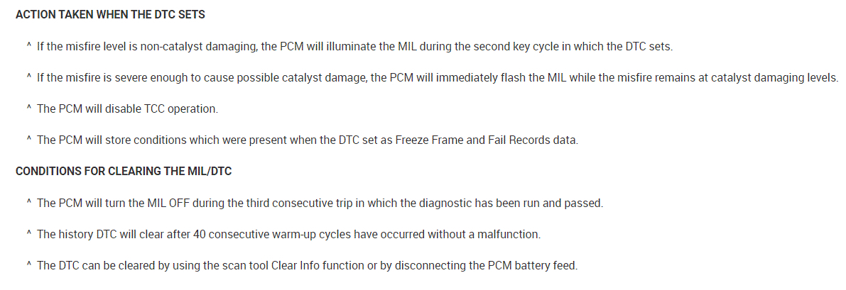

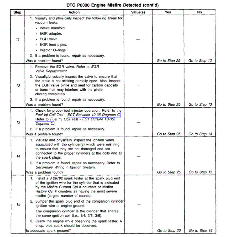

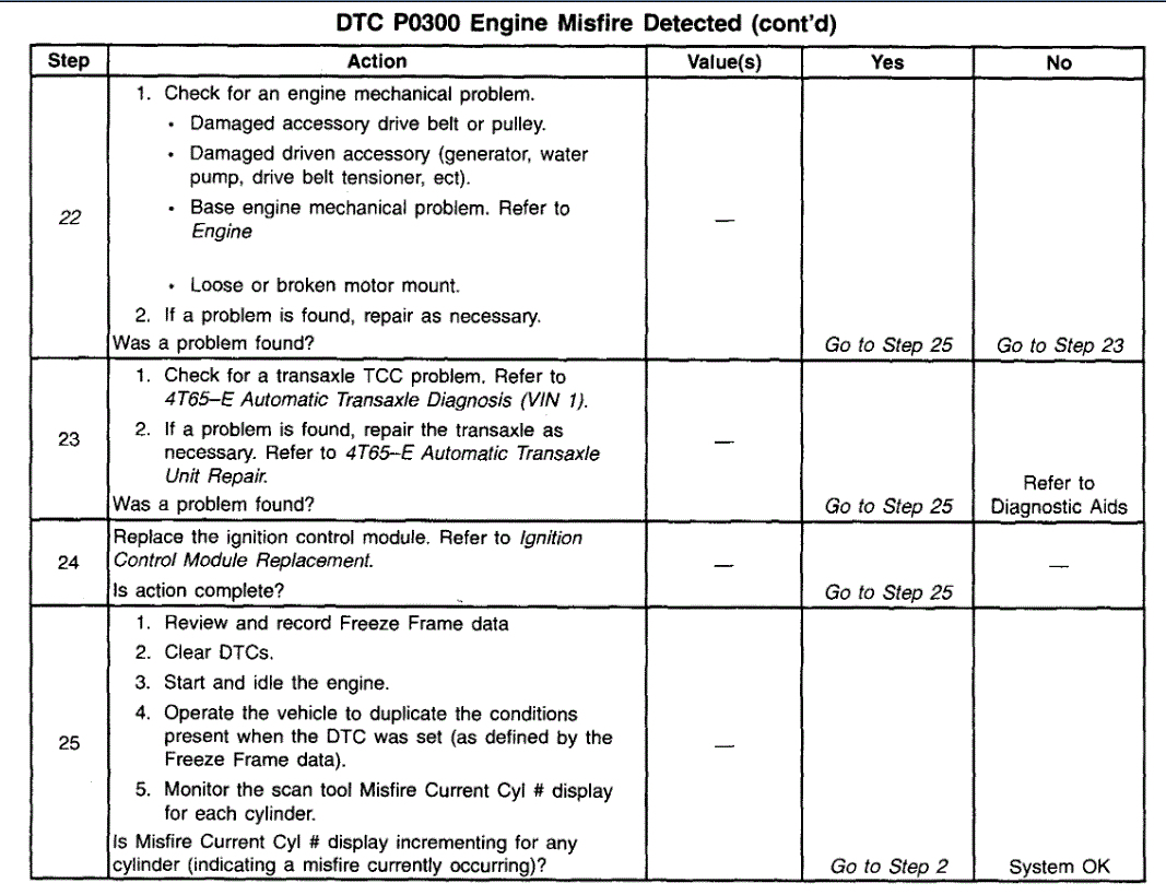

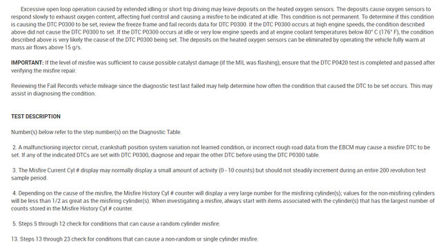

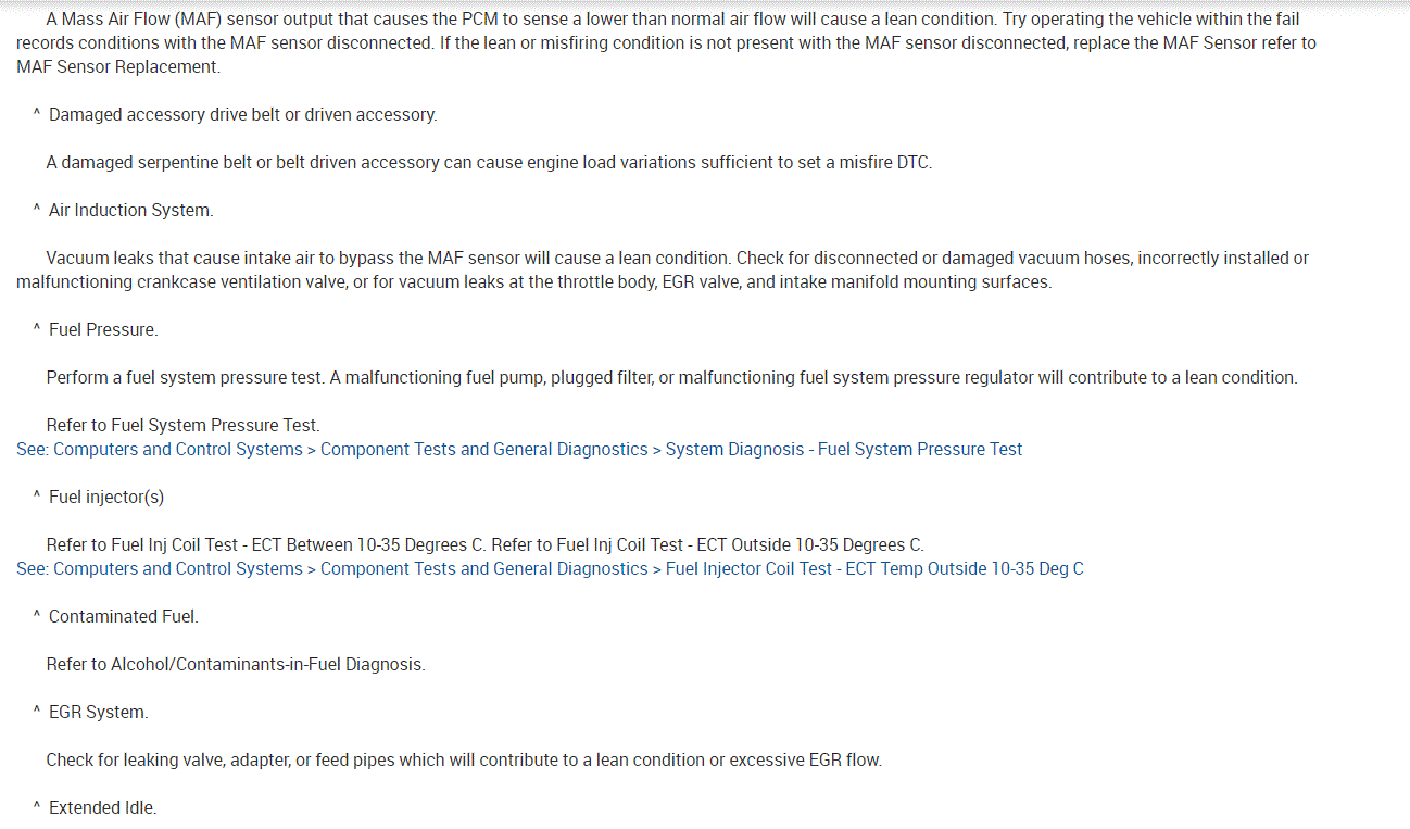

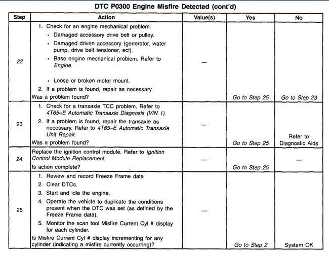

I attached the diagnostics below for the code. Take a look through it and let me know if you are comfortable doing it. If you need help, let me know.
See pics below.
