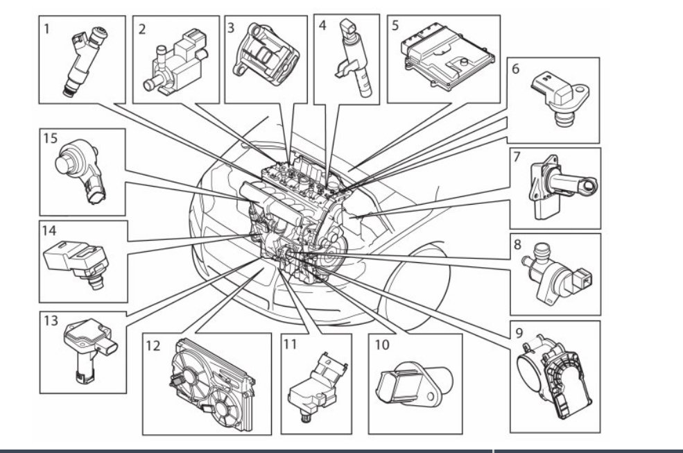

Volvo xc60 T6. it has been two weeks after driving for 20 minutes my car loses power when pressing gas pedal, and car is shifting harder and in higher RPM's. It feels like turbo is working or something is going on. There is no any wired noise or check engine lights. thank you

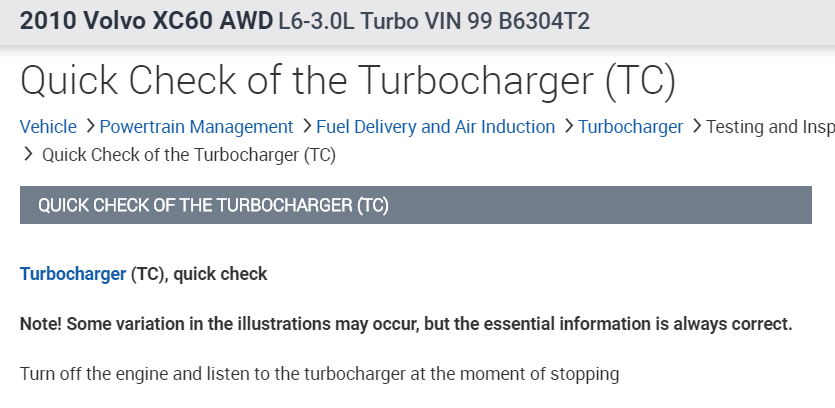

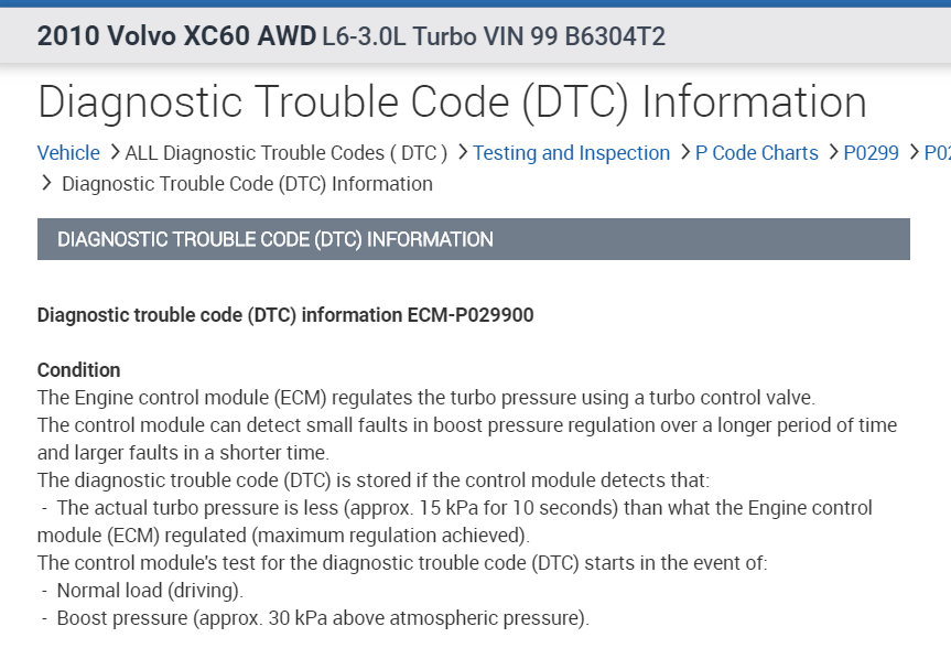

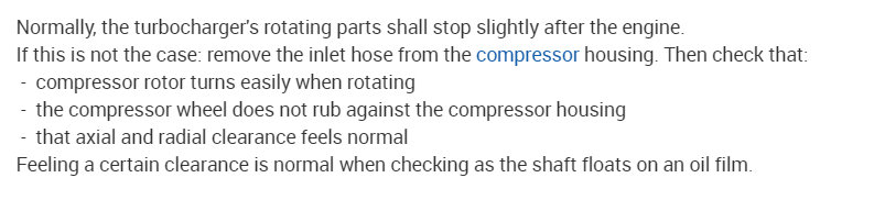

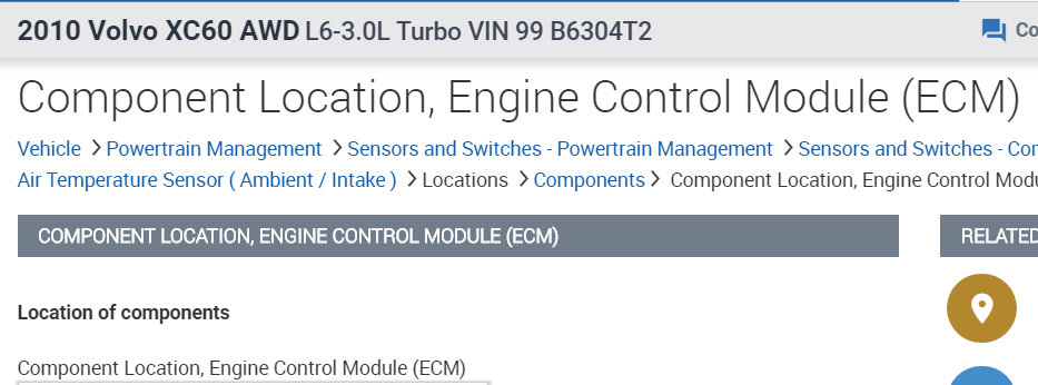

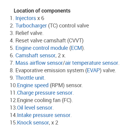

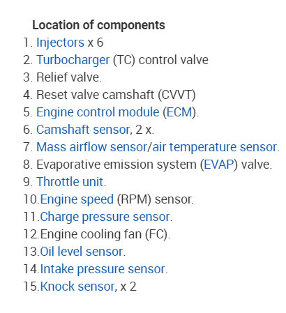

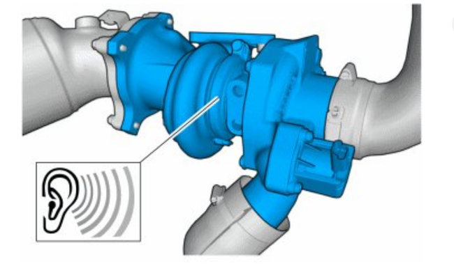

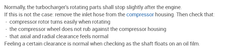

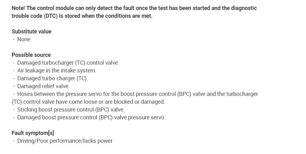

This is a Direct Trouble Code (DTC) for your vehicle's turbocharger not operating properly. In the diagrams down below I have included the factory diagnostic troubleshooting guide for this DTC as well as diagrams for where the related components are for you to inspect. Please go through this guide and get back to us with what you are able to find out.
Thanks,
Alex
