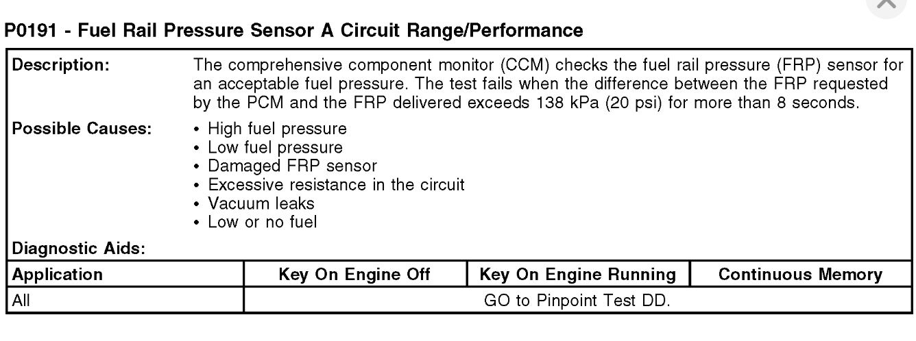

P0191
Descriptor
Probable Causes
Circuit Resistance High
Fuel Rail Pressure (FRP) Relay Sensor Damaged
High Fuel Pressure
Low Fuel Pressure
Low or No Fuel
Vacuum Leaks

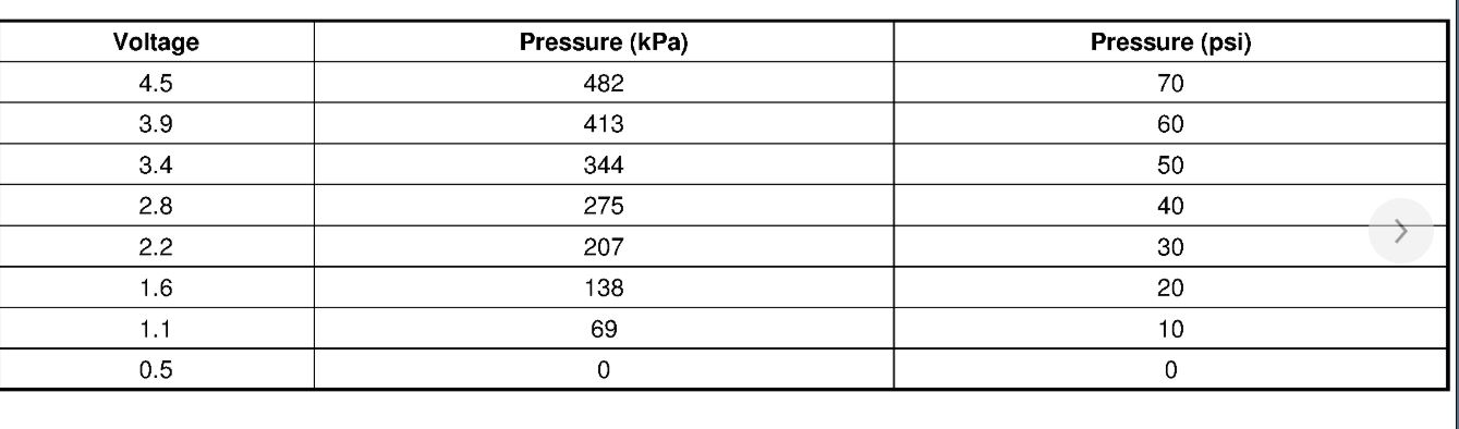

FRP SENSOR VOLTAGE AND PRESSURE SPECIFICATIONS

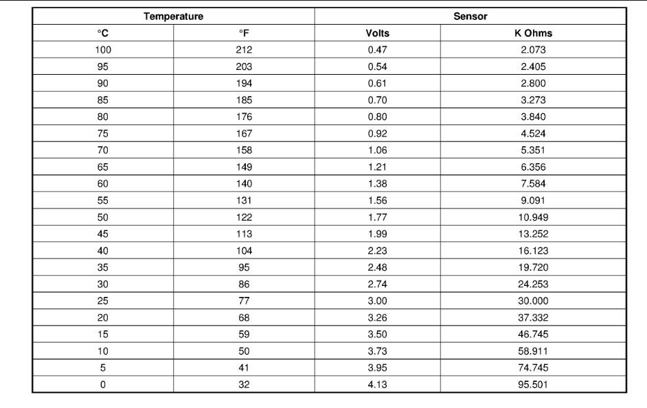

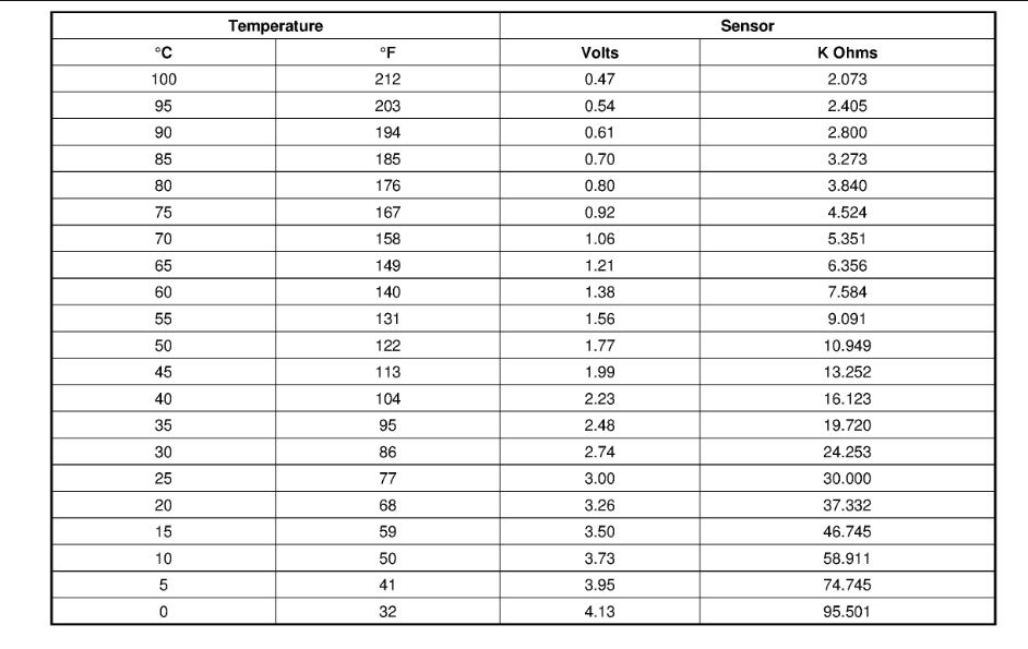

FRT SENSOR TEMPERATURE, VOLTAGE, AND RESISTANCE SPECIFICATIONS

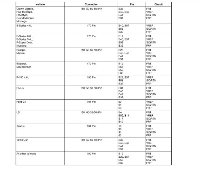

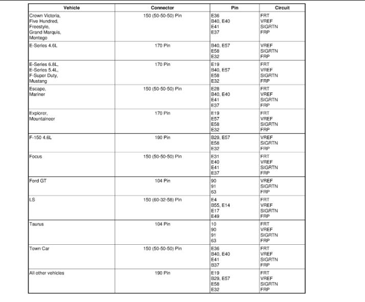

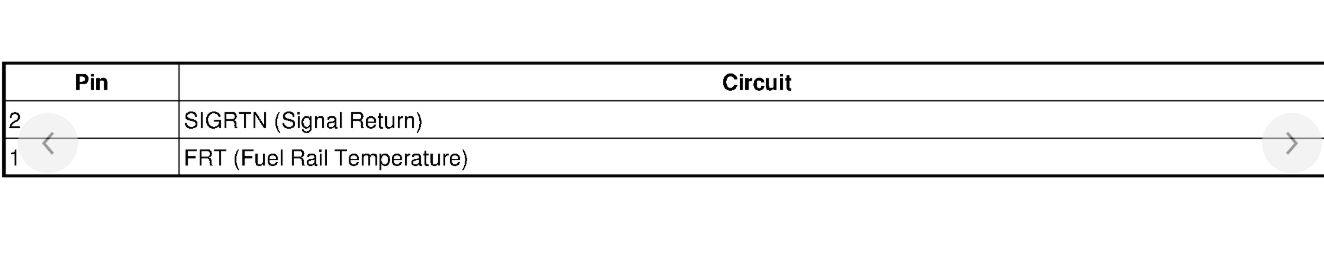

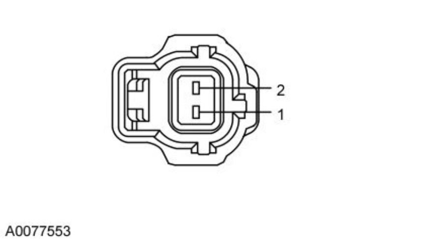

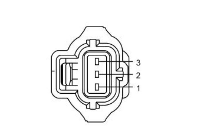

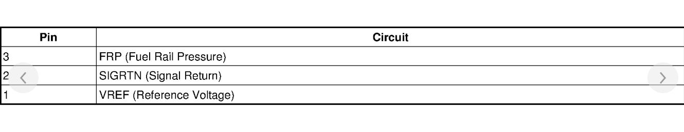

Fuel Rail Pressure (FRP) Sensor Connector

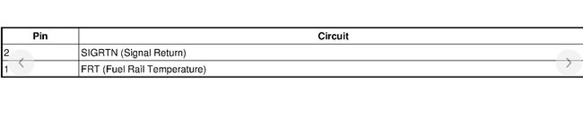

Fuel Rail Temperature (FRT) Sensor Connector
Fuel Rail Pressure Temperature (FRPT) Sensor Connector
Powertrain Control Module (PCM) Connector
For PCM connector views or reference values, refer to Section 6 See: Computers and Control Systems > Diagnostic Trouble Code Tests and Associated Procedures > SECTION 6: Reference Values.
