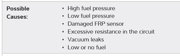

Code p0191 came up. i replaced fuel filter still sputters then replaced fuel rail pressure sensor still sputters, replaced fuel pump still sputters. please help.
Aug 5, 2016 at 5:57 AM
HMAC300
  • 48,601 POSTS
that is a fuel pressure circuit problem. check fuel pressure with a gauge auto parts rent it. see picture for other causes.
