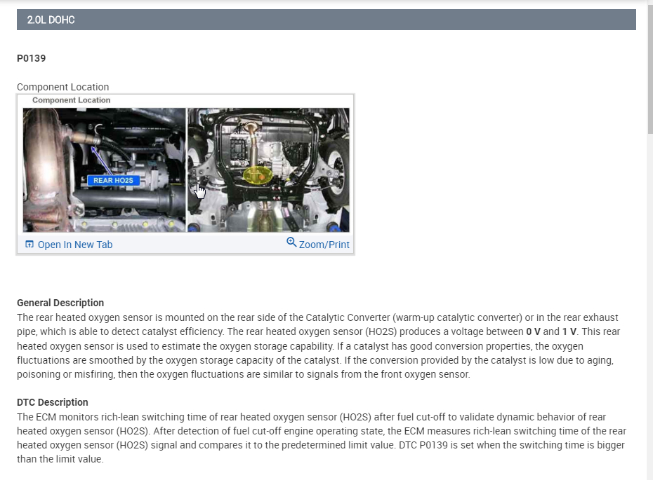

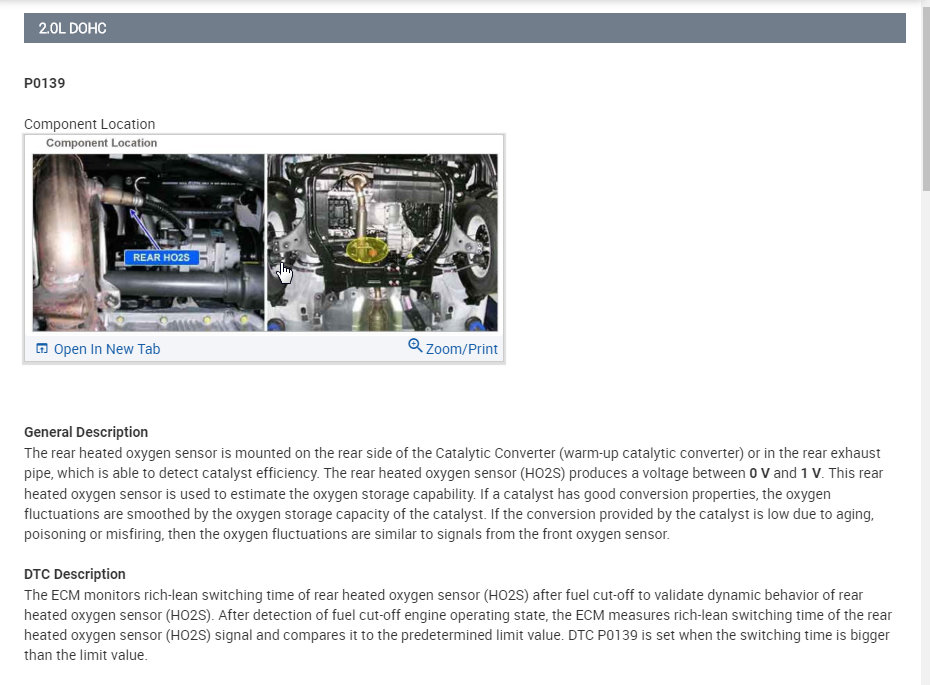

I suspect you have an air leak causing the o2 sensor reading to be off which is setting the code.

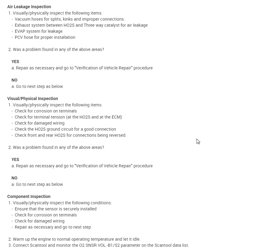

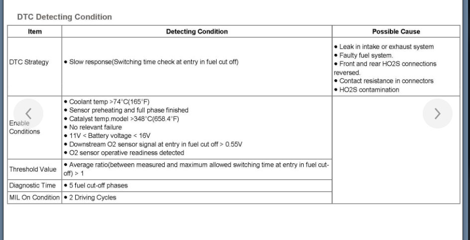

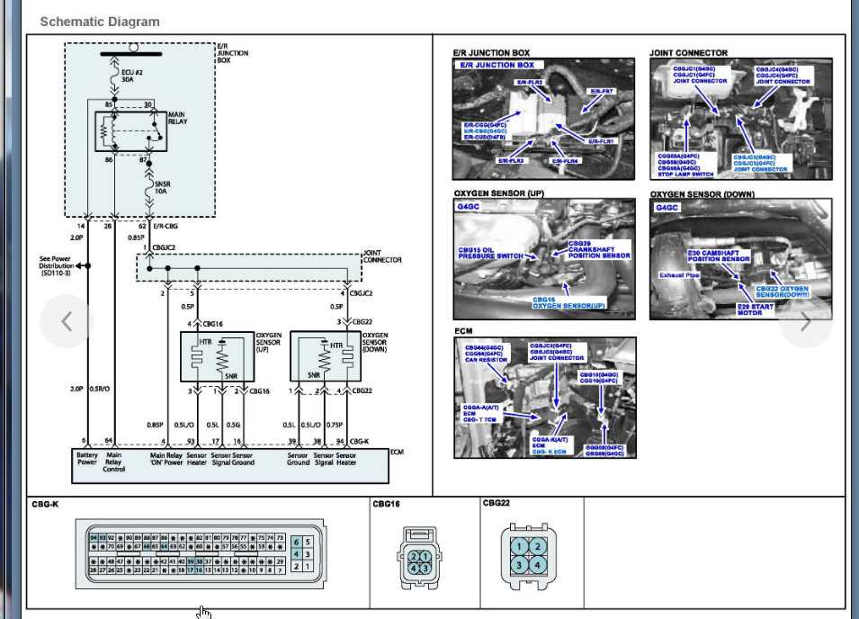

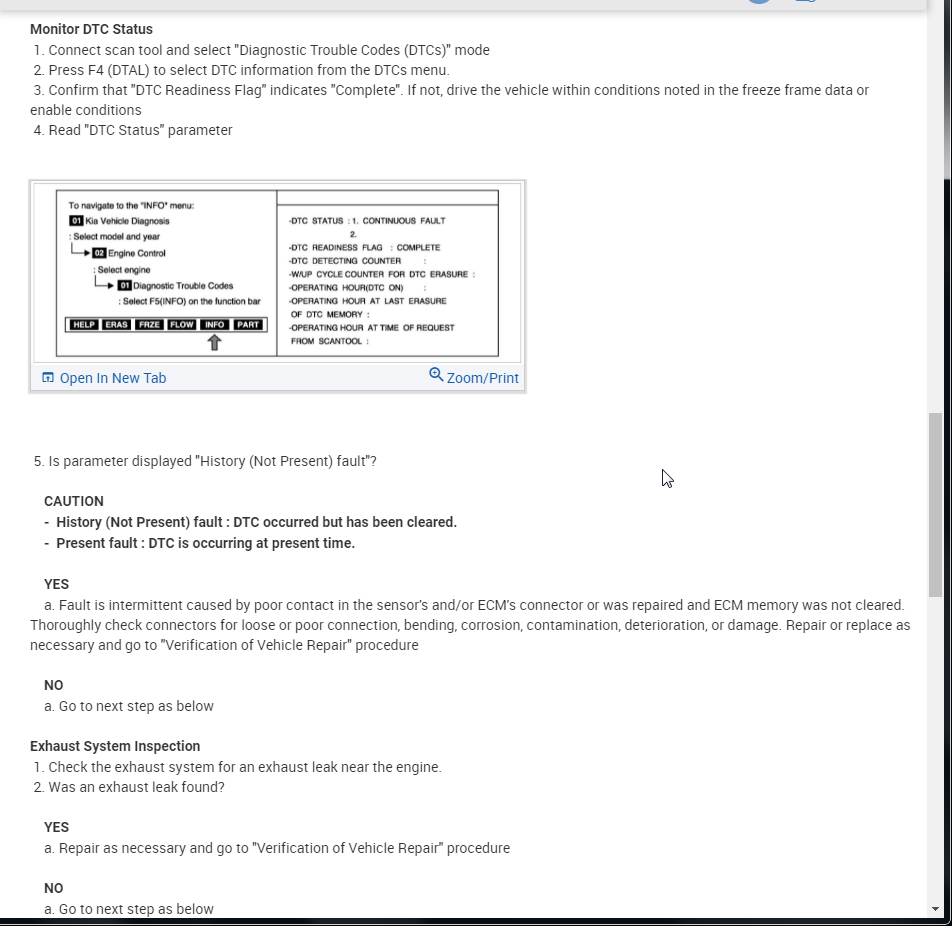

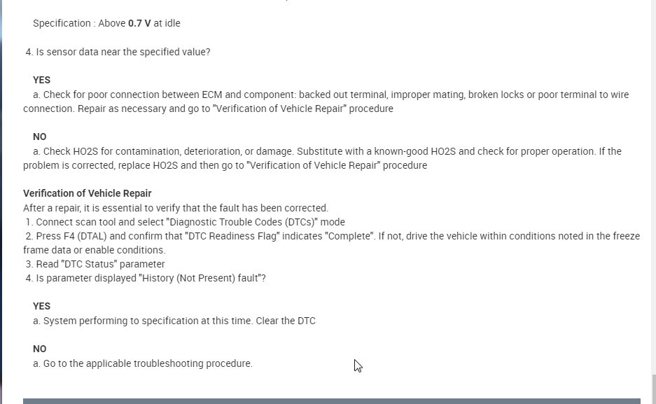

I attached the testing that we need to go through in order to determine the cause. Unfortunately there is no easy way to figure this out other than to run through the testing. I would not replace the sensor again as I think it is clear there is another issue. If you take a look at the second attachment it lists the possible causes which includes an air leak.
Let's run through this and see what we get. I am not sure if you are going to do this or have someone else. Either way, just let me know the results and we can walk through it together. Let me know if you have questions. Thanks

It could be the cat but I would think we would have other codes with this because we have the ability to monitor the efficiency of the converter.
I would make sure he is going through this test and not trying to diagnose this by his own testing. I suspect that is why he put the sensor on it because if you follow the testing through, it doesn't direct you to replace the sensor unless it was damaged. Clearly if this code keeps coming back then he is not fixing it. This is where it can get costly is when someone is replacing parts that are not actually diagnosed.

I understand. There is no name for the testing. It is just the diagnostic test for the P0139 code. I would ask that they follow the steps laid out in the diagnostic test for this code and tell you what they find.
