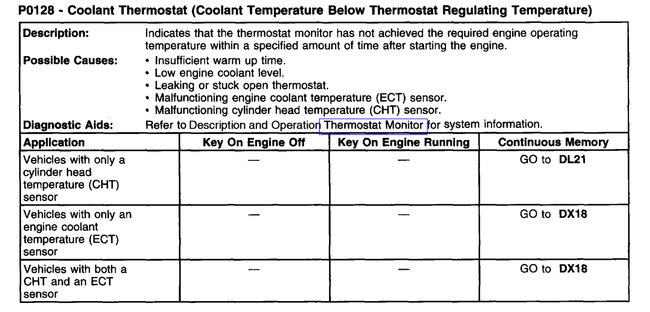

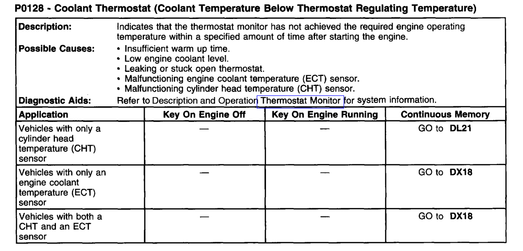

Engine not reaching its operating temperature. The radiator fan runs as soon as I start the car and stays on. I replaced the thermostat and sealed a leak in the cooling system. The error comes back on. The next thing I thought of was the coolant temperature sensor but that one seems to be fairly new, probably replaced by previous owner. The only thing left I can think off is the cylinder temperature sensor. any other suggestions?
