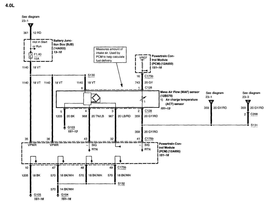

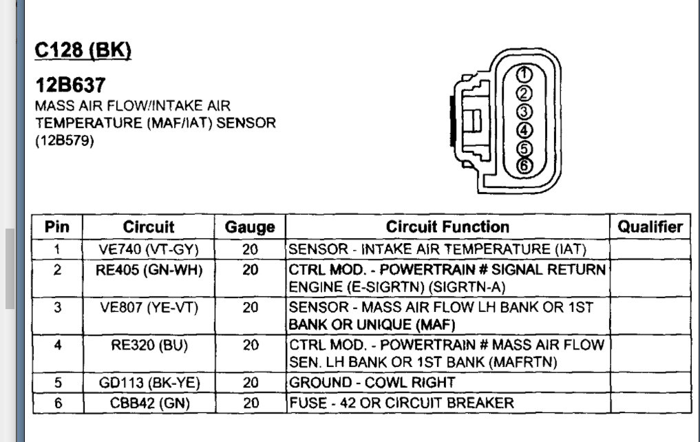

The IAT and the MAF are the same part, so they share the same circuits. Usually when an IAT shows -40 degrees, it means it's unplugged or not responsive. (Open circuit).

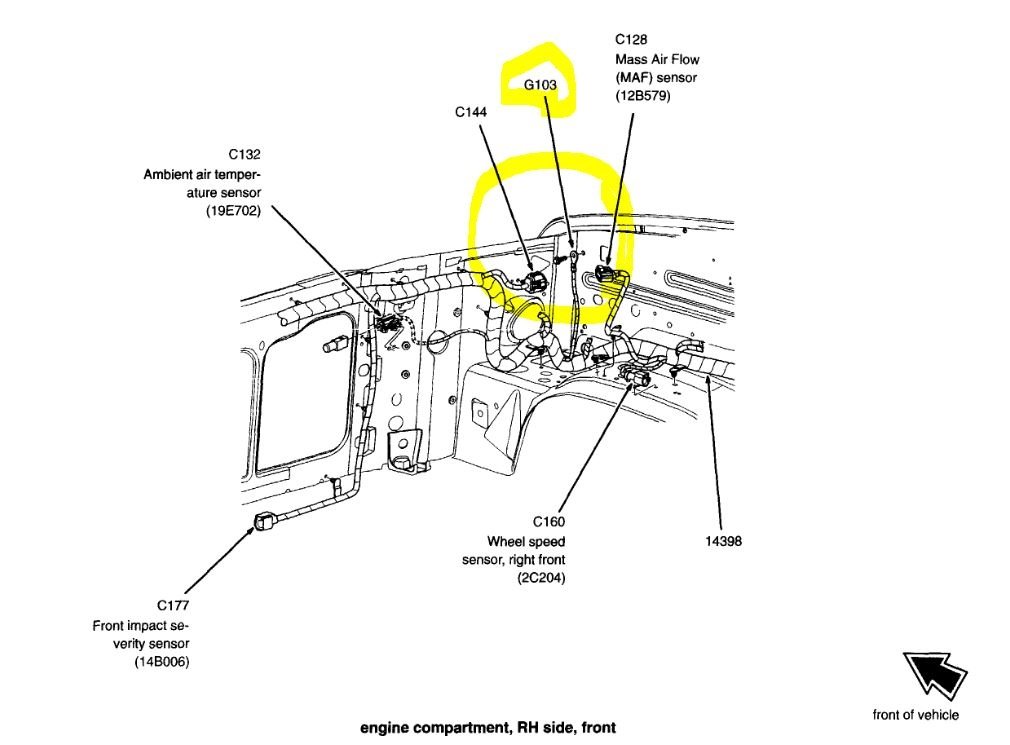

You should check the wiring going to the MAF/IAT sensor. Check for 5 volts at the sensor and be sure to check the ground too. I've attached a wiring diagram and the location of G103, the ground point for that sensor.
A good test would be to disconnect the battery and OHMS test the circuits end to end. It really sounds like you have an open wire somewhere.

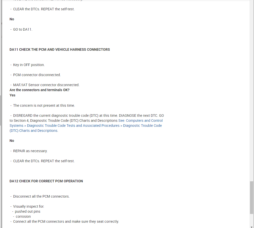

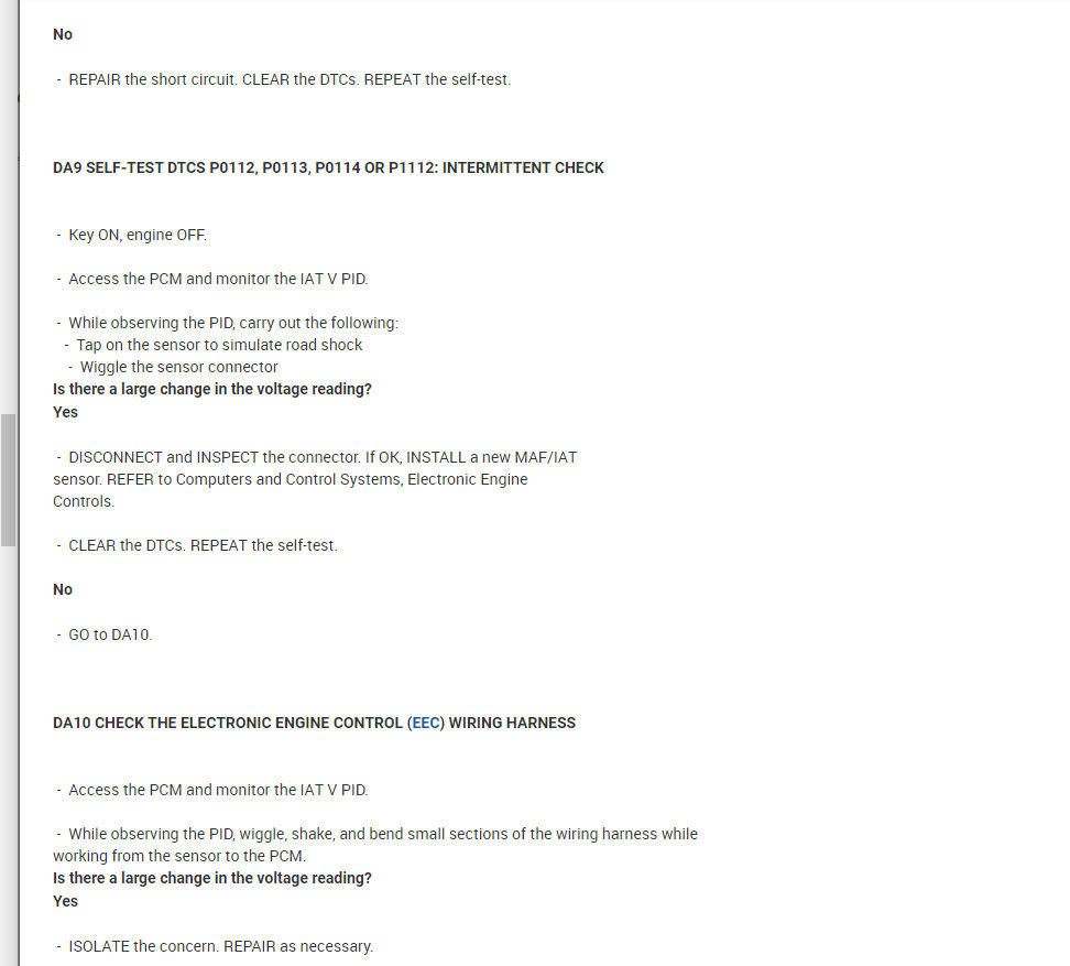

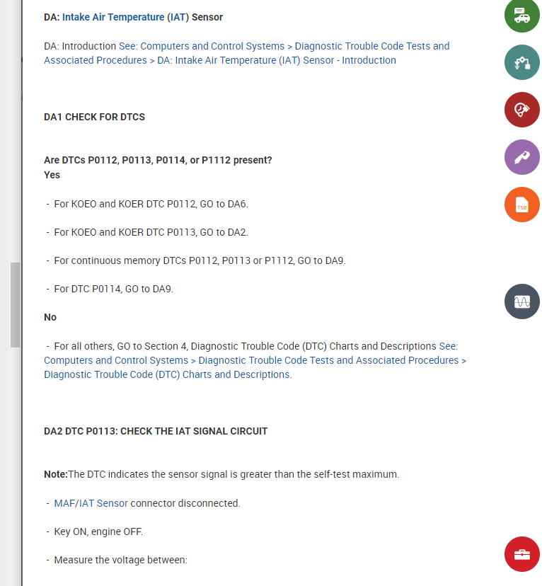

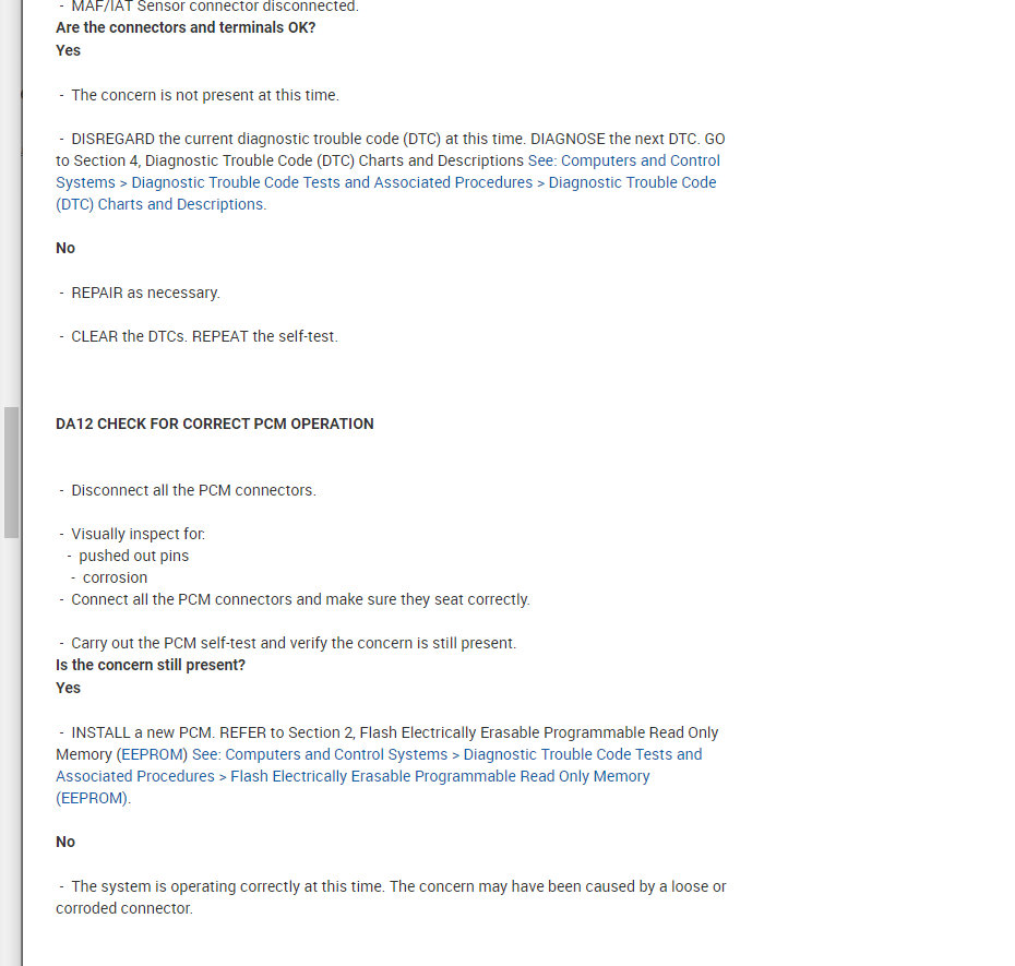

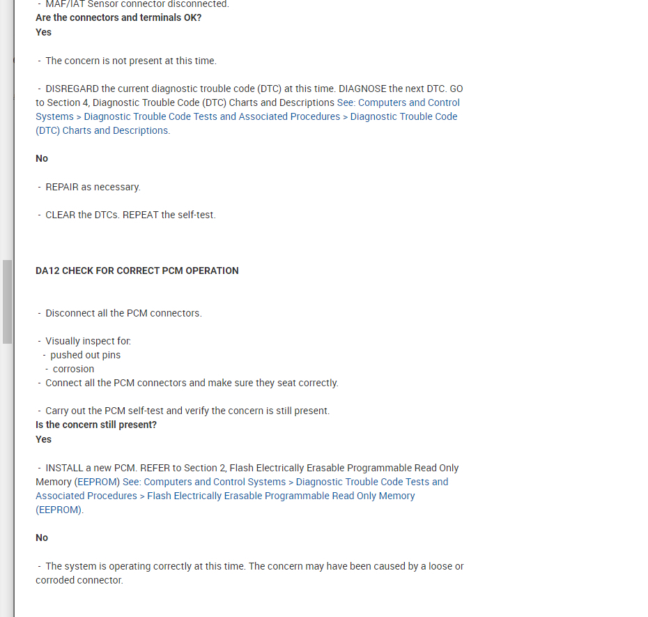

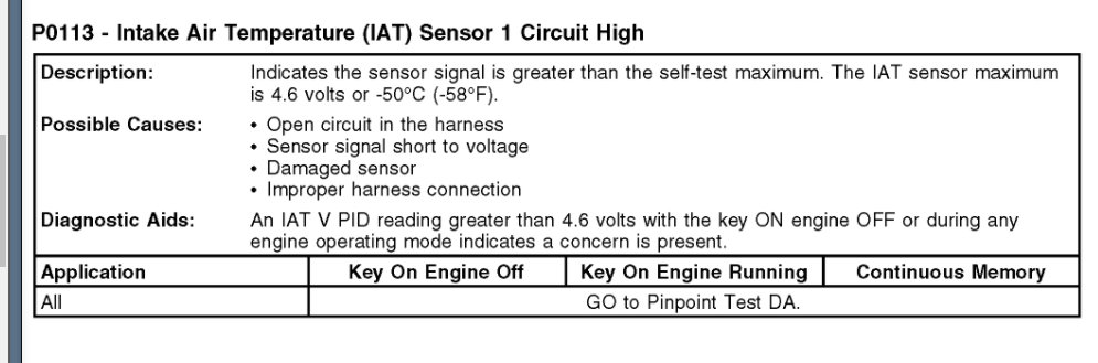

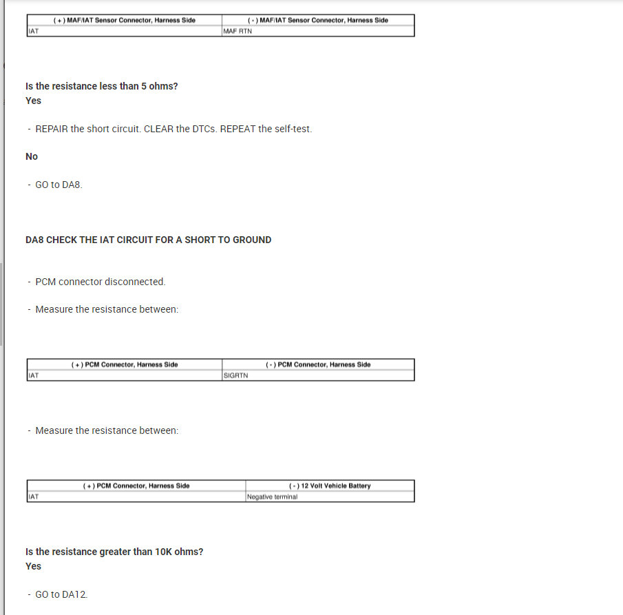

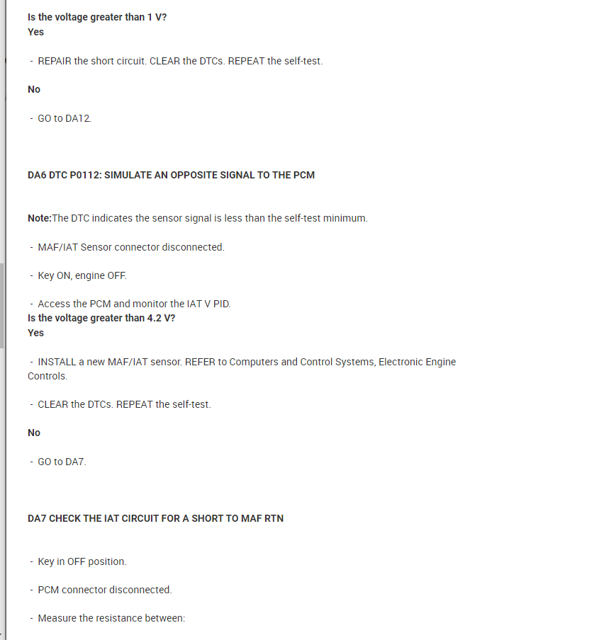

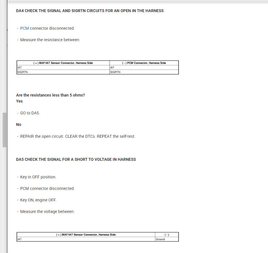

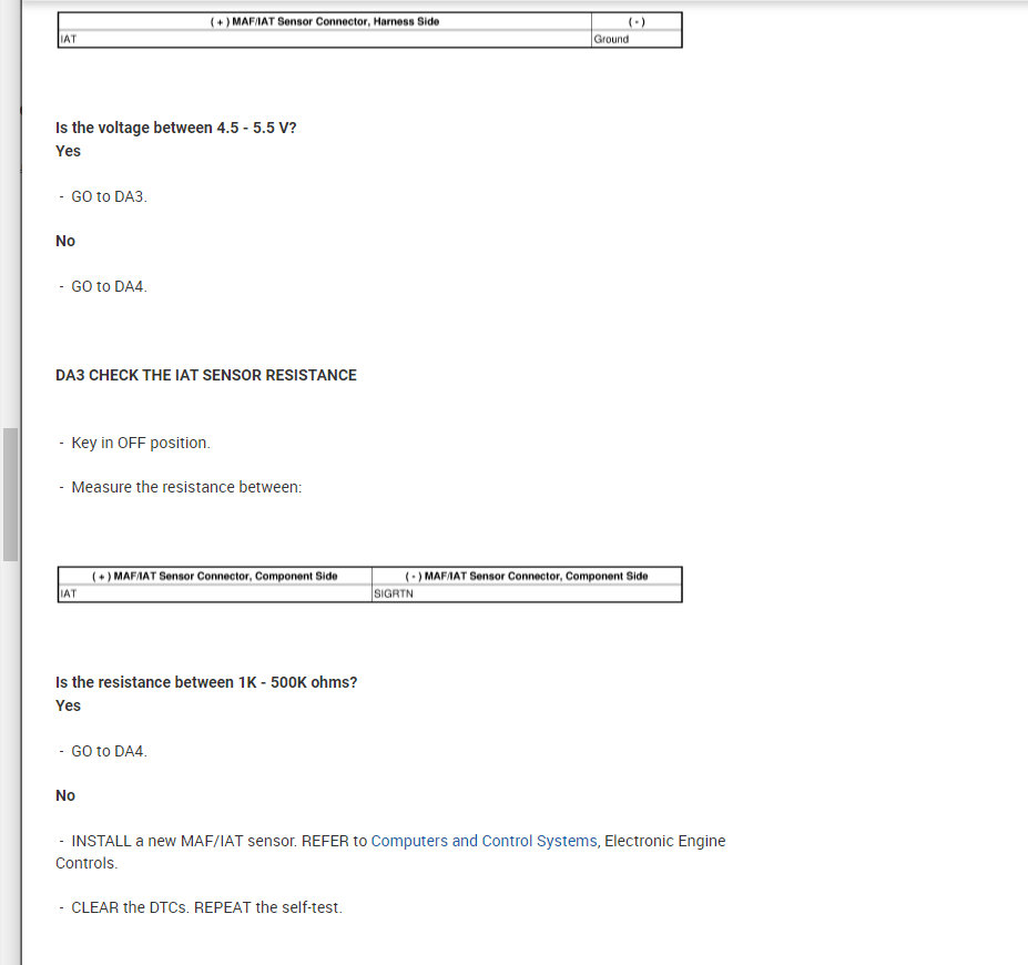

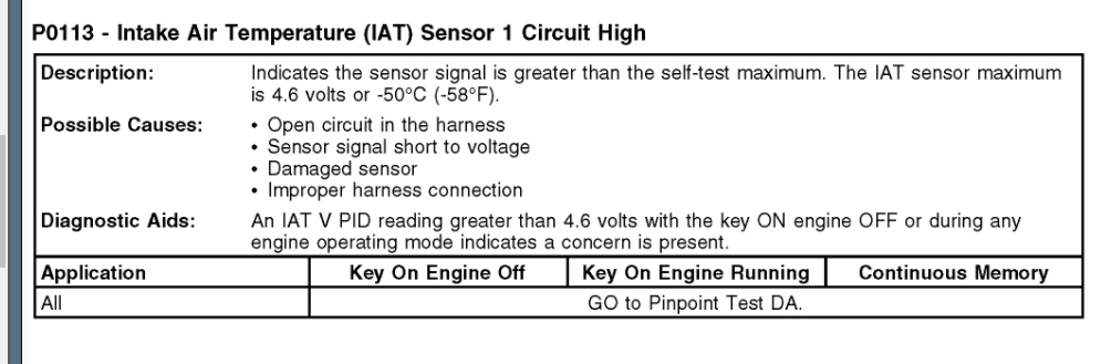

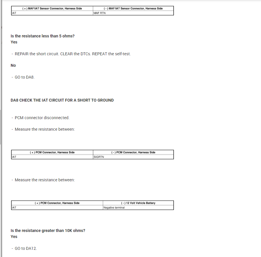

However, I am attaching the exact steps for this code. Clearly you are seeing the issue when you are looking at the MAF and IAT as they are a combine sensor. So, this is an open circuit issue, it is just a matter of finding it.
If the sensor is new, then I agree that it sounds like a wiring issue.
However, I attached all the testing below.
Please run through this and let us know what you find. Thanks
