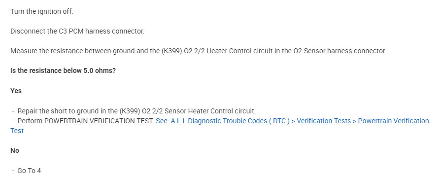

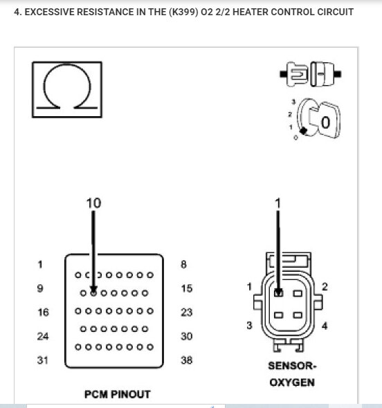

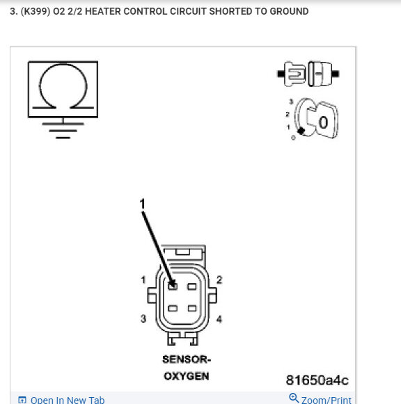

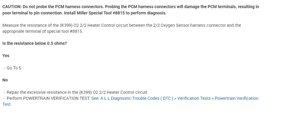

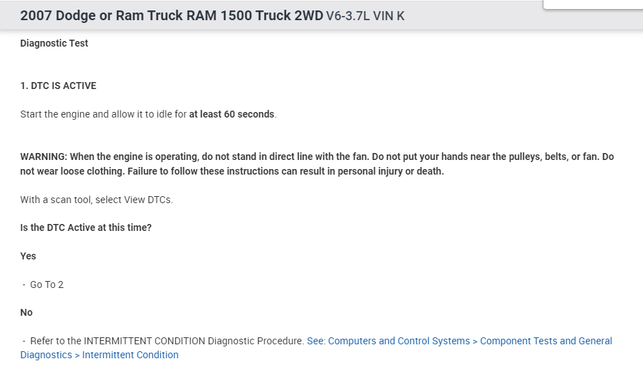

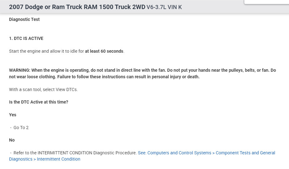

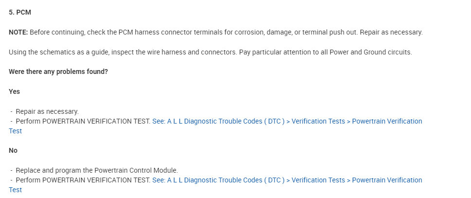

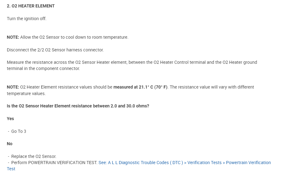

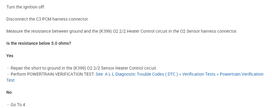

Wow, -83 Degrees? That doesn't make sense. As far as the issue, I attached the diagnostics below. It could be the result of a few different things. I don't want to say it, but the last thing in the diagnostics is the PCM. Hopefully, it is a wiring issue.
Take a look through them and let me know if you are comfortable performing them. Also, if the PCM was replaced 2 years ago by a dealer, is there any warranty on it?
See pics below.
