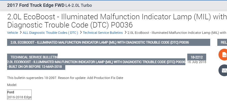

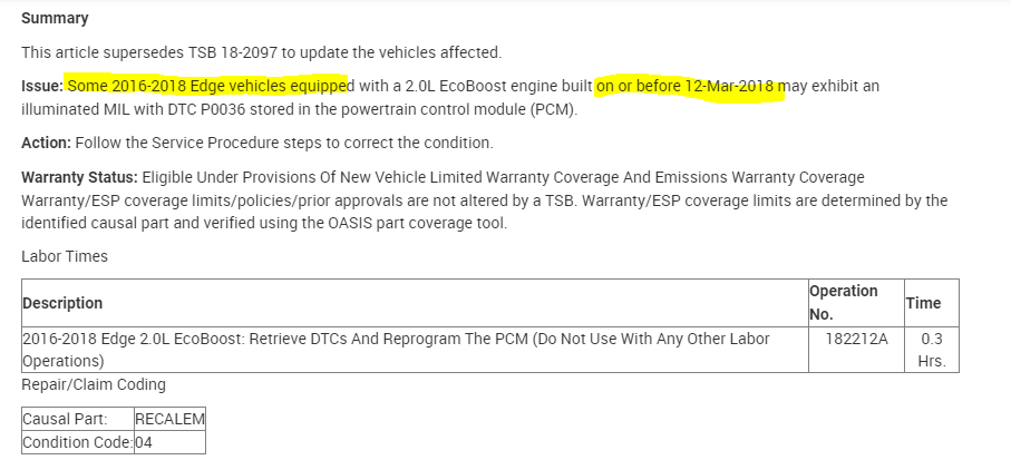

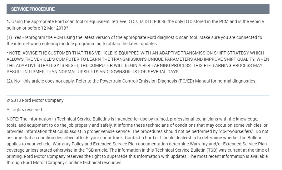

The code is specific to the heated oxygen sensor bank 1, sensor 2 (HO2S12). This code is set when the sensor does not warm up to the required temperature in a calibrated amount of time.
It could be caused by the sensor itself, a wiring issue, a damaged or corroded connector, a short, or an open circuit. Also, there is a technical service bulletin specific to the code which indicates the need to reprogram the PCM.
I attached the technical service bulletin below.
See pics below.
