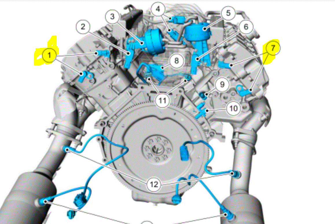

Vehicle had been driven 100 miles then shut off to fill with gas. Engine light came on. Code P0022. Local mechanic cleared code. Engine light hasn’t come back on but it feels like it has a rough idle. Can you tell me where “Intake (A) Camshaft Position Timing - over retarded (Bank 2)” sensor is? Diagrams would be great. Thank you

There are a total of four sensors. All are located on the rear of the engine and mounted in the cylinder heads.
Bank 2 is located on the driver's side of the vehicle. Take a look at the pics. The sensor on the right is the intake and the left side is the exhaust.
Let me know if this is what you needed.
See pic below.
