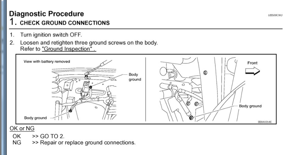

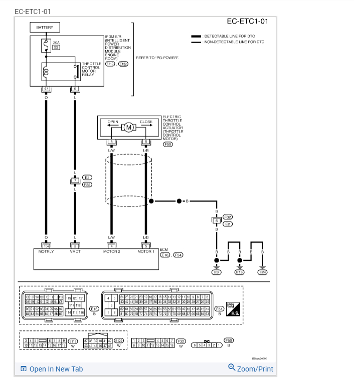

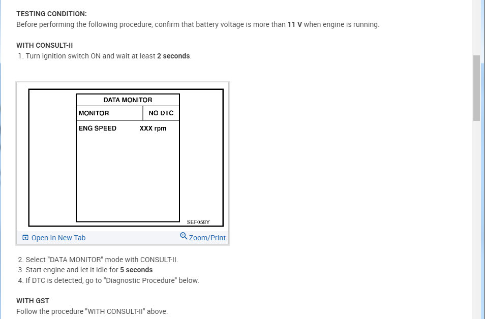

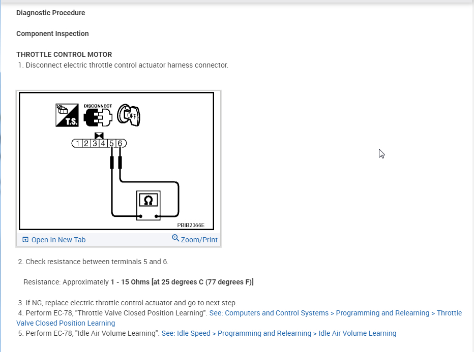

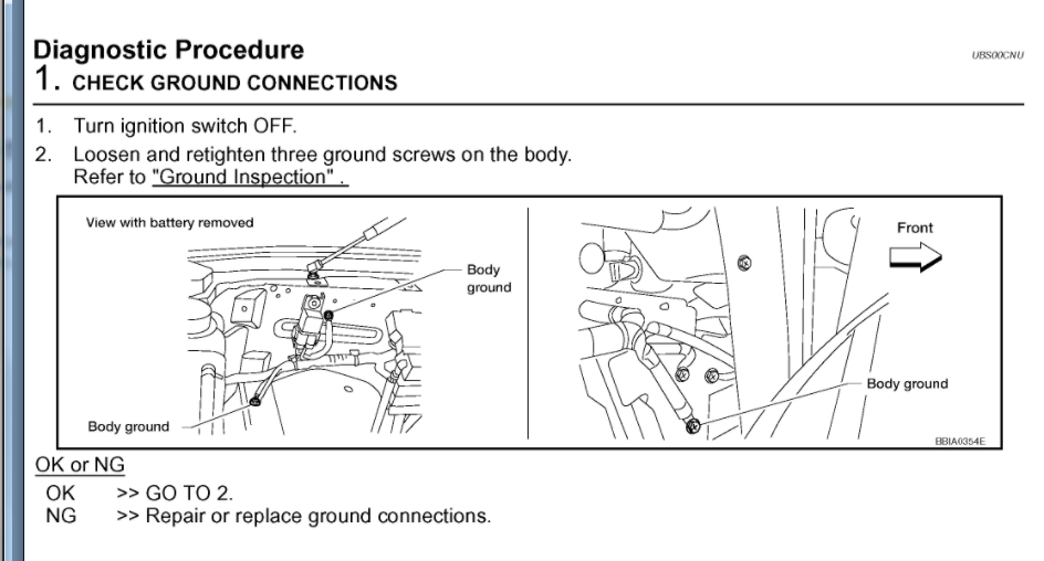

This is possible but there are a number of other things that can cause this. I attached all the testing that we need to do in order to find out what is needed. Let's run through this just to confirm but I suspect you have a wiring or throttle control actuator.
Again, let's run through this and see what we find. Thanks
