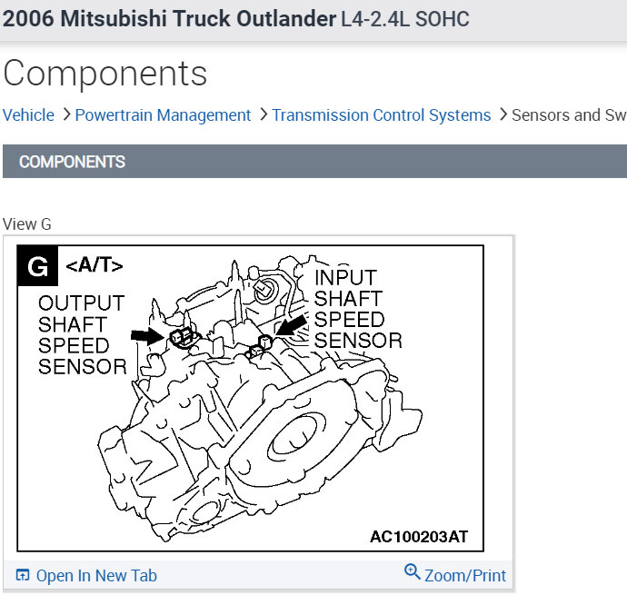

What codes are they? It sounds like the fluid is low or you have an input shaft speed sensor that is not working.
here are two guides that can help with the location of the sensor in the images below:
https://www.2carpros.com/articles/how-to-check-and-add-transmission-fluid
and
Check out the images (below). Let us know what happens and please upload pictures or videos of the problem so we can see what's going on.
