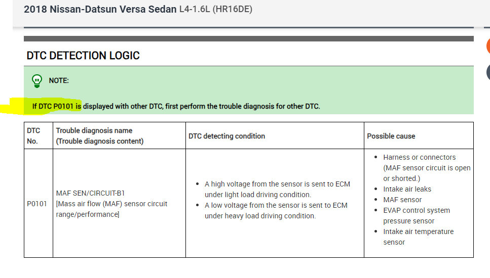

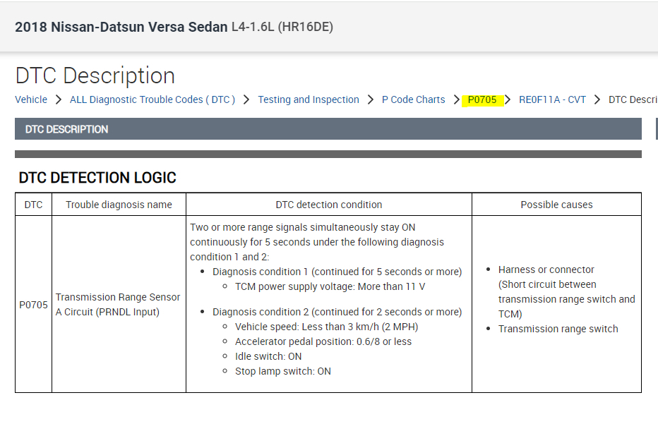

These appear to be related to two different things. I attached a general description if each one below so you can review them.
I need to know what symptoms are being experienced. Also, I need to know if this is a Versa sedan or Note
See pics below.
