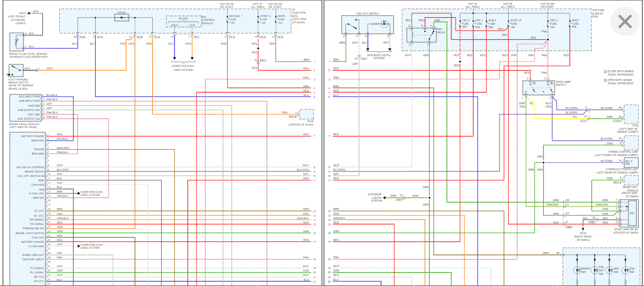

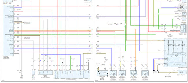

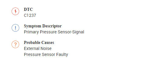

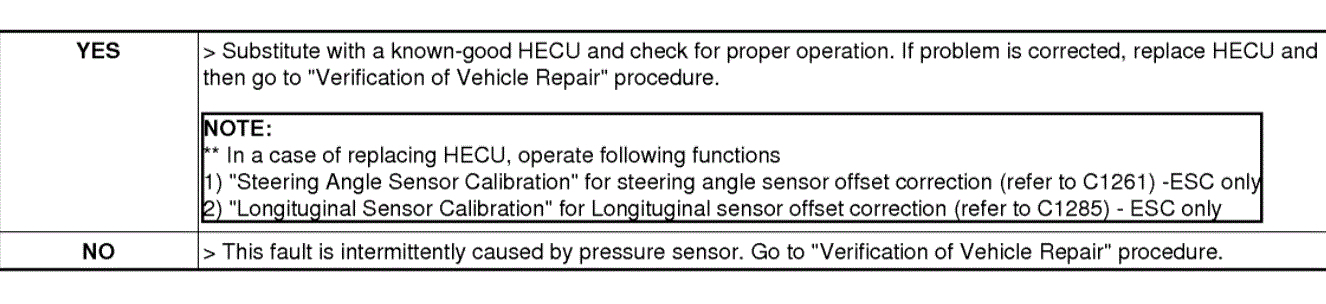

My car listed above gave me a warning message "check break.. Hybrid
System warning please stop and don't drive" after i checked the car by the computer it gave me error C1237..
Then i couldn't drive it normally, the car almost stop.. What does that error mean, and is it related to the ABS??
Your advise will be highly appreciated.
Thank you
