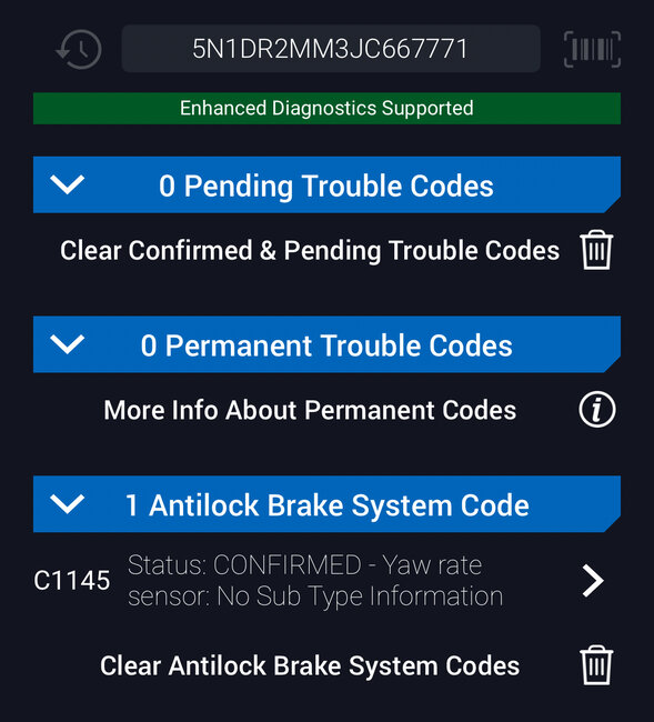

Code C1145, where is the Yaw Sensor located?
2018 NISSAN PATHFINDER
150,000 MILES • 3.5L • V6 • 4WD • AUTOMATIC
AVATRANO

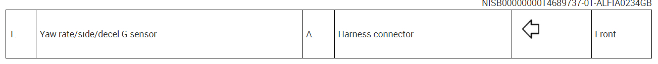

Would anyone know where the Yaw Sensor is for the vehicle listed above? (Code C1145)
Oct 1, 2024 at 5:14 AM

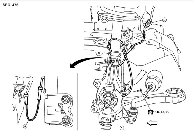

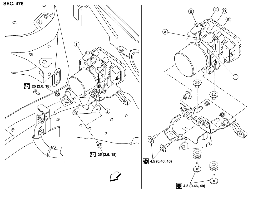

The C1145 code on your 2018 Nissan Pathfinder refers to an issue with the Right Front Wheel Speed Sensor? What makes you say Yaw sensor? Anyway, here is the location of the Yaw sensor which is integrated into the ABS control module on some models and how to change out the right front wheel speed sensor, make sure to clear the codes once the repairs are completed. Check out the images (below). Please upload pictures or videos in your response of any problems so we can see what to help you with.

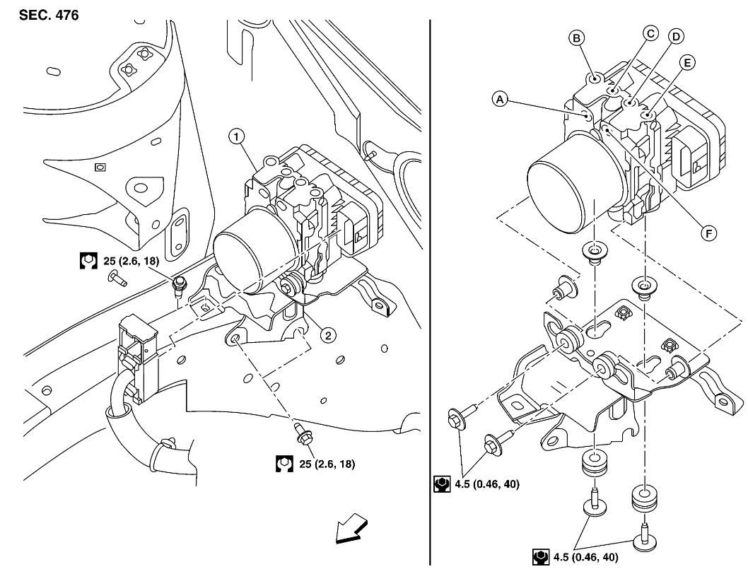

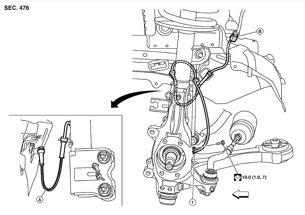

Hey, Ken. Thanks for the reply. Please see pic attached.
Oct 1, 2024 at 3:36 PM
AVATRANO

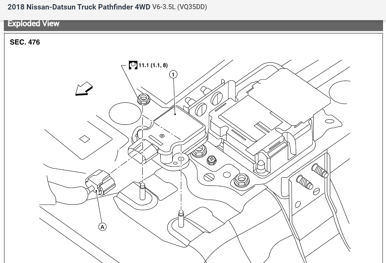

Ken, isn’t that diagram for older Pathfinders? Maybe up to 2015? That Yaw sensor that goes with the ABS module is quite different than the one I believe that I am replacing (47931-3JA0A).
Oct 1, 2024 at 4:03 PM
This information is correct by AllData. I double checked it.
Actuator - 476606KA1D - $975.38
Check out the images (below). Let us know how it goes.
