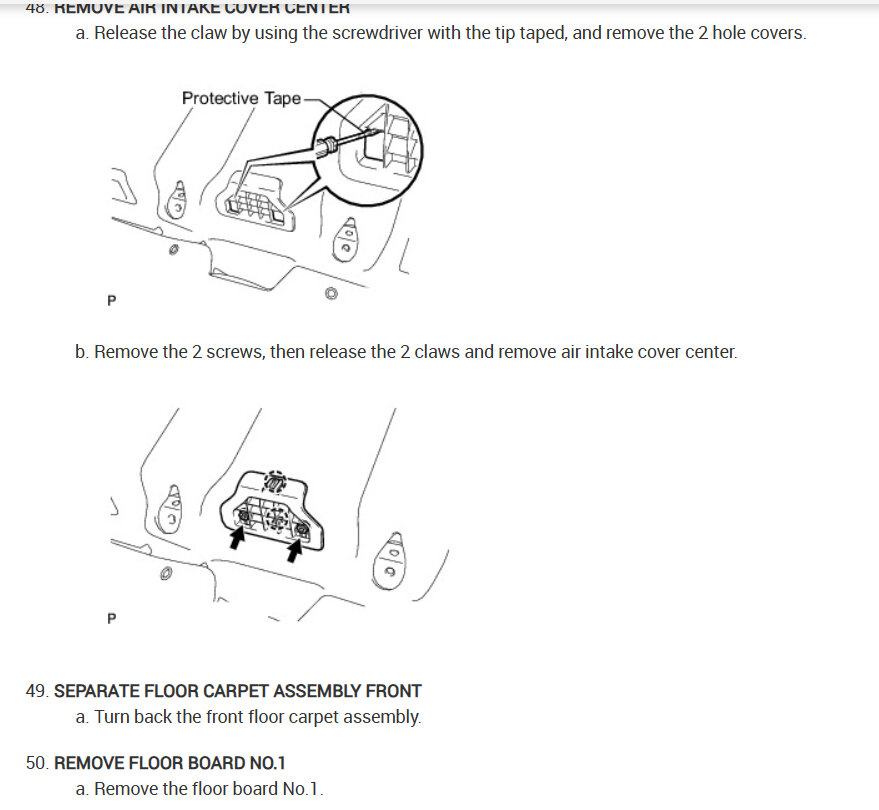

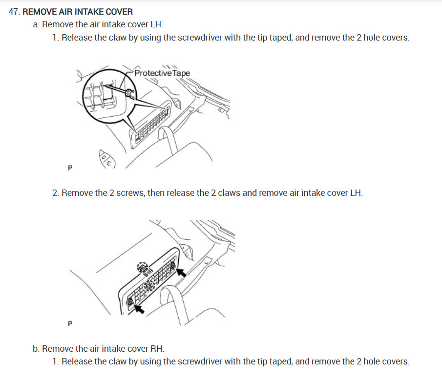

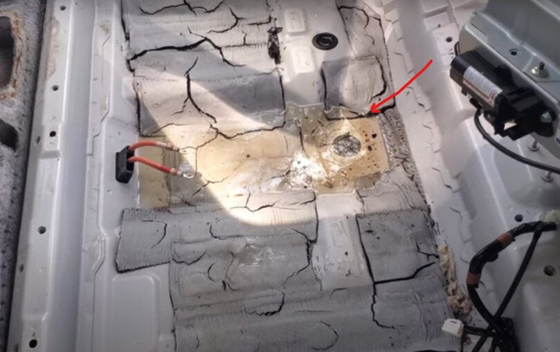

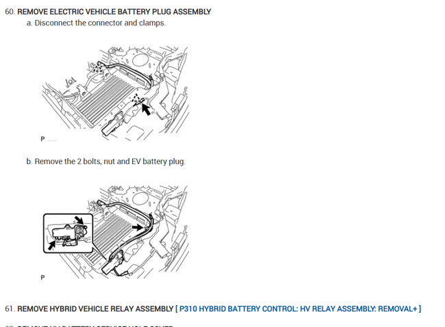

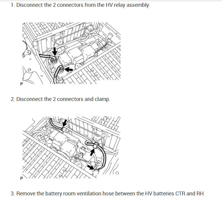

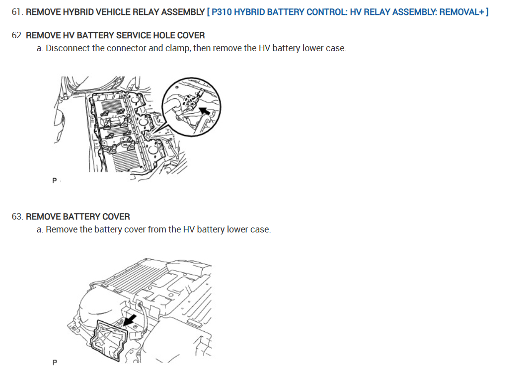

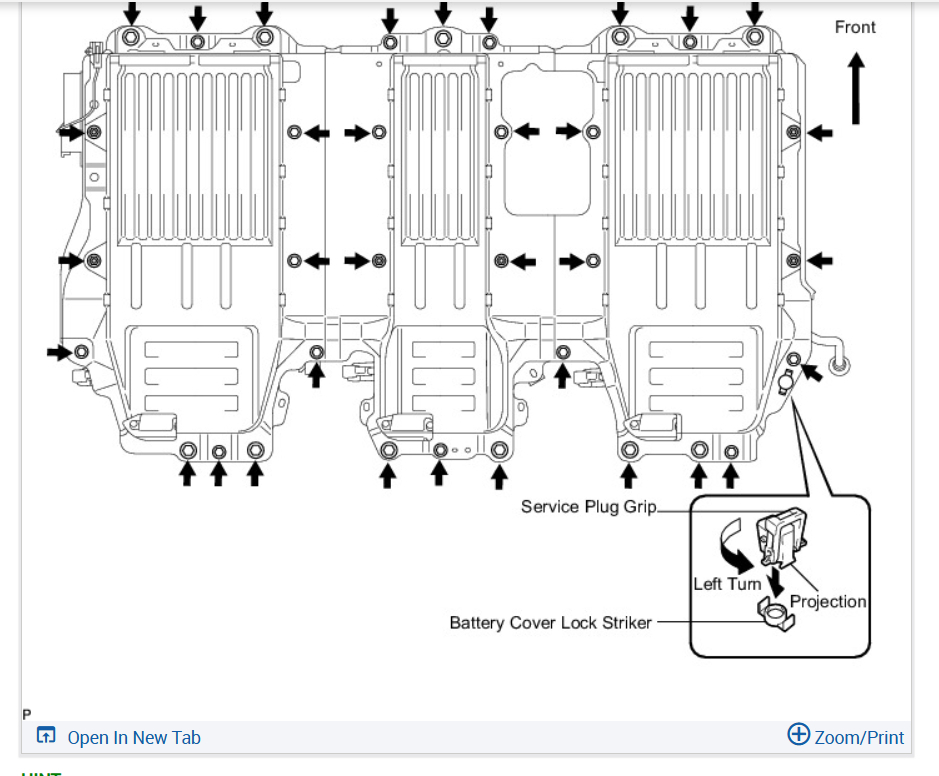

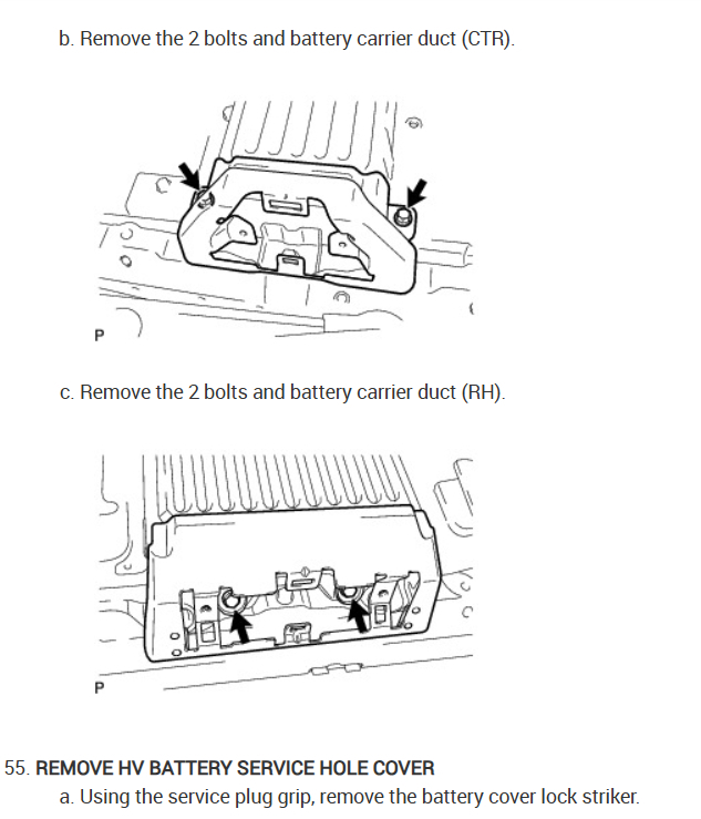

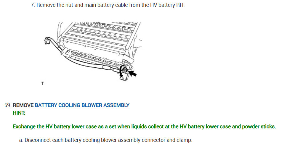

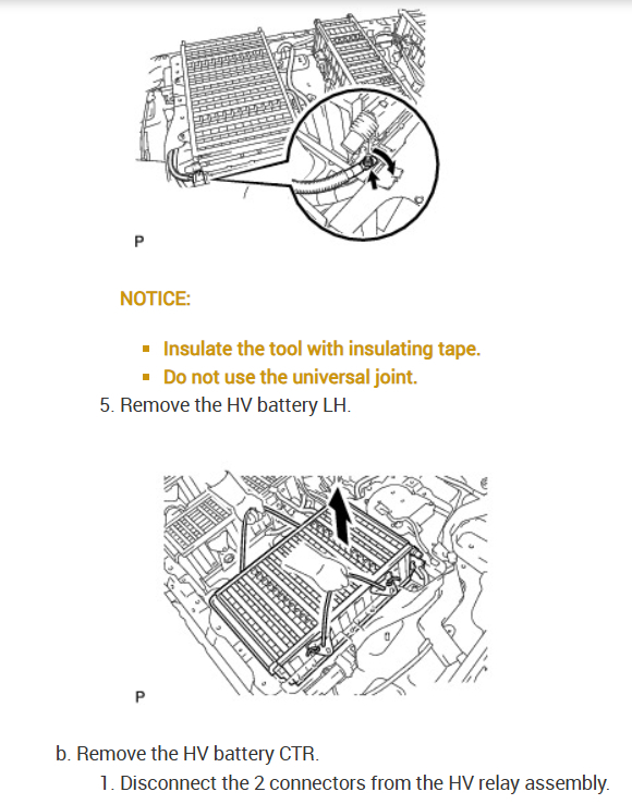

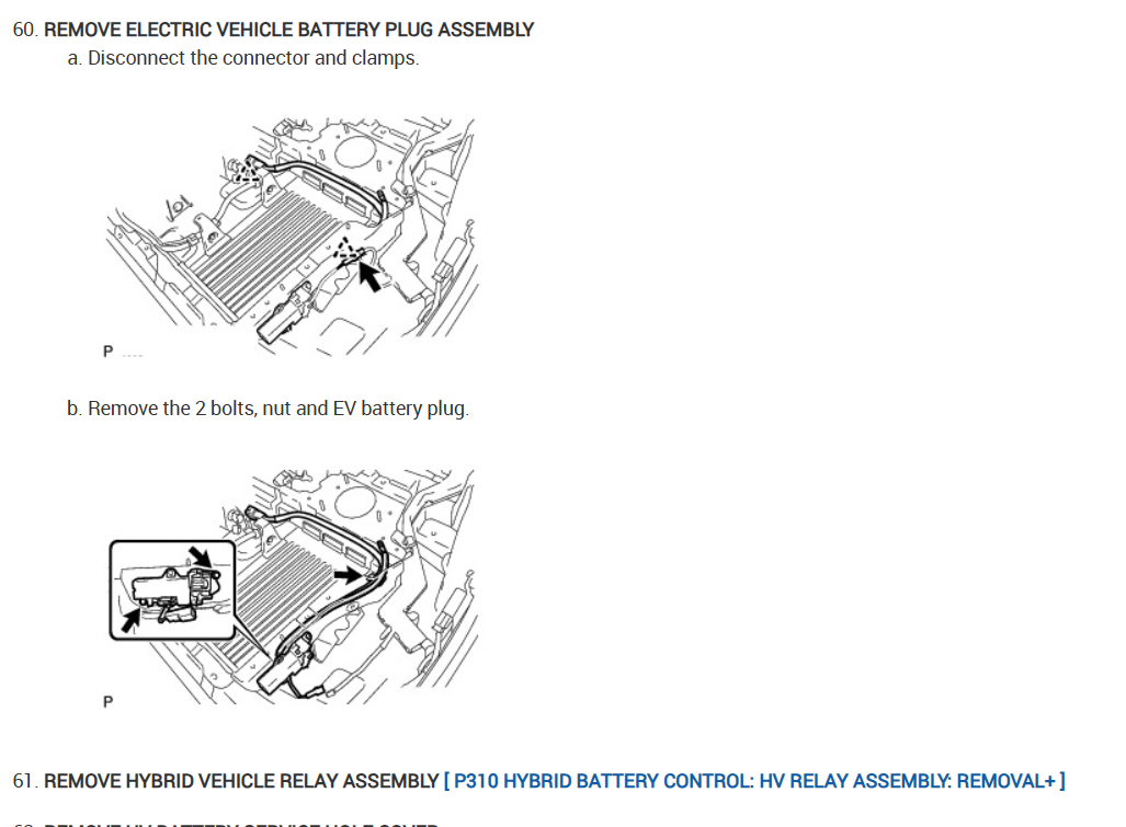

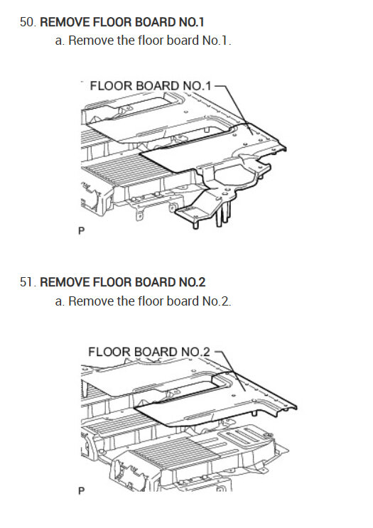

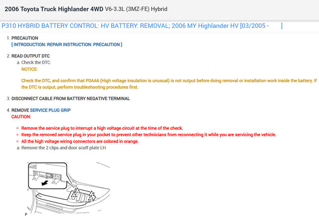

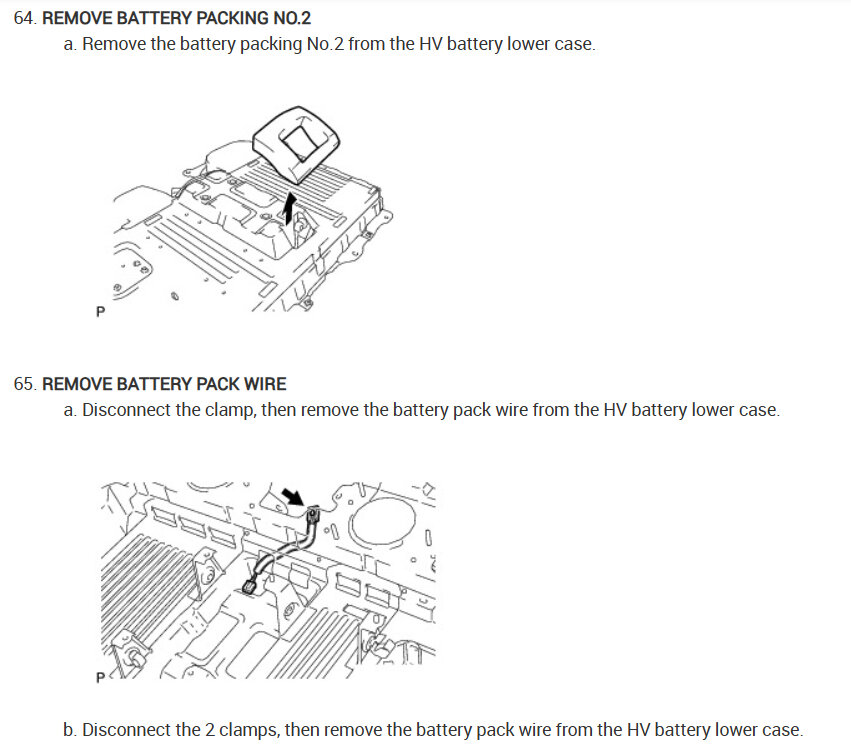

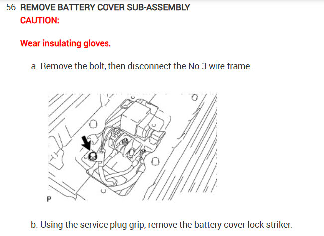

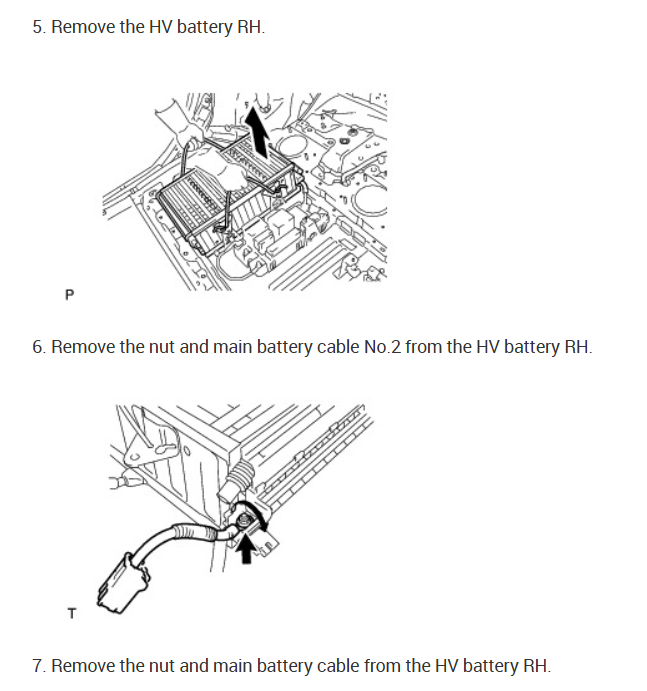

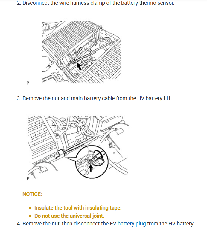

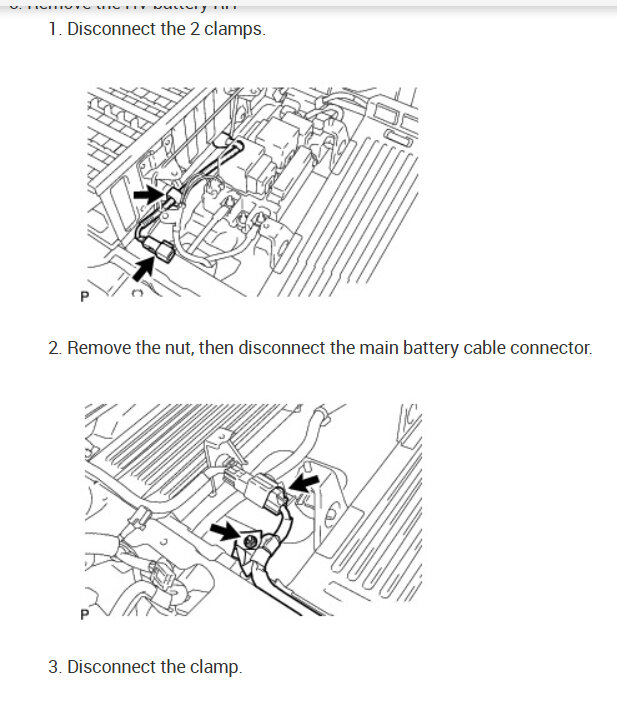

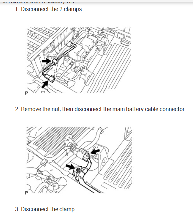

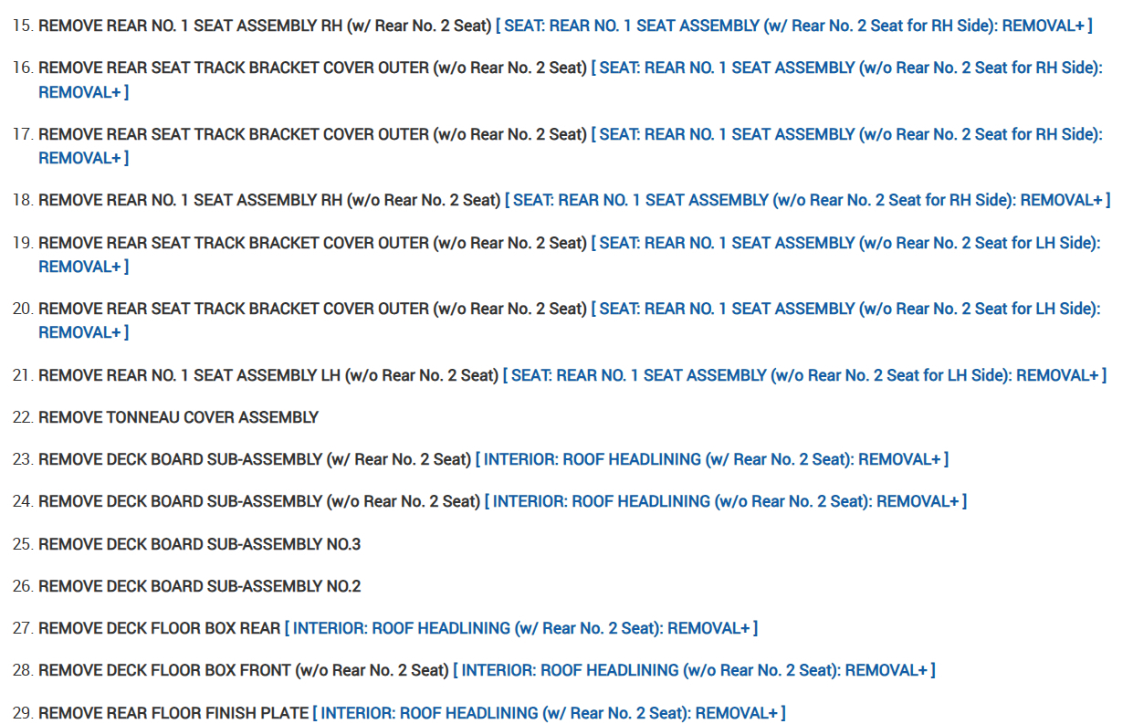

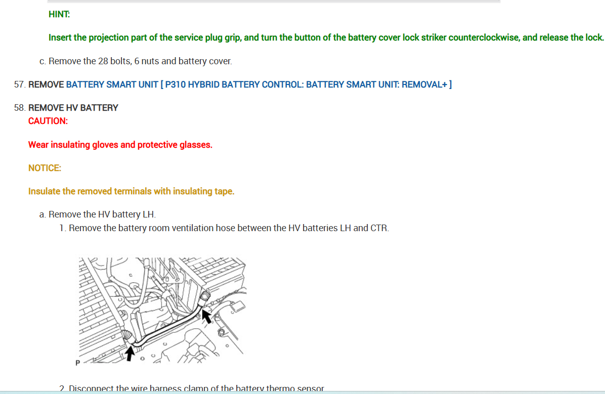

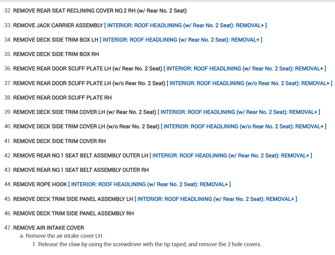

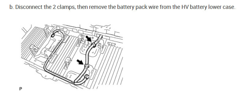

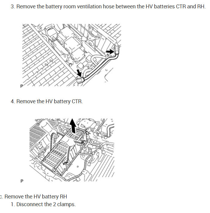

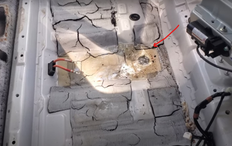

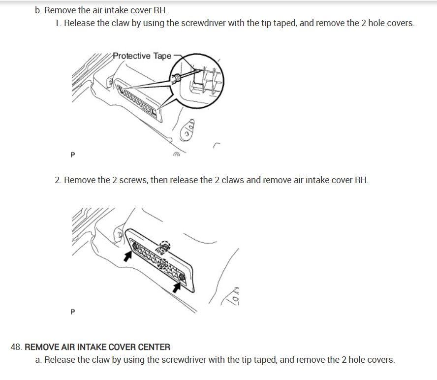

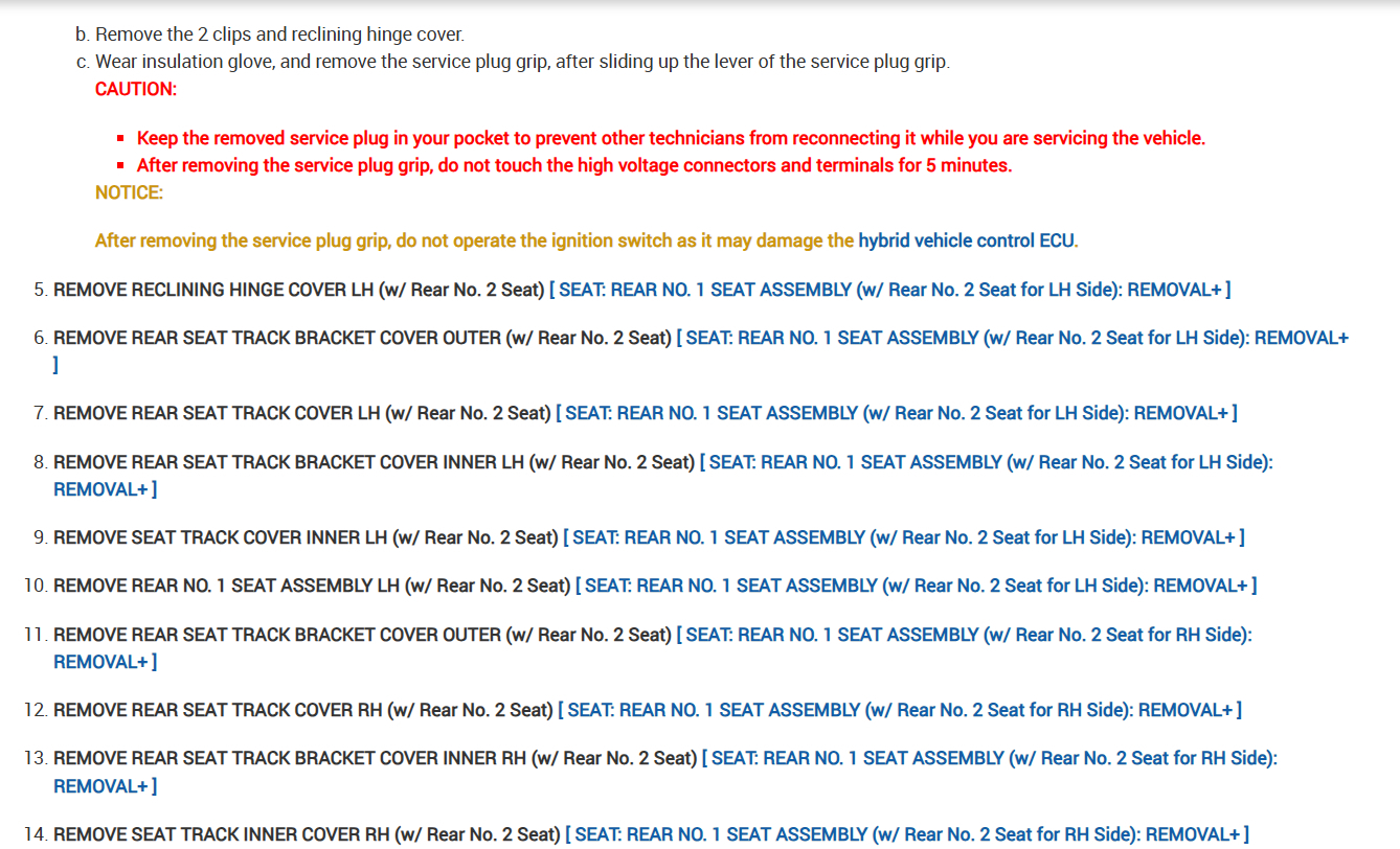

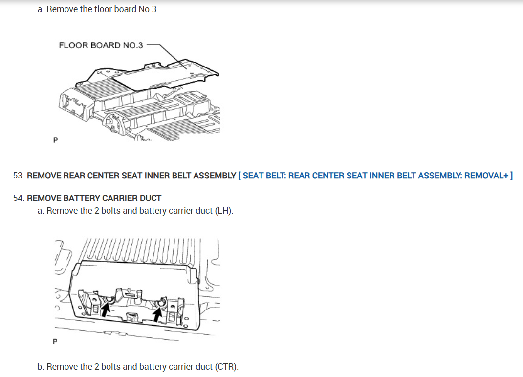

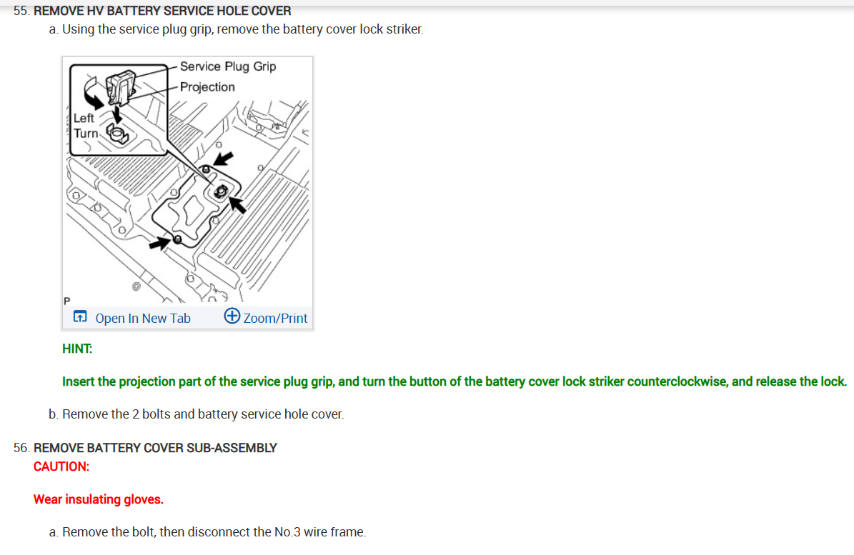

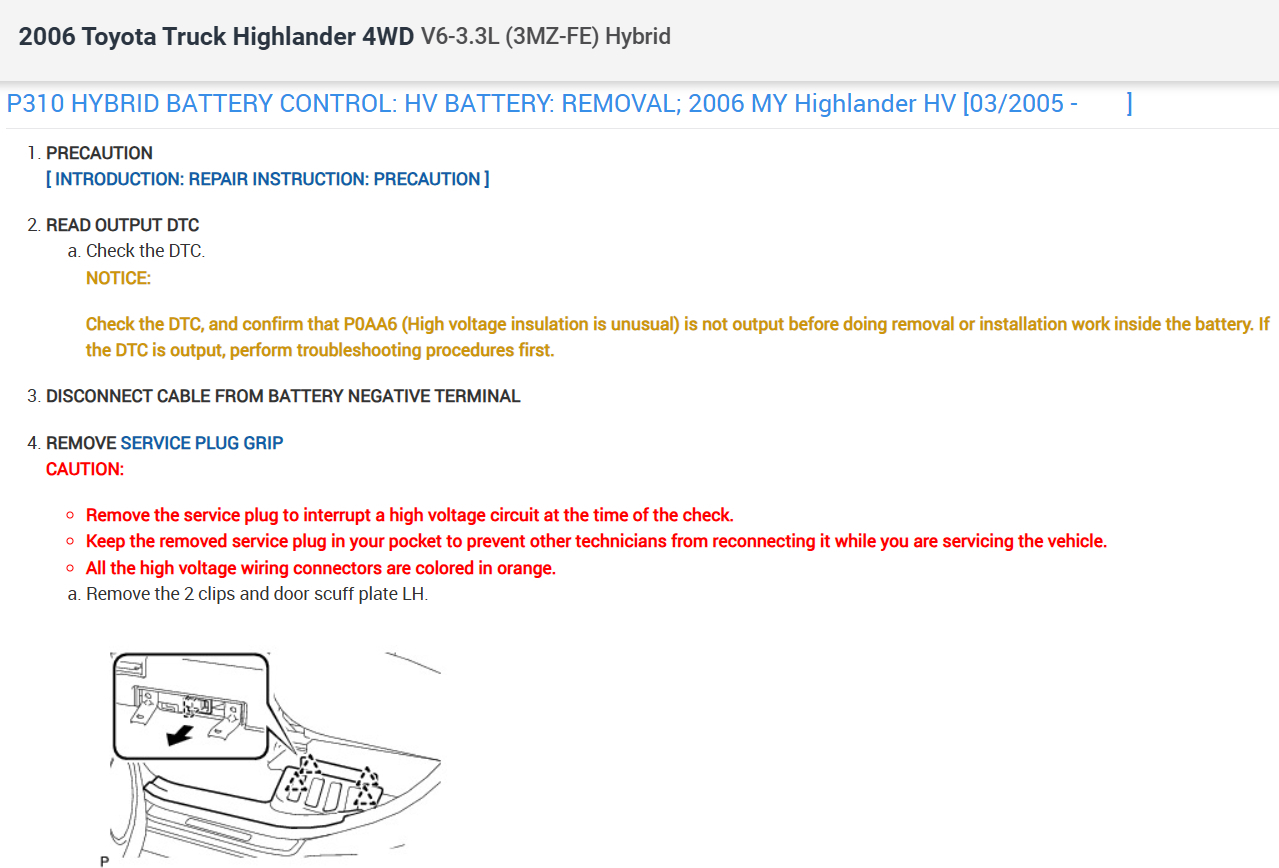

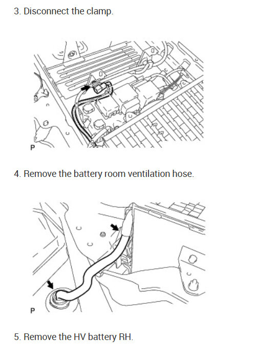

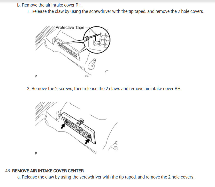

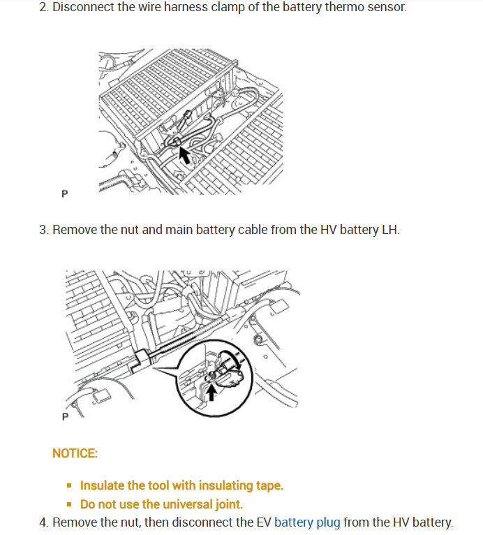

Yep, this is what happens when the hybrid battery goes bad. I am not sure what "Each one was over 10 point some volts in it" means? There has been a problem with water under the hybrid battery, check out the image below. Either way the hybrid battery will need to be removed. This is a high voltage system so wear insolating gloves and safety goggles, read the instructions completely before beginning. Be sure to clear the codes once the repair is finished. Check out the images (below). Please upload pictures or videos in your response of any problems so we can see what to help you with.
