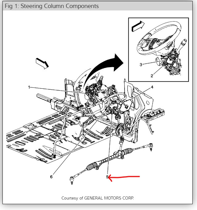

The diagnostic trouble code "C0460-5A" on a 2008 Saturn Vue is related to the steering angle sensor.
C0460: This is the generic part of the code, indicating an issue with the Steering Angle Sensor (SAS).
5A: This part of the code is a manufacturer-specific or enhanced code that provides more detail.
Here is how to change out the steering angle sensor to help you fix the problem, also when the job is complete, please clear the codes.
Steering Angle Sensor Centering
The steering angle sensor does not require centering often. Centering of the steering angle sensor might be required after certain service procedures are performed. Some of these procedures are as follows:
* Steering gear replacement
* Steering column replacement
* Steering angle sensor replacement
* Intermediate shaft replacement
* Antilock brake system (ABS) controller replacement
* Collision or other physical damage
The steering angle sensor centering procedure can be preformed with a scan tool in the automated center procedure by the following:
1. Using the steering wheel, align the front wheels forward.
2. Set the transmission in the PARK position.
3. Install the scan tool to the data link connector (DLC).
4. Turn the ignition switch ON, with the engine OFF.
5. Select Vehicle Control Systems/Module Setup/EBCM/Steering Pos. Sensor Calibration.
6. Follow the scan tool directions to complete the automated centering procedure this should include turning the steering wheel left 5 degrees and right 5 degrees and then straight forward.
7. Clear any DTCs that may be set. Perform the Diagnostic System Check to verify no current DTCs. Refer to Diagnostic System Check - Vehicle (See: Vehicle > Initial Inspection and Diagnostic Overview) .
8. Centering of the steering angle sensor is complete.

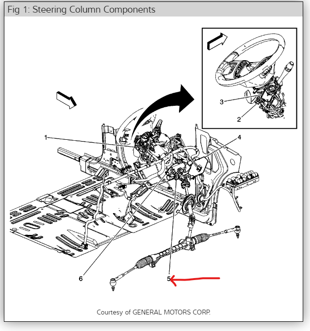

The sensor is at the base of the steering column. Check out the images (below). Please upload pictures or videos of the problem so we can see what's going on.
