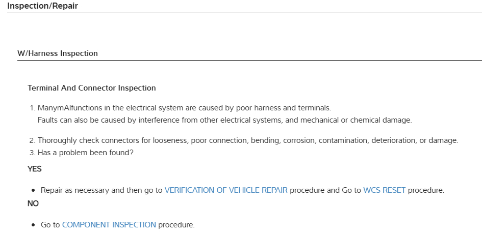

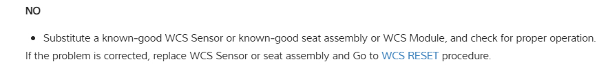

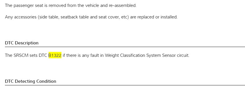

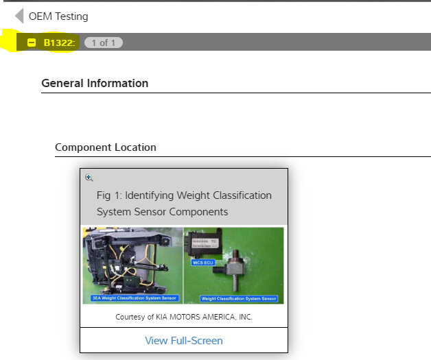

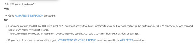

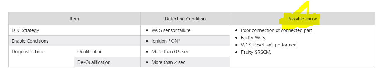

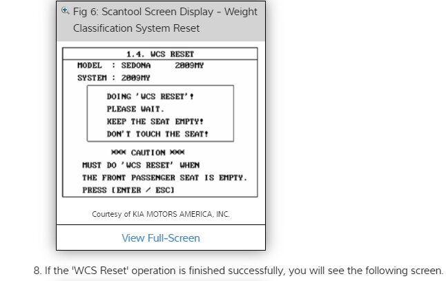

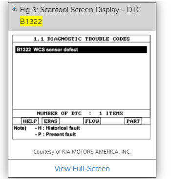

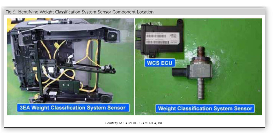

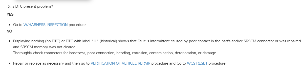

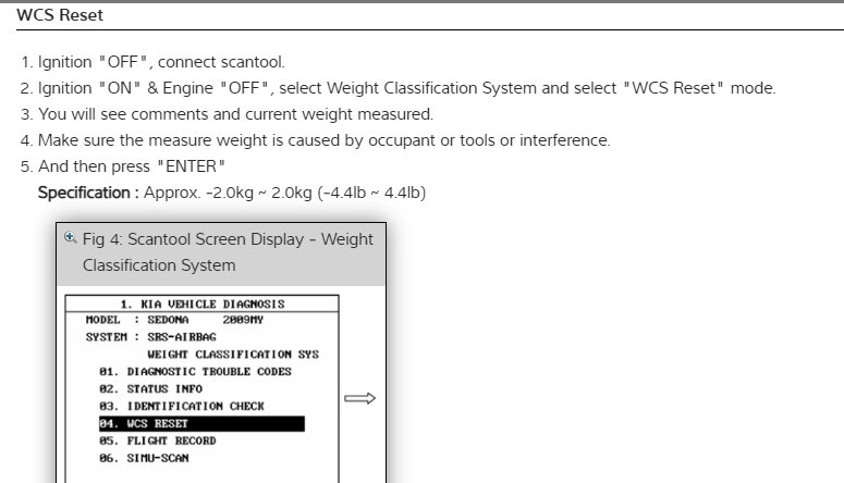

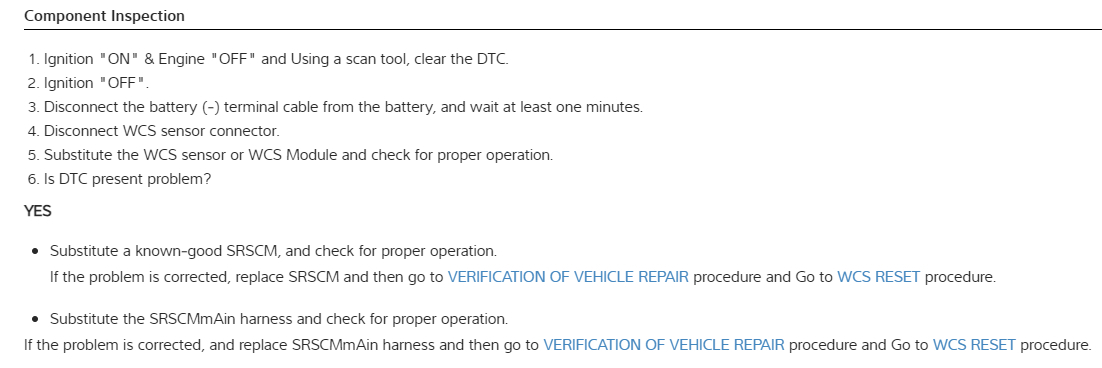

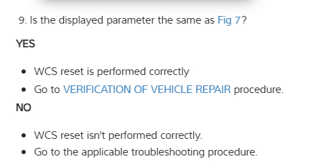

I lightly clipped an empty garbage can yesterday with my right headlight. Cracked the headlight but thought that was it. Then I noticed my airbag light was on. My Bluedriver scanner shows code B1322. I've briefly seen the light pop on in the past for like 30 seconds then shut back off. Was extremely rare but I have seen it. And whenever I did a deep OBD scan with my Bluedriver it showed it, but the light never stayed on in the past.
