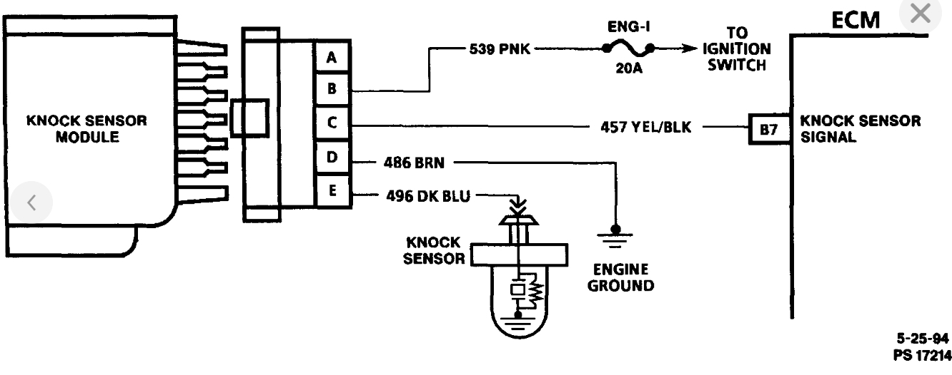

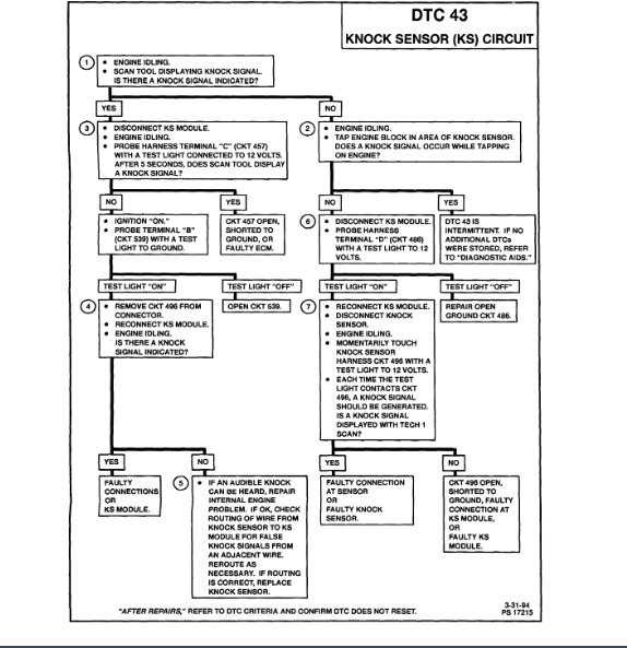

I attached a description below and a flow chart for determining the failure. The module is a common failure on the intake manifold.

DTC CHART TEST DESCRIPTION
Number(s) below refer to circled number(s) on the diagnostic chart.
1. If the conditions for a DTC 43 are present, the Tech 1 scan tool will always display "YES." There should not be a knock at idle unless an internal engine problem, or a system problem exists.
2. This test will determine if the system is functioning at this time. Usually a knock signal can be generated by tapping on the right exhaust manifold. If no knock signal is generated, try tapping on block close to the area of the sensor.
3. Because DTC 43 sets when the signal voltage on CKT 457 remains low, this test should cause the signal on CKT 457 to go high. The 12 volts signal should be seen by the ECM as "no knock" if the ECM and wiring are OK.
4. This test will determine if the knock signal is being detected on CKT 496 or if the KS module is at fault.
5. If CKT 496 is routed too close to secondary ignition wires, the KS module may see the interference as a knock signal.
6. This checks the ground circuit to the module. An open ground will cause the voltage on CKT 457 to be about 12 volts which would cause the DTC 43 functional test to fail.
7. Connecting CKT 496 with a test light to 12 volts should generate a knock signal. This will determine if the KS module is operating correctly.

DTC 43 can be caused by a faulty connection at the knock sensor at the KS module or at the ECM. Also check CKT 457 for possible open or short to ground.
