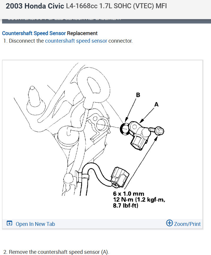

These codes will come up when the input shaft speed sensor (countershaft) goes out, if the speedometer is working then the output sensor is working just fine.

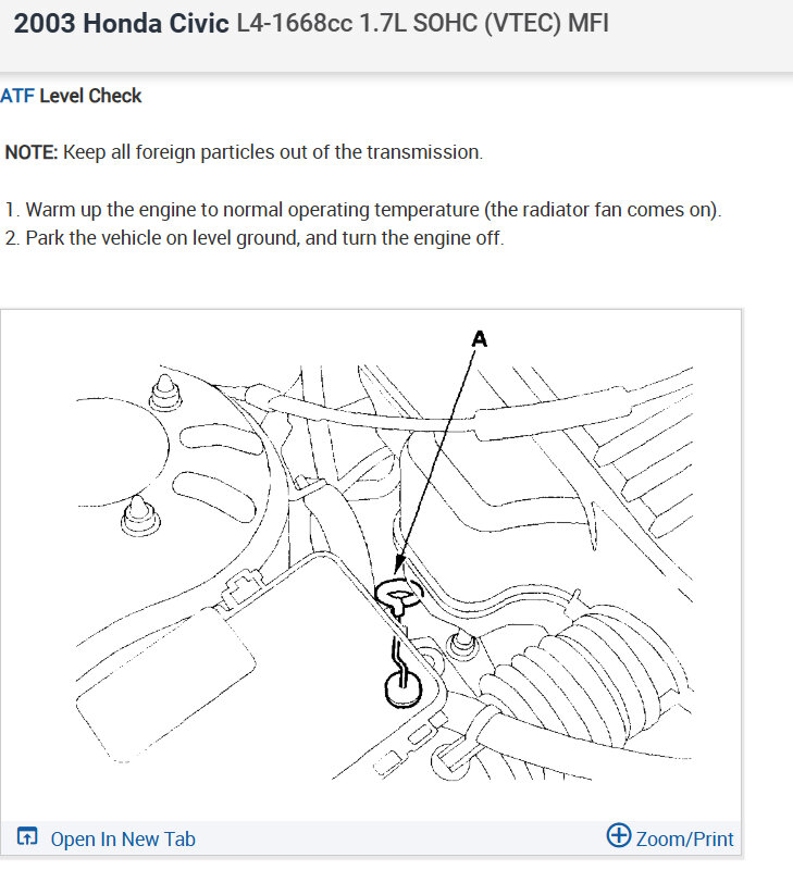

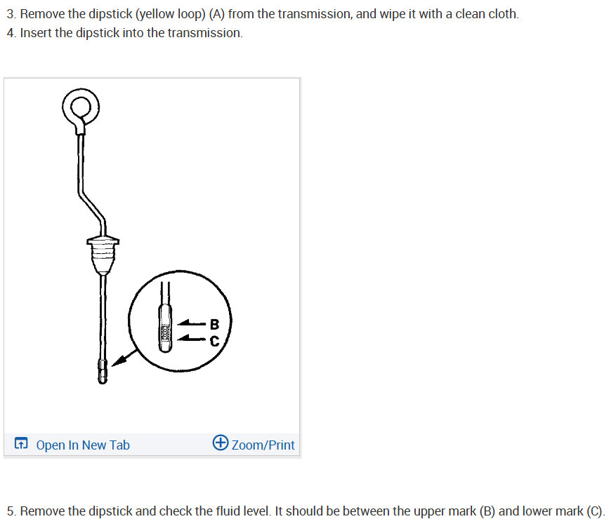

Here is the sensor location so you can swap it out, also check the fluid level and smell if it is burnt or not? Clear the codes once the repair is completed. Check out the images (below). Please let us know what happens.

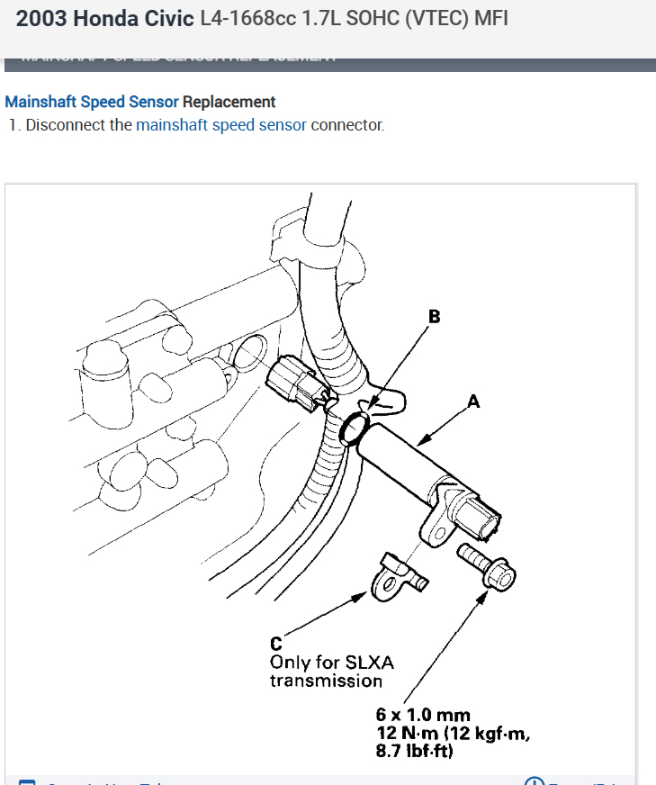

Yes, this is the sensor I swapped out. From the diagrams you sent me. After I drove it the let me pass the 20-25 MPH but then it slips at 30-30 MPH now. Where would the other sense be located so I can try and swapping that one?

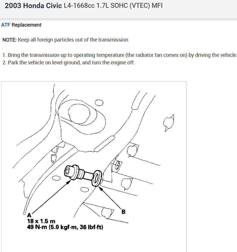

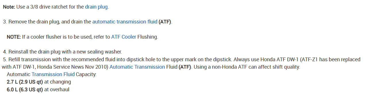

If the speedometer is working the output sensor may not help. Can I ask about the transmission fluid condition, is it burnt? You said you already replaced the output shaft sensor? Anyway, here is the location, I would try changing out the fluid as well. It may be giving these codes because the transmission is burnt up and needs replacement. FYI. Check out the images (below). Please let us know what happens.
