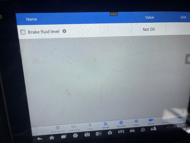

code 480932, brake fluid level?
2013 BMW 535
165,000 MILES • 6 CYL • TURBO • 2WD • AUTOMATIC
BHAMDOC1973
  • 2,008 POSTS
I checked the level, and the connector, removed the cap and the leveler moves freely, but it won't reset via the scanner to the car BD stalk. What else could this be?

Here

No ground or power to the 2-wire connector. Do you think there is a fuse for it?
May 22, 2025 at 6:46 AM
I would ground the brn/green-yellow wire to see if the warning goes away, if so replace the level sensor/brake master cylinder.
May 22, 2025 at 11:37 AM
BHAMDOC1973
  • 2,008 POSTS
Hmm, strange, the regular test light which I hardly use gave me no power or ground, even though I tested the bulb and was working, but after you mentioned the above I found my probe and I checked and found power (+) on one side and then power again the other side, but when I applied negative using the probe the scanner showed that the fluid level is okay and all lights went off...Let me ask you this, can I ground that wire to the body until I get the cap/plunger? I just need to drive it till then and without that the traction will be on as well, and maybe the ABS, so I want to drive it just enough until I get the cap.
May 22, 2025 at 1:16 PM
Yep, you sure can, but please fix it correctly before it goes out the door, have a good weekend!
May 23, 2025 at 11:04 AM
BHAMDOC1973
  • 2,008 POSTS
Just received the cap quickly somehow via Amazon, installed it and all was good! Thanks
May 23, 2025 at 11:13 AM
Glad you could get it fixed, thanks for letting us know.
