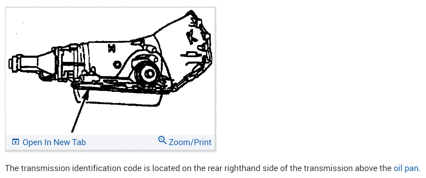

As far as the code is concerned, yes it deals with the knock sensor. I started looking up diagnostics for you but was stopped. I need to know the transmission model in the truck. One is an electric shift 4L60E and the other isn't electric. They point me in different directions.
Also, let me know if you are experiencing any drivability issues. Do you ever notice ticking or valve ping? Is there a loss of power?
If you aren't sure about the transmission, see pic 1 below and let me know what you find.
See pic below.

I believe it is the 4L60E transmission. I crawled under it the connector was disconnected from knock sensor. I reattached it yesterday and the code went away, and the knock sound went away. I hit a bump today and the light came back on. I guess the question now is should I replace the connector or the knock sensor. Thanks.
