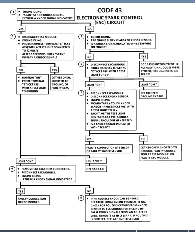

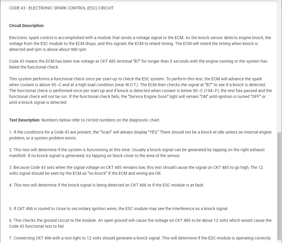

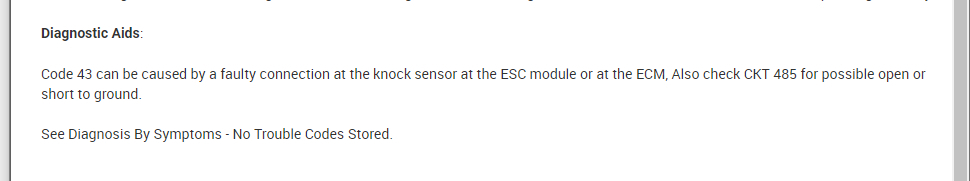

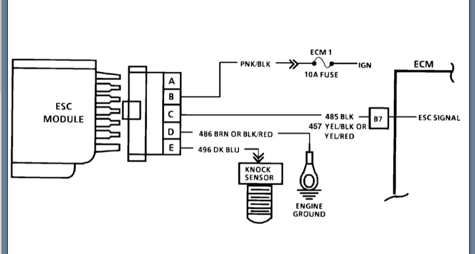

This is a knock sensor code so here are a few guides that will help with getting us started:
https://www.2carpros.com/articles/buick-cadillac-chevy-gmc-oldsmobile-pontiac-gm-1983-1995-obd1-code-definitions-and-retrieval-method
https://www.2carpros.com/articles/how-a-knock-sensor-works
Below you will find the testing from the manual that we need to run through to figure out what the possible cause is of this.
Please let us know what questions you have. Thanks

In the diagram to check the ESC module, when it says "scan" what exactly does that mean?
Jun 24, 2021 at 5:46 PM
This means the scan tool is be set on the knock sensor info to monitor voltage. Basically it just wants you to see if the sensor is sending a signal that the PCM is seeing.
if you don't have this, I would just test it both ways and that will tell you which it is. So start with assume that it does so you answer it yes and move to the next step. Then run through that test until you get to a failed part. Then do the same thing with answering no and see what it leads to.
Let me know if you have questions on this. Thanks
