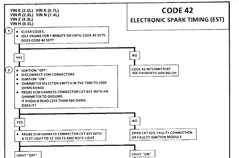

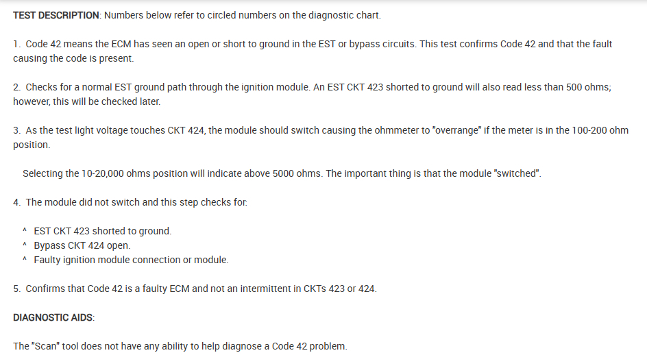

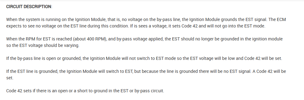

Engine runs rough and a knock while under load. It all started when I got gas last week as soon as I left the gas station. In neutral I can rev the motor hard, and you can barely hear the knock at high RPMs. I replaced the spark plugs (A/C Delco) and the misfire went away for 10 minutes or so but it's now skipping again. I'm pretty sure it's loading up on the left bank (1,3,5,7). I'm hoping the knock is a spark knock and not a writ pin. Any help would be great. Thanks
