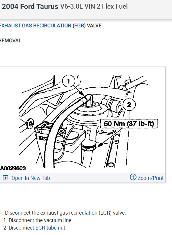

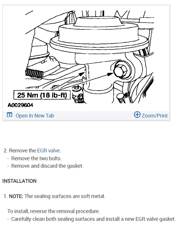

Also, it looks like the EGR valve passages are clogged. I would remove the EGR and inspect the passages, also it can be a bad EGR valve. This video can help you test it:
https://youtu.be/DqUCbbKdWf4?si=6GCcXq7zVoGjNu2I
Check out the images (below). Please upload pictures or videos in your response of any problems so we can see what to help you with.
