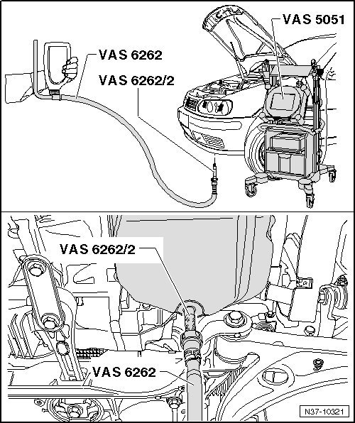

Before doing anything, make sure the trans fluid is full. If this has happened since the service, I have a feeling you will find the fluid is between 2 and 3 quarts low. If it is, make sure you use the correct fluid.
If this is the 6 speed automatic, here are the directions for checking fluid level. The attached pics correlate with these directions.
__________________________________________________
2008 Volkswagen New Beetle (1C1) L5-2.5L (BPR)
ATF Level, Checking
Vehicle Maintenance Fluids Fluid - A/T Service and Repair Procedures 09G, 6 Speed A/T ATF Level, Checking
ATF LEVEL, CHECKING
ATF Level, Checking, 09G, 6 Speed A/T
Special tools, testers and auxiliary items required
^ Torque wrench V.A.G. 1331
^ Used oil collection and extraction unit V.A.G. 1782
^ Vehicle diagnosis, testing and information system VAS 5051
^ Drip tray for workshop hoist VAS 6208
^ Adapter for filling oil VAS 6262
^ Adapter VAS 6262/2
pic 1

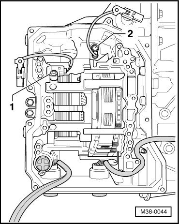

If a test temperature between 35°C and 45°C is displayed:
pic 2
- Remove ATF inspection plug from oil pan.

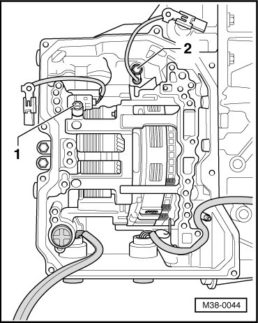

- With engine "running", install adapter for filling oil (VAS 6262/2) hand-tight.
pic 4
- Add 1 l of ATF.
- Pull off adapter for oil filling (VAS 6262) at quick-release connection and check:

As far as the output speed sensor, you need to remove the valve body to access it. Here are the directions.
Transmission Output Speed Sensor
Vehicle Powertrain Management Transmission Control Systems Sensors and Switches - Transmission and Drivetrain Sensors and Switches - A/T Transmission Speed Sensor Service and Repair Removal and Replacement 09G Transmission Transmission Output Speed Sensor
TRANSMISSION OUTPUT SPEED SENSOR
Removing
- Remove valve body => [ Valve Body ] See: Valve Body, A/T > Removal and Replacement > Valve Body.
- Remove bolt - 2 - of Transmission Output Speed (RPM) Sensor (G195).
pic 6
- Remove sensor from housing.
