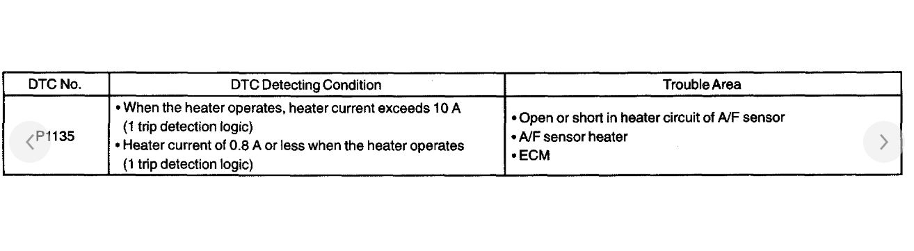

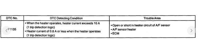

I have changed the A/F sensor and o2 sensor and did an evap leak test and still getting the p1135 code back as soon as i clear it. I have also changed MAF sensor, spark plugs and coil packs. My car turns and then warmed up it starts to go under 700 rpm's and sputtering.I ran out of trouble shoots.
