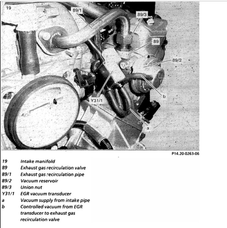

Do you have a video for removal and cleaning of EGR related issues?
Thanks.
May 8, 2018 at 10:20 AM
We do not have a video, but I did find this diagrams showing the EGR and how to remove it. To clean it use carburetor cleaner, coat hanger and shop towels.
