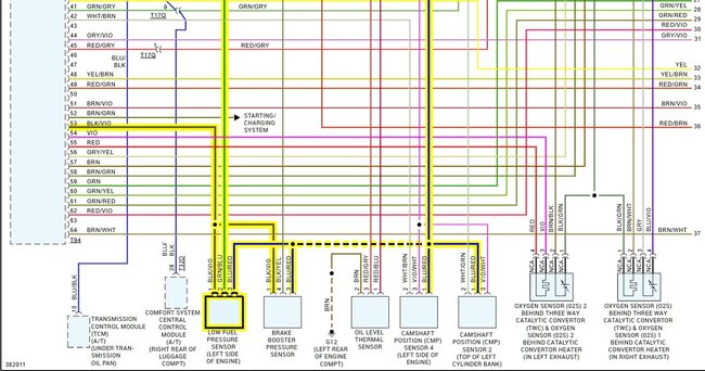

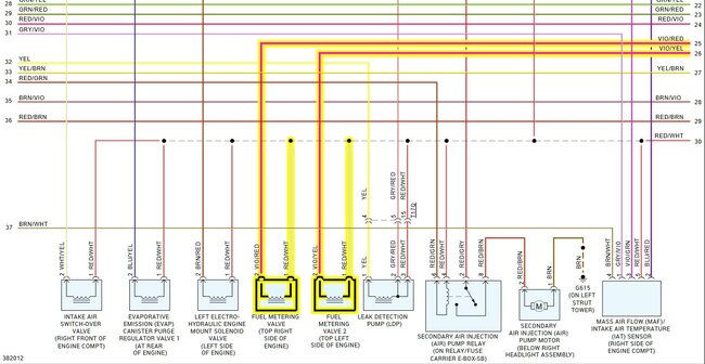

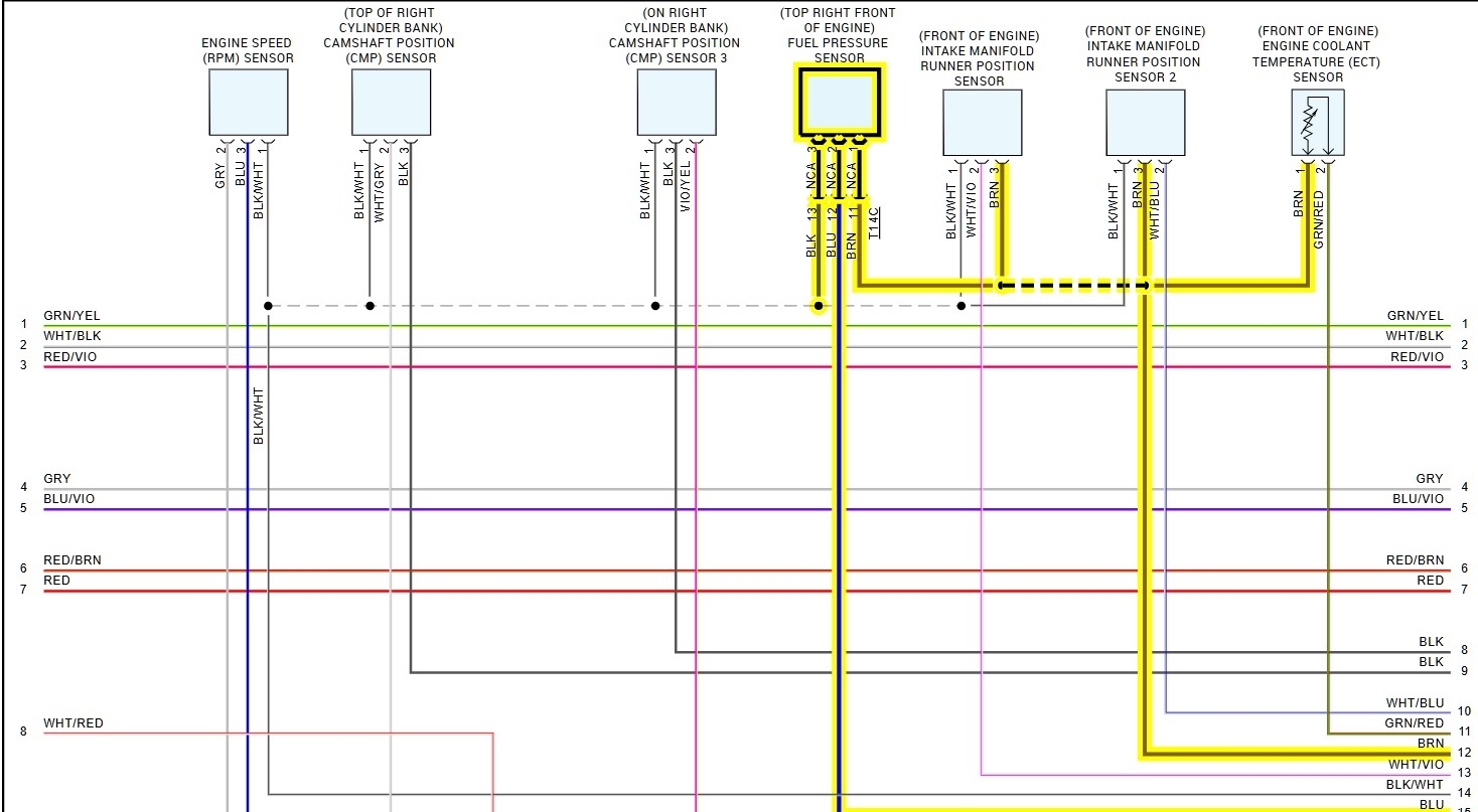

Hello, yeah you should be able to see the "Fuel Pressure" reading that will be somewhere around 60-80psi, this is the low side pressure. The High pressure fuel spec at idle is usually somewhere between 400-1800psi depending on engine's load and demand. What is the exact code number you are getting? The code's extra numbers (more than just the 4 digits) can give a little more direction as to what the ECM is coding for. Are you getting any other codes? Ill get the wiring diagrams so you can check the 5v reference at the high pressure fuel sensor.

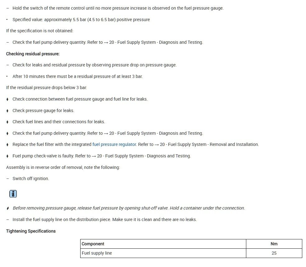

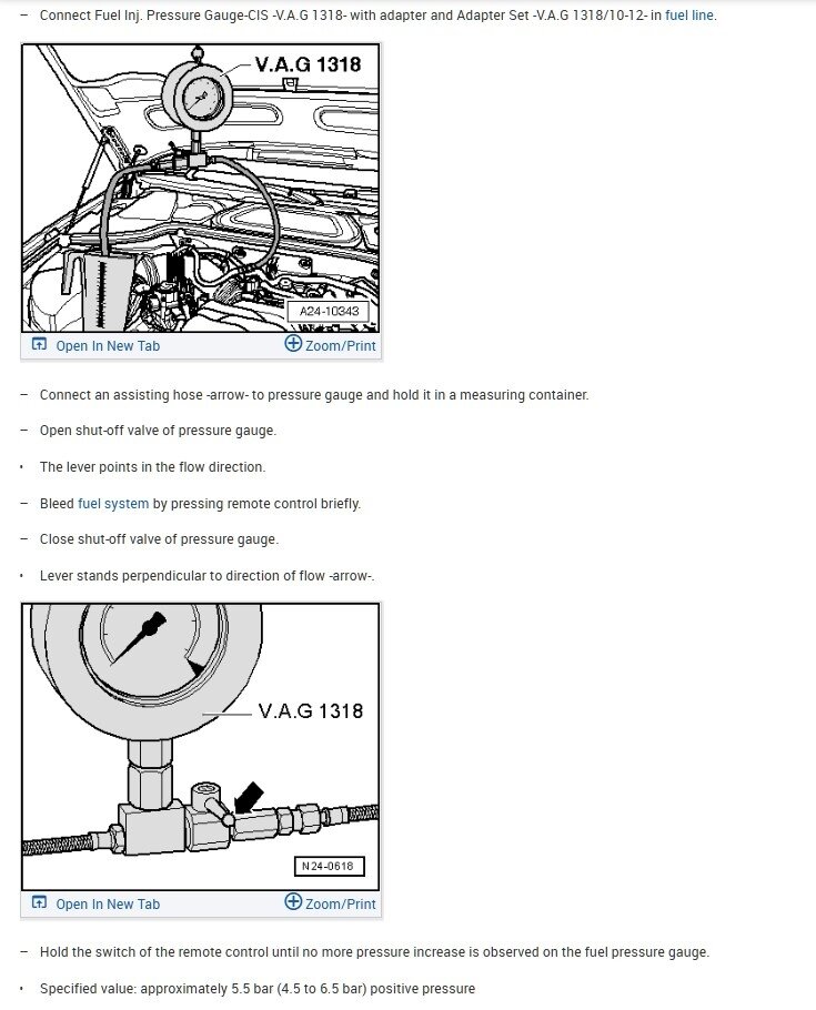

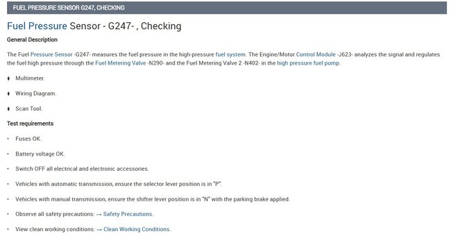

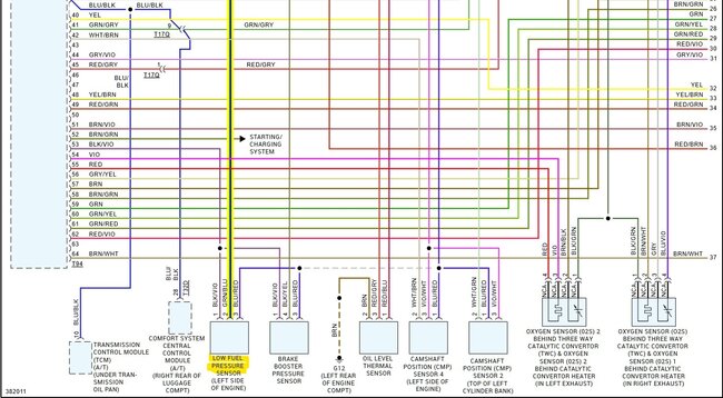

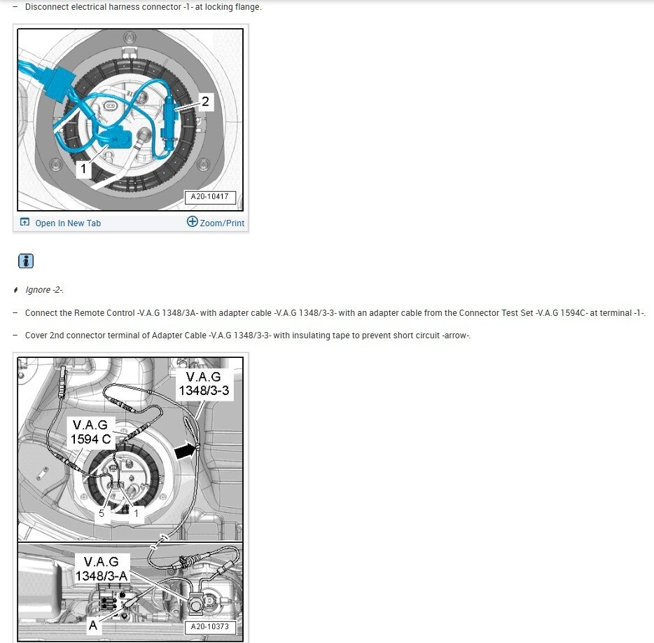

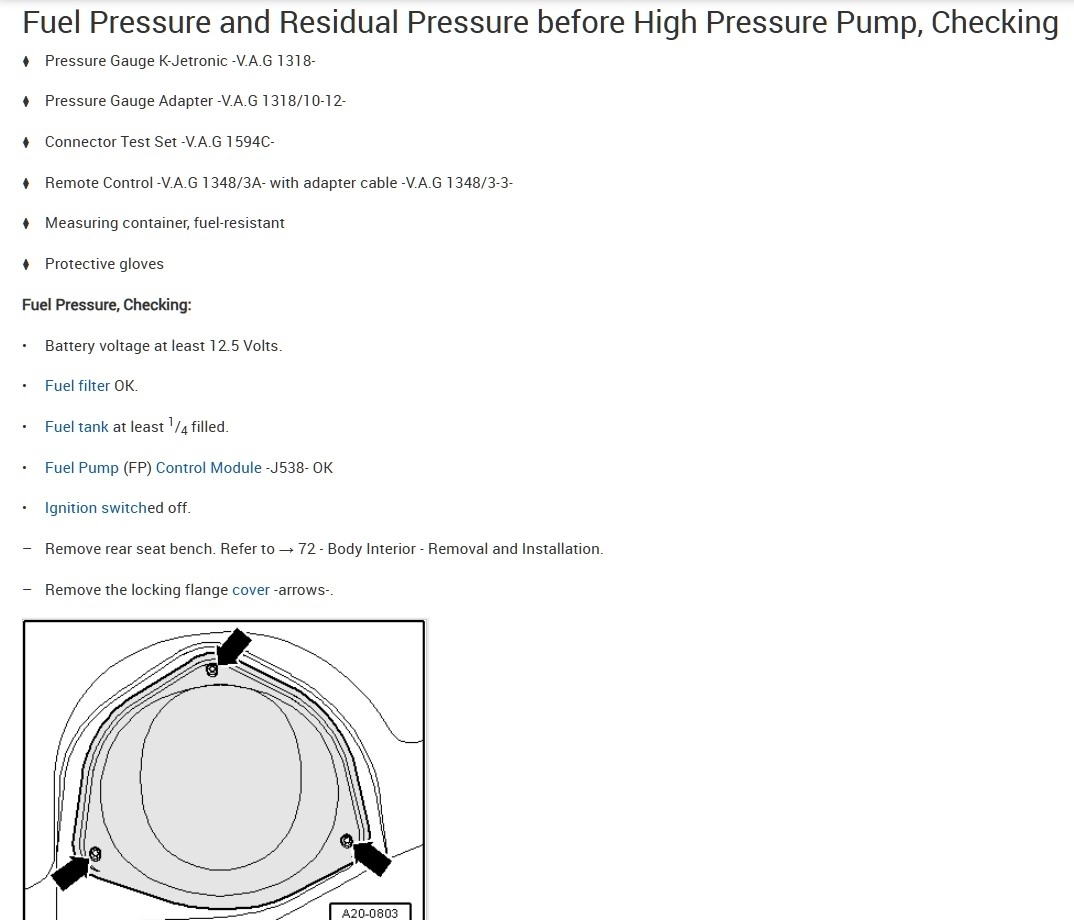

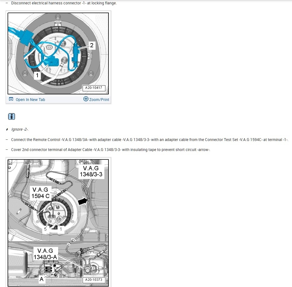

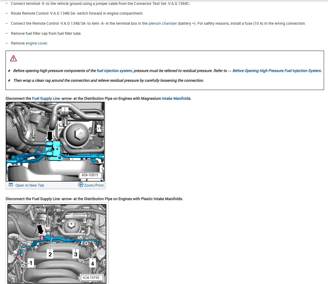

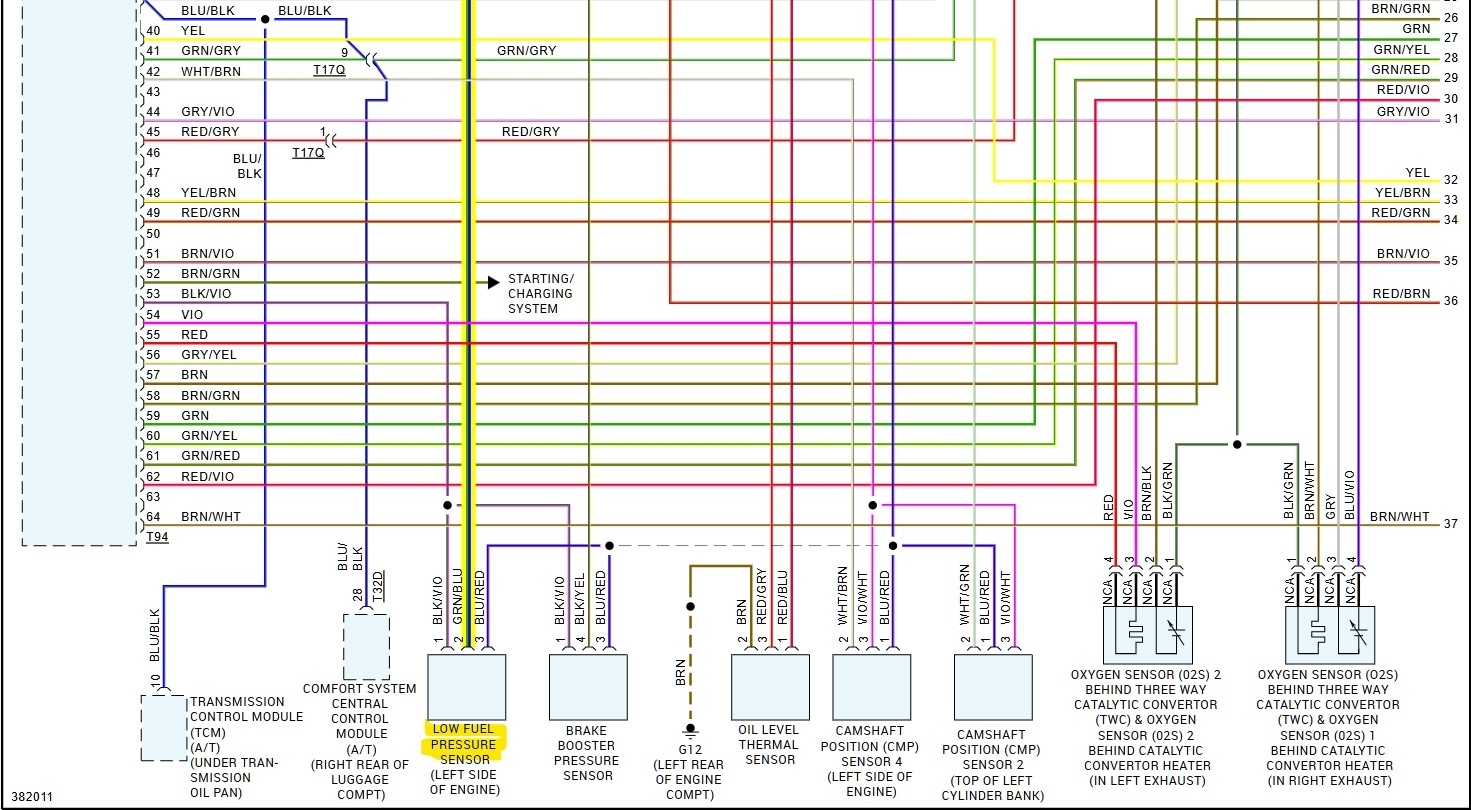

There is a flow chart for checking the High Pressure fuel sensor ill post here. If this is the actual fault, but issues with the low side of the fuel pressure system will obviously cause issues on the high pressure side since its the feed for it.

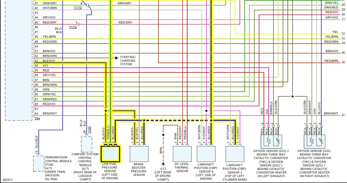

These diagrams are for checking the fuel system before checking the high pressure system. Ill post the high pressure testing next. Both pressure sensors work on a 5volt reference.

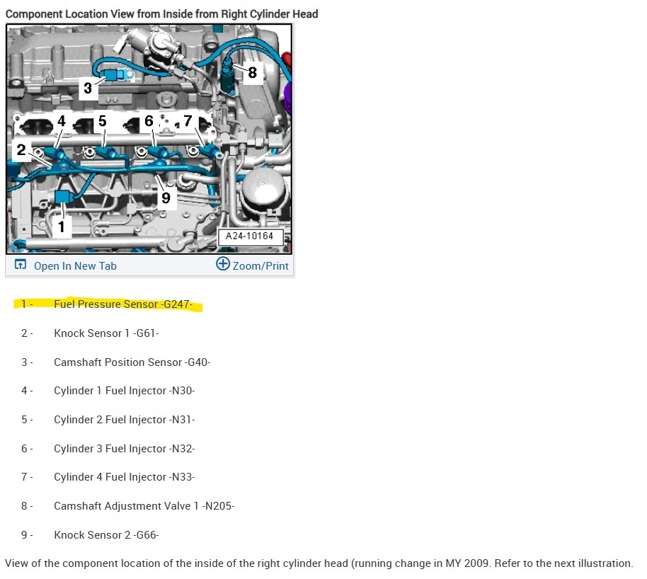

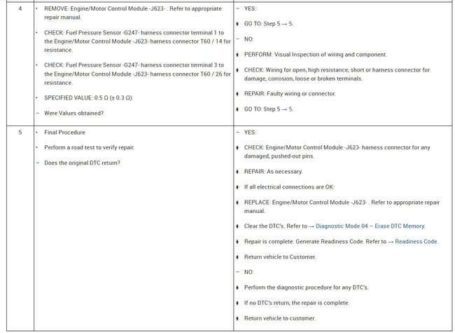

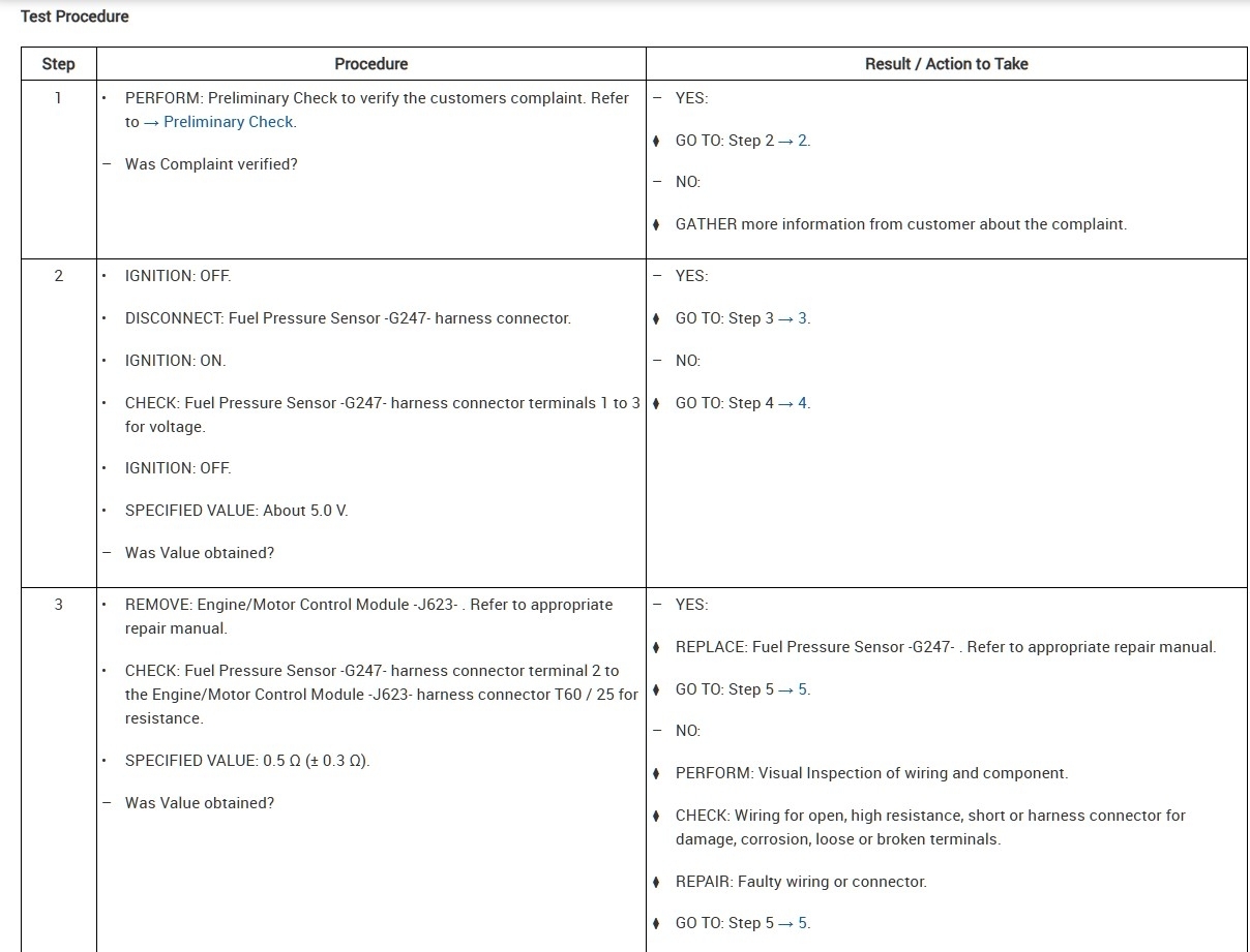

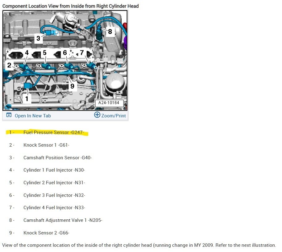

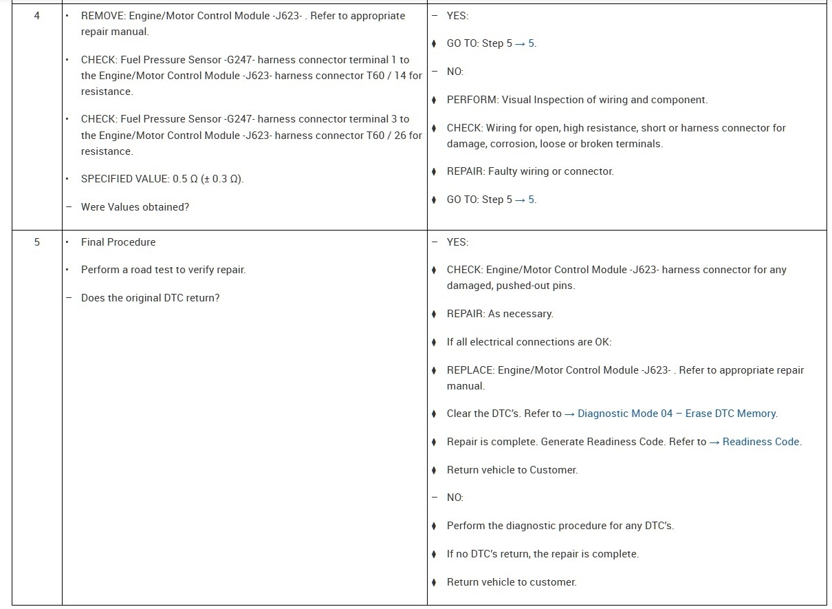

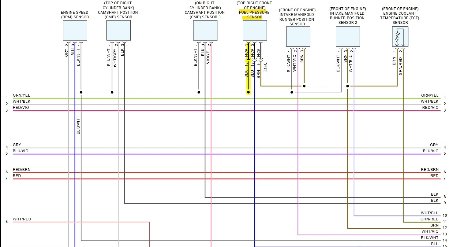

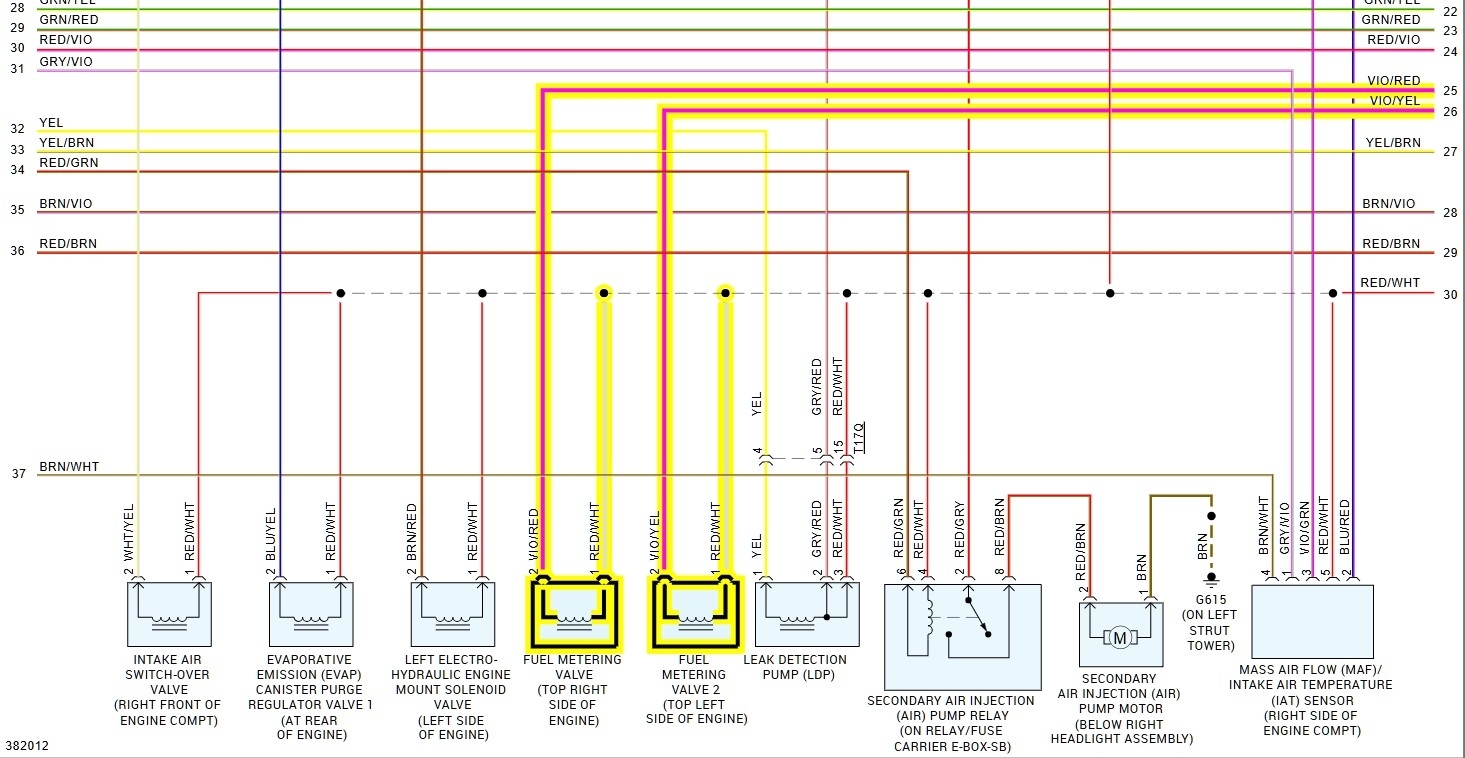

This is the service info for checking the high pressure fuel sensor. You may want to try a different scan tool as well, and see if the code numbers change. Just curious if theres any difference. You use Autel scan tools correct?

Get into both Fuel Rail Pressure sensor's signal wire(s) Or Data PIDs) and the Low (Fuel)Pressure Sensor, watch both of them when youre getting close to 20min and see if the signal spikes or drops out. They dont have the sensors labelled to good here, so I go by the sensors location Ill see on the fuel rail and then check by wire colors.

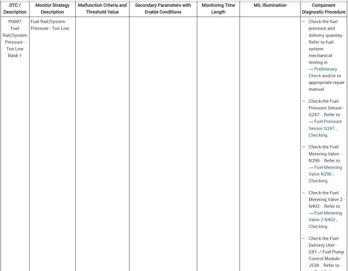

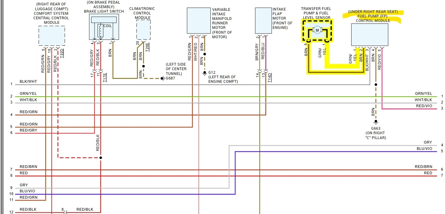

Well apparently a 00135 is a "Fuel/Rail System Pressure: Too Low". A P0087 can also set with it, another low pressure code. So concentrate on the fuel system pressure, start with checking the low side pressure stays good, theres a fuel pump control module for the low side if this info is correct.
