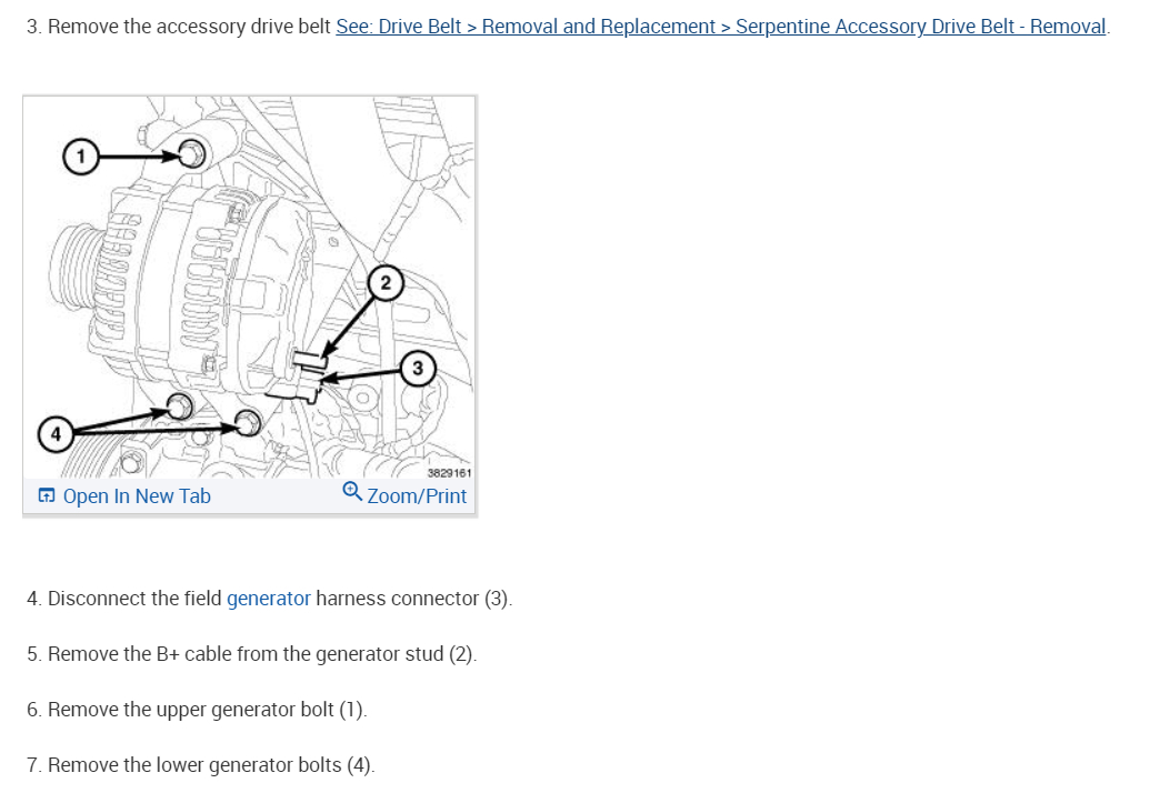

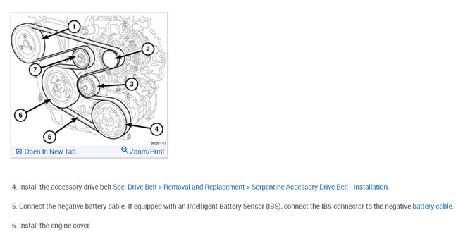

I would run the codes to see if any are stored, please go over this guide:

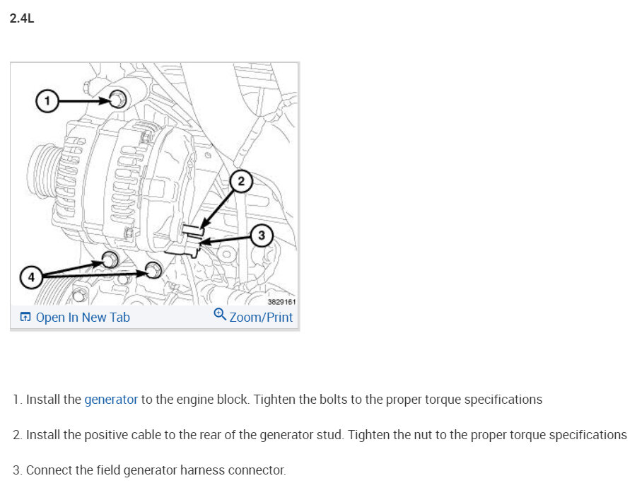

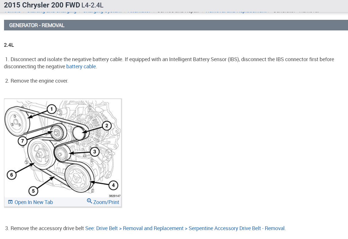

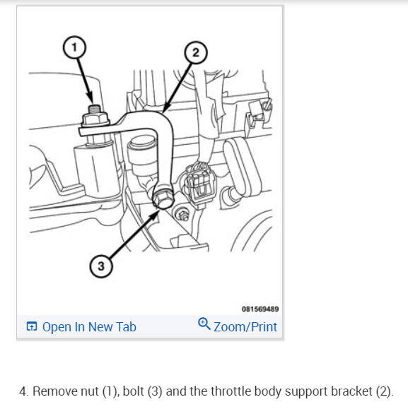

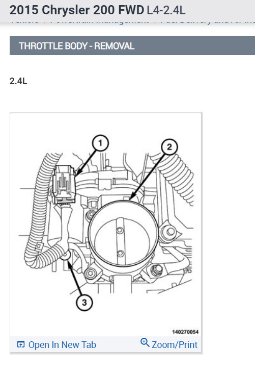

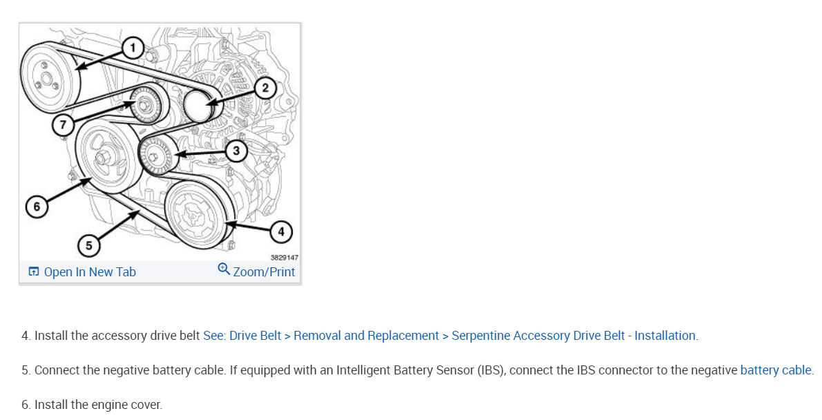

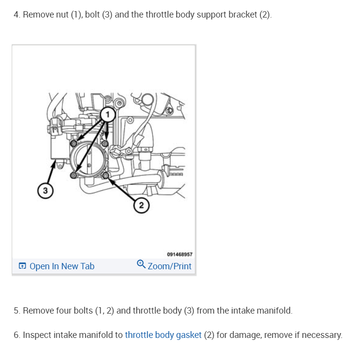

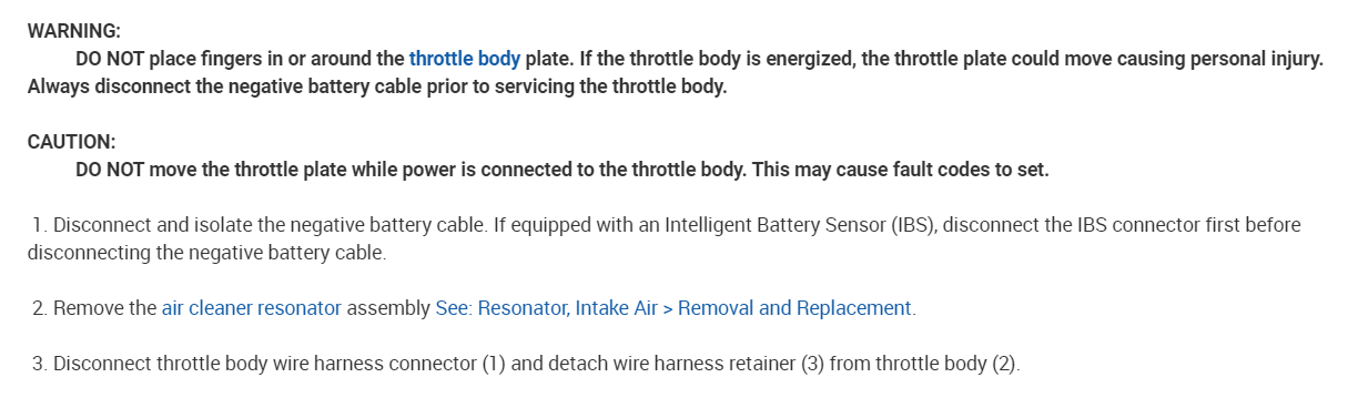

I don't see any programming that needs to be done when replacing the alternator. Here are the instructions on how the job is done correctly so your dad could go over it to see if he missed anything. The only other thing I can think of if there are no codes is to service the throttle body. This guide can help, and I have included instructions for our car as well.
