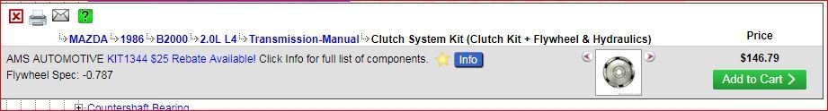

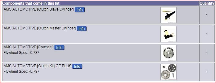

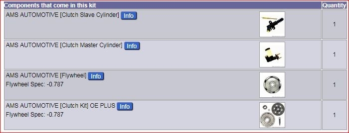

Looks like you can get the parts for a complete clutch replacement, clutch, flywheel, slave cylinder, master cylinder for $147.00. This is from an online source so I am sure the prices will vary a little but should not be much more than this for the complete system. As for the labor, it shouldn't be more than a couple hours to do it so that depends on the facilities door rate. If you take that and multiply by two plus the parts you should be pretty close.
Just the master cylinder I found on the same site for $10.00 to $30.00.
