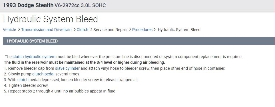

Hi, I'm Dan.
There is a chance that there was air in the clutch hydraulic system. Try bleeding the system to see if that helps. I've attached the procedure for that.
