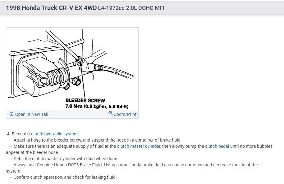

I'm questioning if there is an internal issue with the release fork. Do me a favor. Read through the directions below related to bleeding the system and let me know if you may have missed anything.
Also, check to make sure the slave is moving and properly engaged with the release fork.
See pic below.
