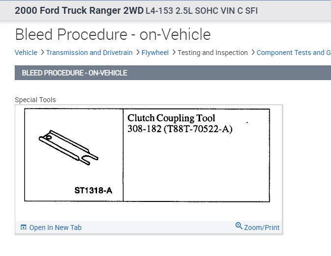

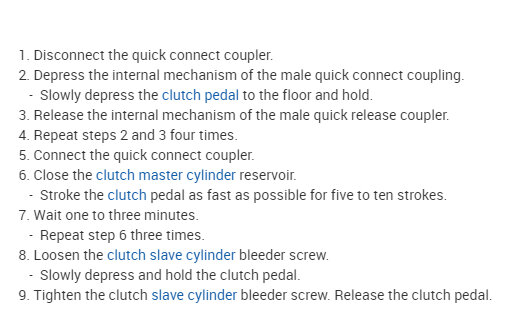

You don't need to add fluid prior to installation. The slave cylinder is bleed basically the same way as the brake system. When bleeding, the air is removed and replaced with fluid from the clutch master cylinder.
I attached the directions below for bleeding the clutch hydraulics. Let me know if this helps.
See pics below.
