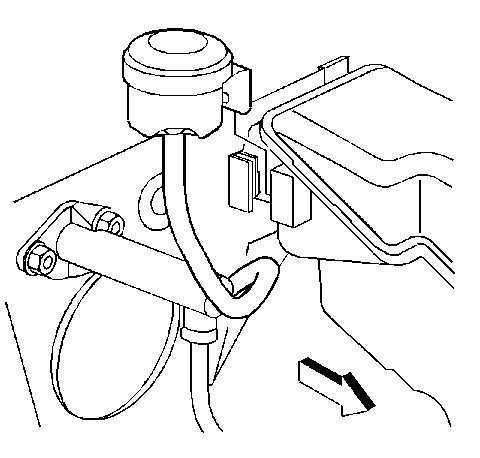

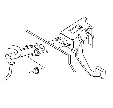

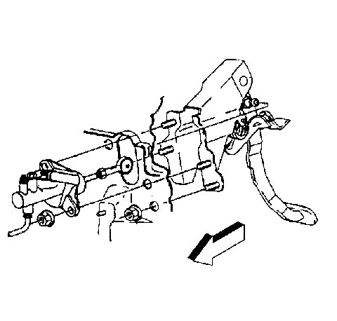

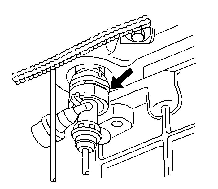

Here are the directions for replacing the master cylinder. The attached pics correlate with the directions.

1. Remove the clutch master cylinder pushrod from the clutch pedal.
pic 1
2. Remove the master cylinder retaining nuts at the front of the dash.
pic 2
3. Remove the remote reservoir.
pic 3
4. Disconnect the clutch actuator cylinder line.
pic 4
