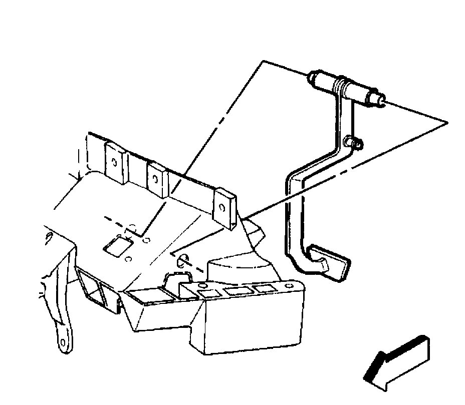

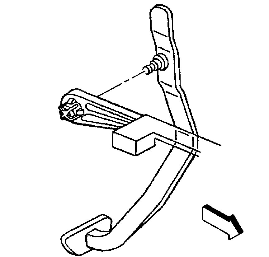

Here are the directions for removal and replacement of the clutch pedal. However, I'm not sure what bushing you are referring to. Take a look through these directions and the attached pics and let me know if you see the bushings you are referring to or where they are located. The only thing I can think of are support tabs that are on the mount that may be broken or bent.
________________________________
1999 Chevy Truck S10/T10 P/U 2WD L4-2.2L VIN 4
Clutch Pedal Replacement
Vehicle Transmission and Drivetrain Clutch Clutch Pedal Assembly Service and Repair Procedures Clutch Pedal Replacement
CLUTCH PEDAL REPLACEMENT
Removal Procedure
pic 1
1. Remove the master cylinder rod from the clutch pedal.
pic 2
2. Remove the clutch pedal from the support by depressing the side tabs.
Installation Procedure
pic 3
1. Position the clutch pedal into the support.
pic 4
2. Secure the master cylinder rod to the clutch pedal.

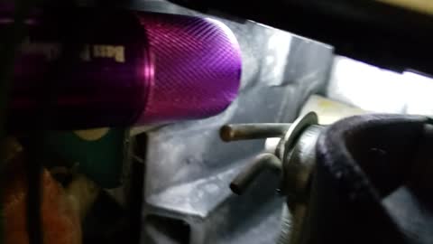

I will take some pictures of what I am talking about. Hopefully this will give you an idea what I am talking about. I will send this soon. Thank you.
Jan 11, 2020 at 8:31 AM
Sounds like a plan. I will watch for your reply.
Jan 11, 2020 at 7:32 PM
RHW
I am sending video of my problem. You have received help from me on this. I am not able to send video to you email address. So I will try this.
