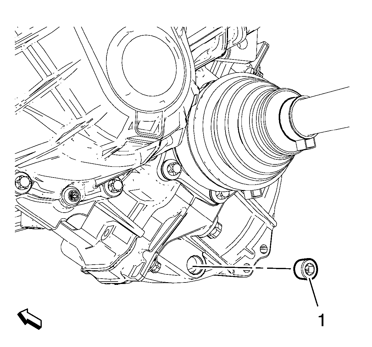

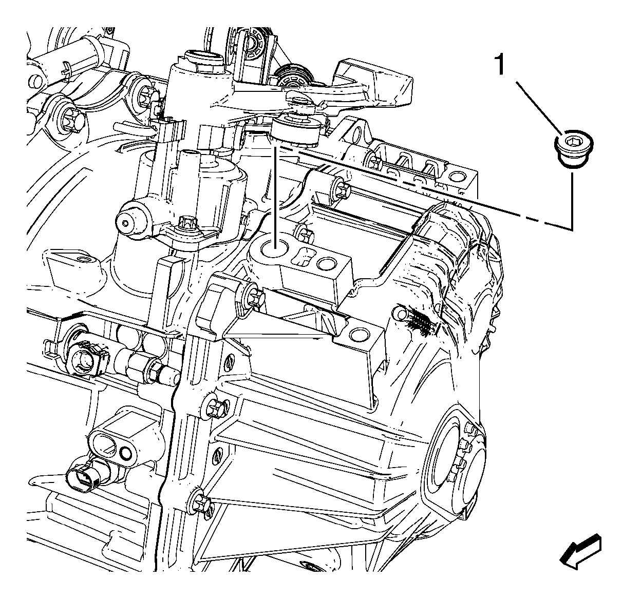

Has the transmission fluid level been checked? Also, has it ever been serviced? If that has never been done, that is where I would start. Here are the directions for servicing this transmission. The fluid type and capacity will be at the end. Also, the two attached pictures correlate with these directions.
______________________________
Transmission Fluid Level Inspection
Removal Procedure
Note: The fluid plug at the front of transmission may not be opened.
1. Raise and support the vehicle. Refer to Lifting and Jacking the Vehicle See: Vehicle Lifting > Procedures > Lifting and Jacking the Vehicle.
2. Place basin underneath the vehicle.
3. Clean away all dirt and debris from the transmission fluid drain plug area.
Fluid Drain Plug (1)
pic 1
4. Remove and DISCARD the transmission fluid drain plug (1).
5. Let the transmission fluid run out for 10 minutes.

5. Remove the battery tray. Refer to Battery Tray Replacement See: Battery Tray > Removal and Replacement > Battery Tray Replacement.
6. Clean away all dirt and debris from the transmission fluid plug area.
Fluid Fill Plug (1)
pic 2
7. Remove and DISCARD the transmission fluid fill plug (1).
8. Add transmission fluid. For transmission fluid capacity and specifications refer to Manual Transmission Specifications See: Manual Transmission/Transaxle > Mechanical > Manual Transmission Specifications.
9. Install a NEW transmission fluid fill plug and tighten to 30 Nm (22 lb ft).
10. Install the battery tray. Refer to Battery Tray Replacement See: Battery Tray > Removal and Replacement > Battery Tray Replacement.
