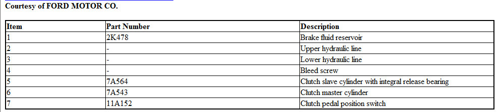

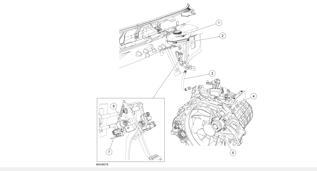

it seems clutch master cylinder and slave cylinder are going bad.
Run our guide.:
https://www.2carpros.com/articles/clutch-doesnt-work-sometimes-or-not-at-all
check picture 1 and 2 for clutch system components location.for the slave cylinder replacement manual gearbox must be removed because the part is integrated inside it.
