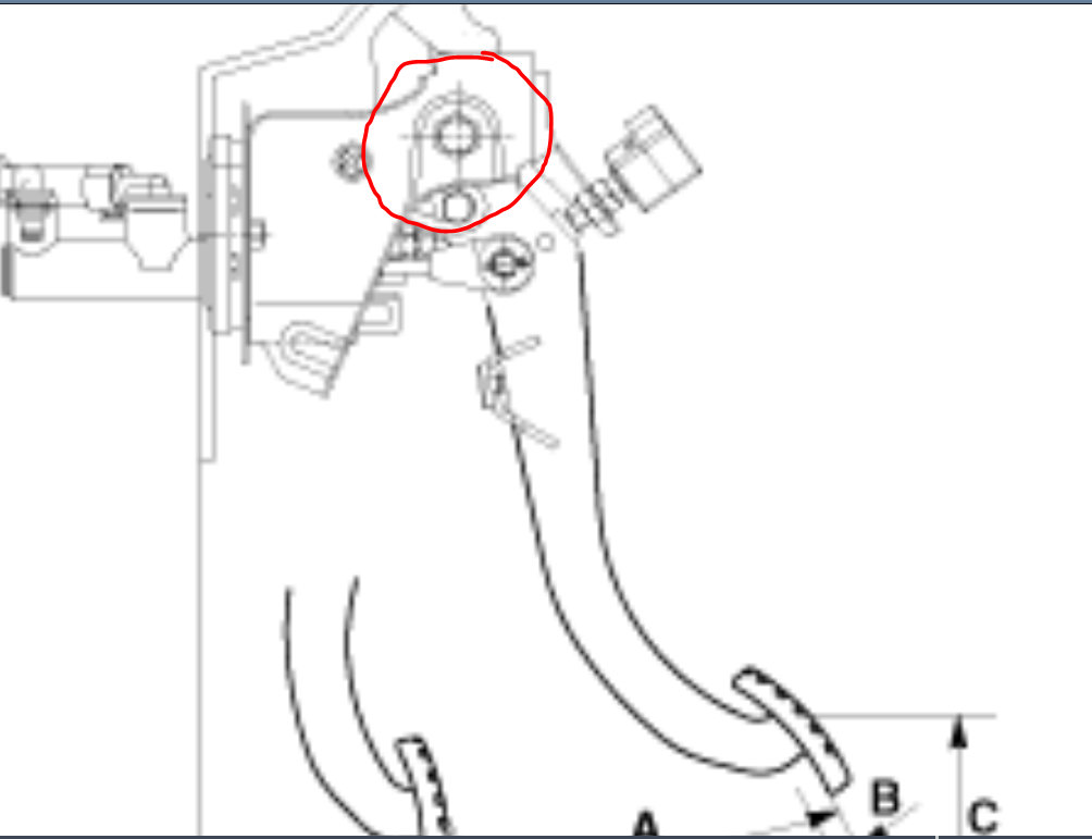

They most likely sprayed where the pedal mounts at the top. It is basically a hinge. See the attached pic. Try spraying it in the area of the circle. Also, they should be able to replace the bushing. Isn't the vehicle still under manufacturer's warranty?
Let me know if I can help.
