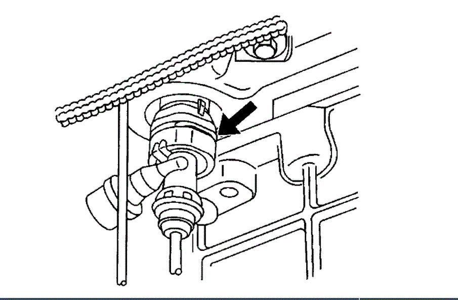

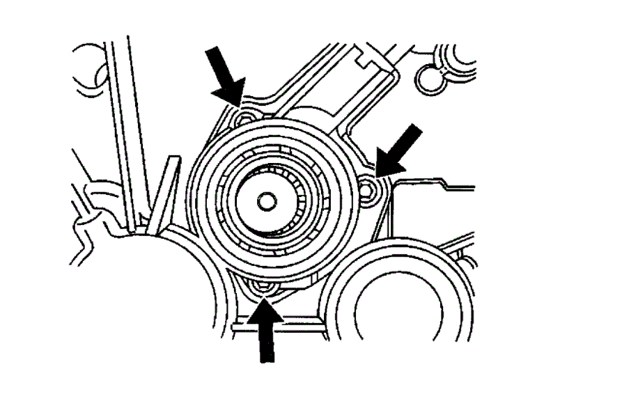

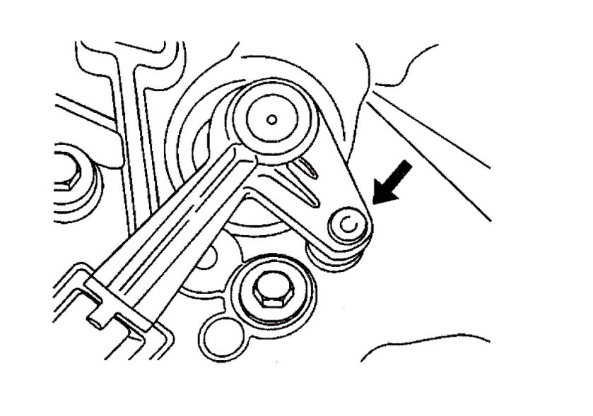

Removal Procedure
1. Disconnect the clutch actuator cylinder line.
2. Remove the transmission.
3. Remove the clutch actuator cylinder bolts from the transmission.
4. Remove the following components from the transmission:
The upper bolt
The clutch actuator cylinder
