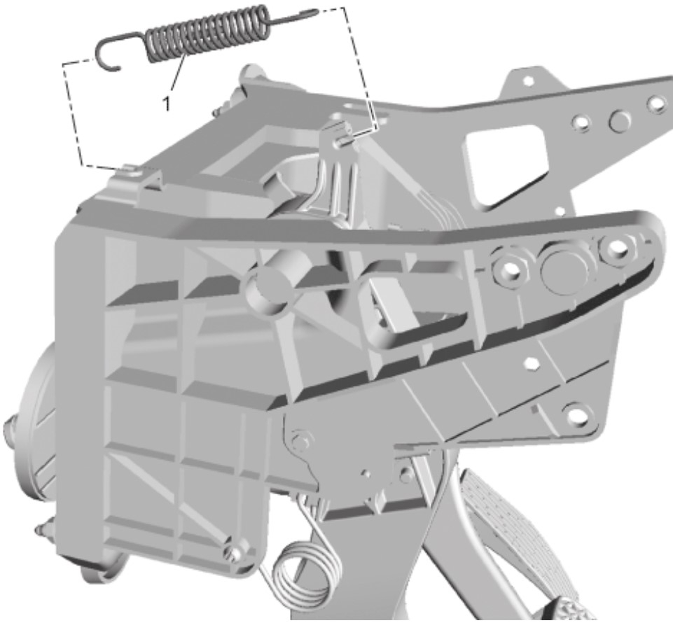

Being that is a hydraulic system I would first look at the clutch pedal pivot and maybe apply some dry lube to it to be sure it isn't hanging up, next I would look at the return spring that is on top of the pedal assembly, they can break and then it only has the clutch fluid to push it up. I suspect it's a broken spring. However if not then it becomes either the master or slave cylinders or clutch wear. Those are mostly a replace it to fix it item.
