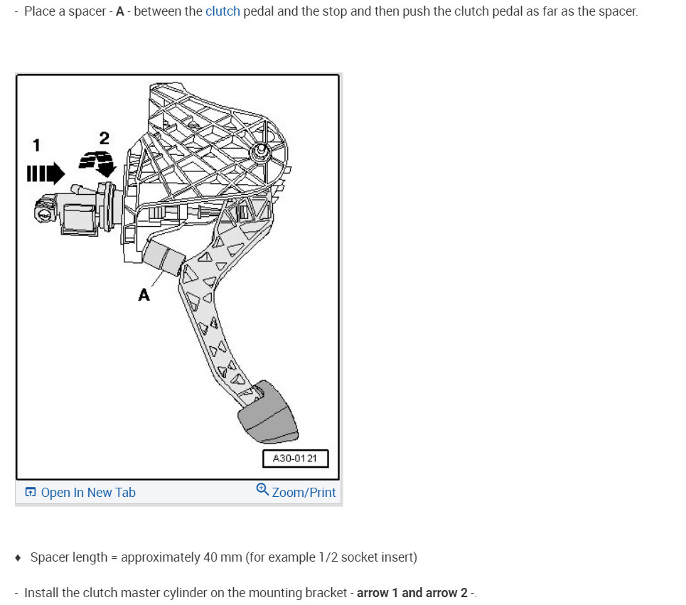

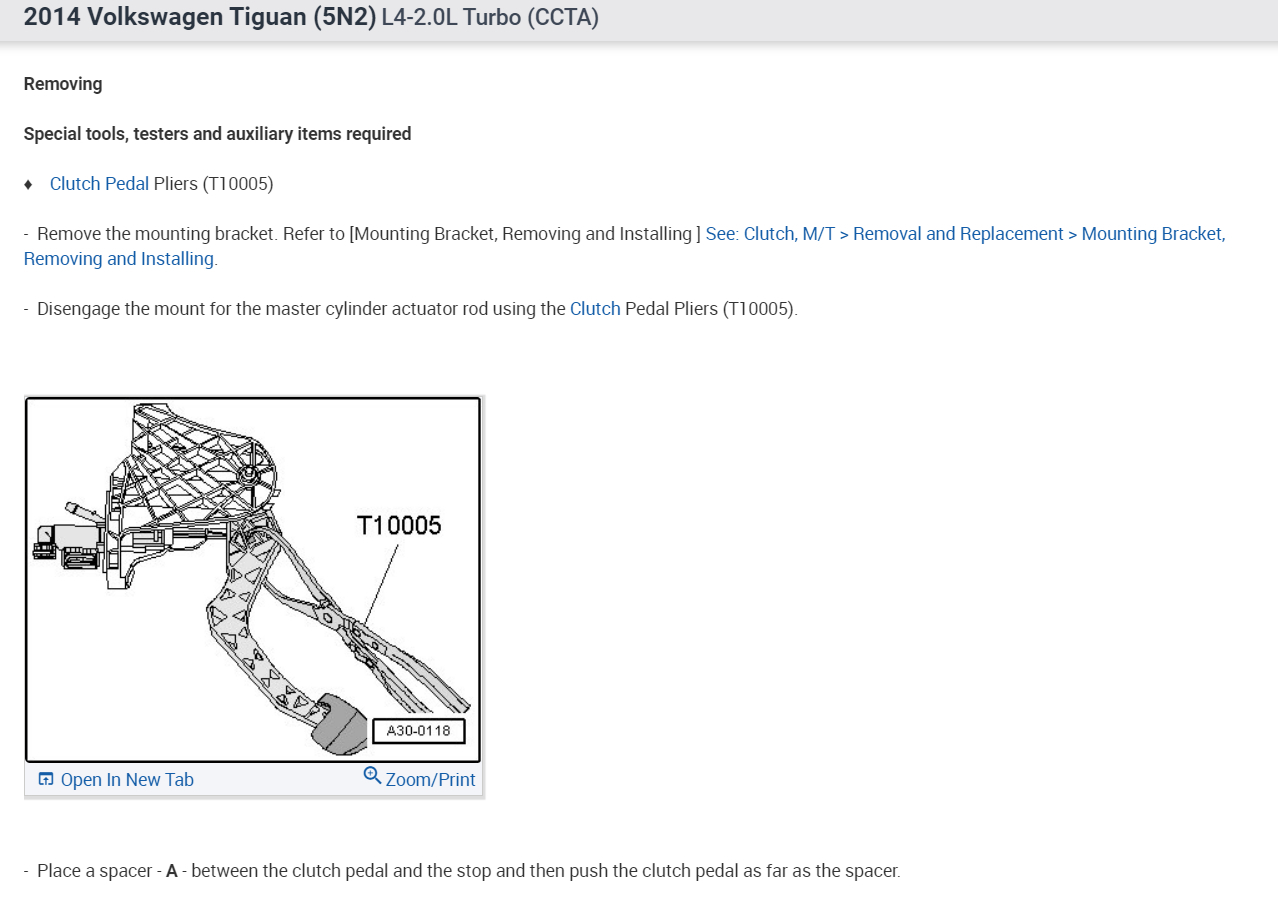

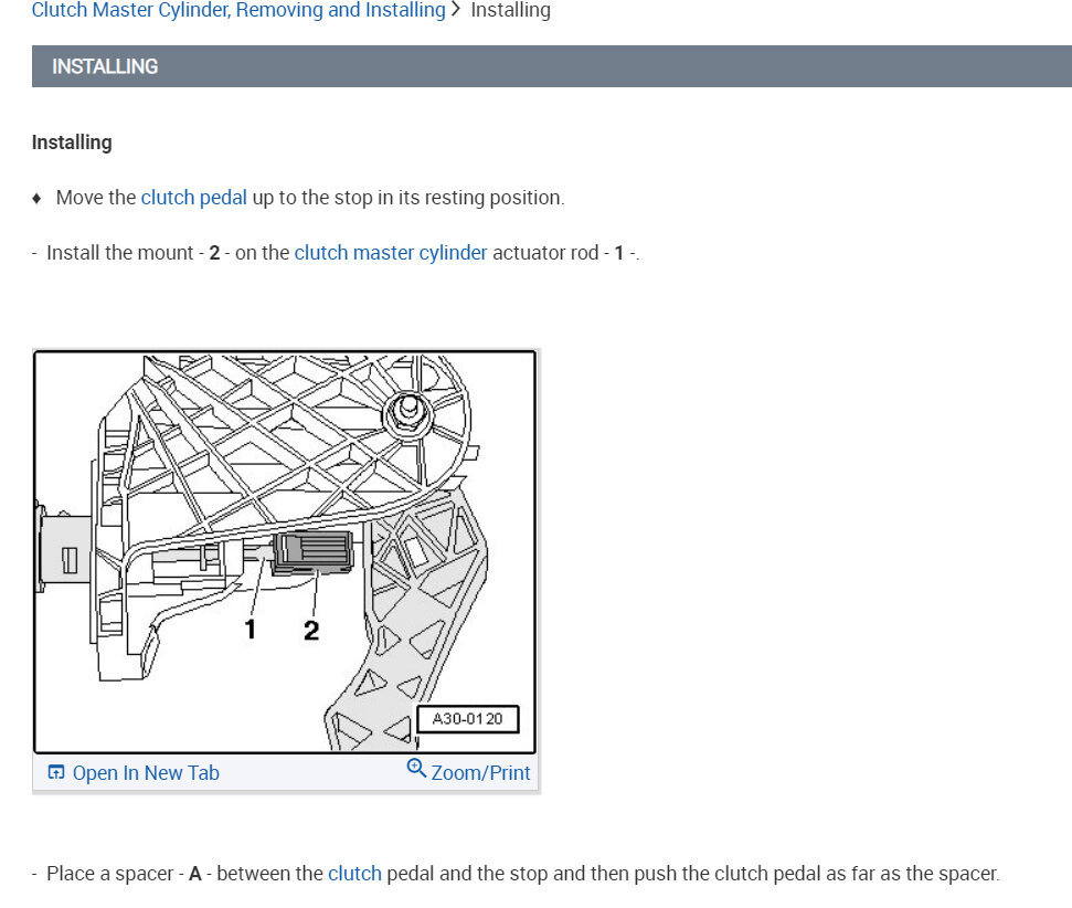

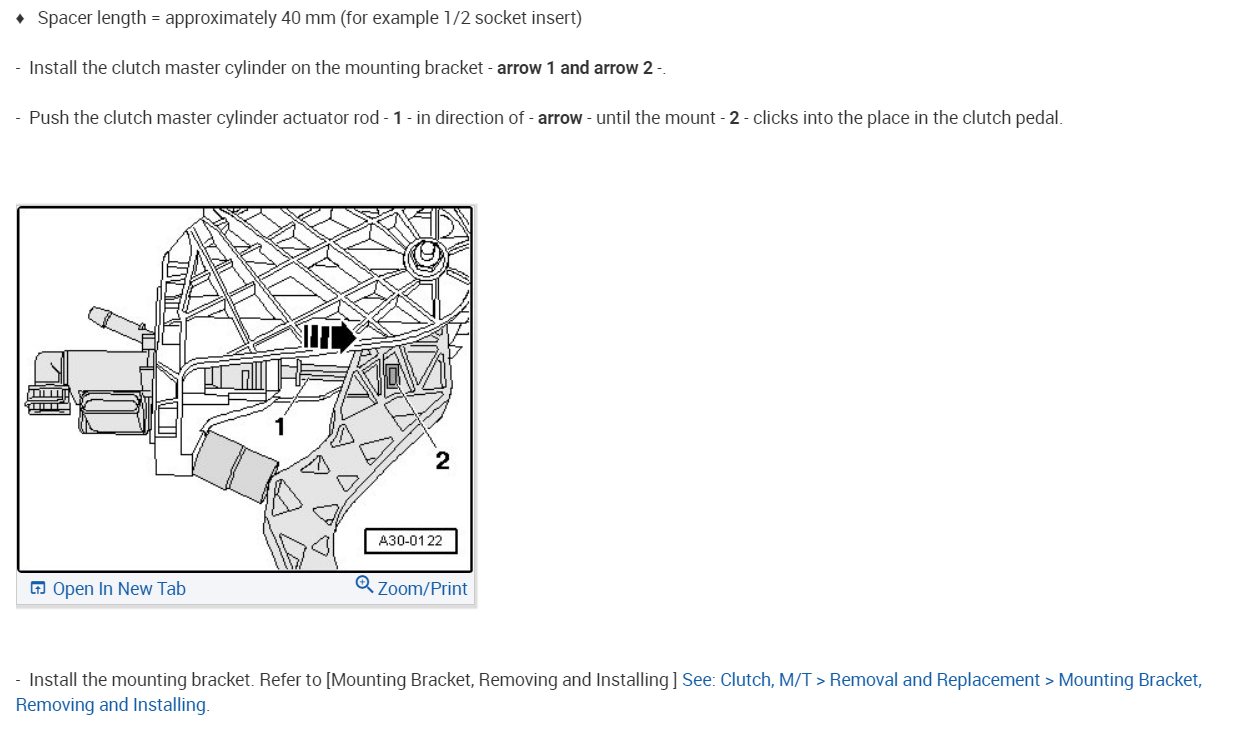

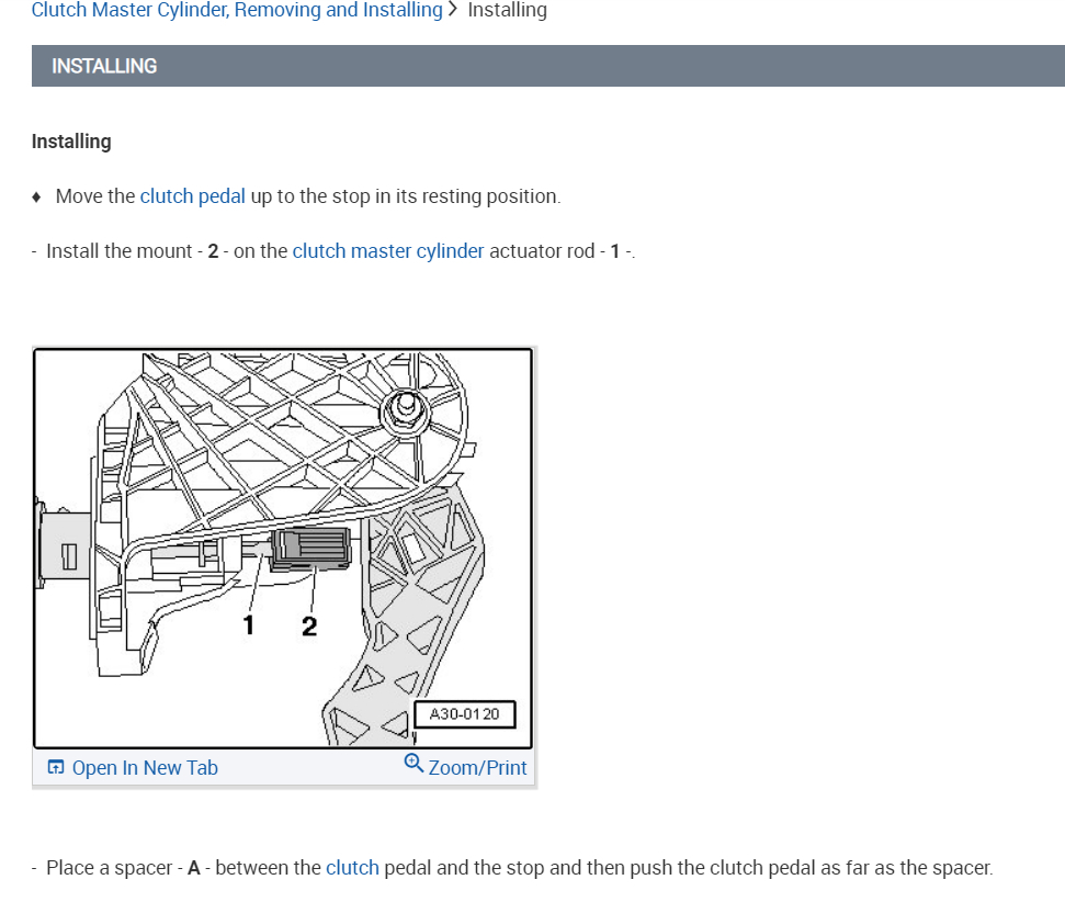

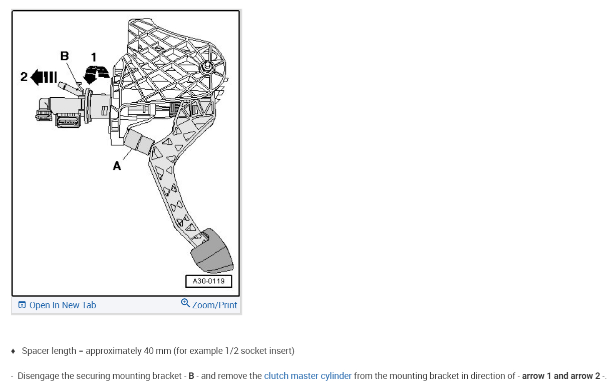

Yep, this happens when the clutch master needs to be replaced.
here is a guide to help and how the replace the part in the images below:
https://www.2carpros.com/articles/clutch-doesnt-work-sometimes-or-not-at-all
Check out the images (below). Please let us know if you need anything else to get the problem fixed.
